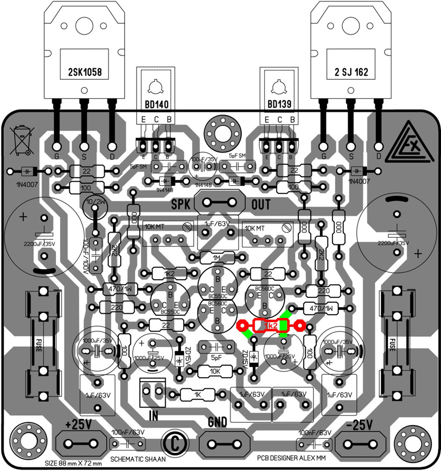

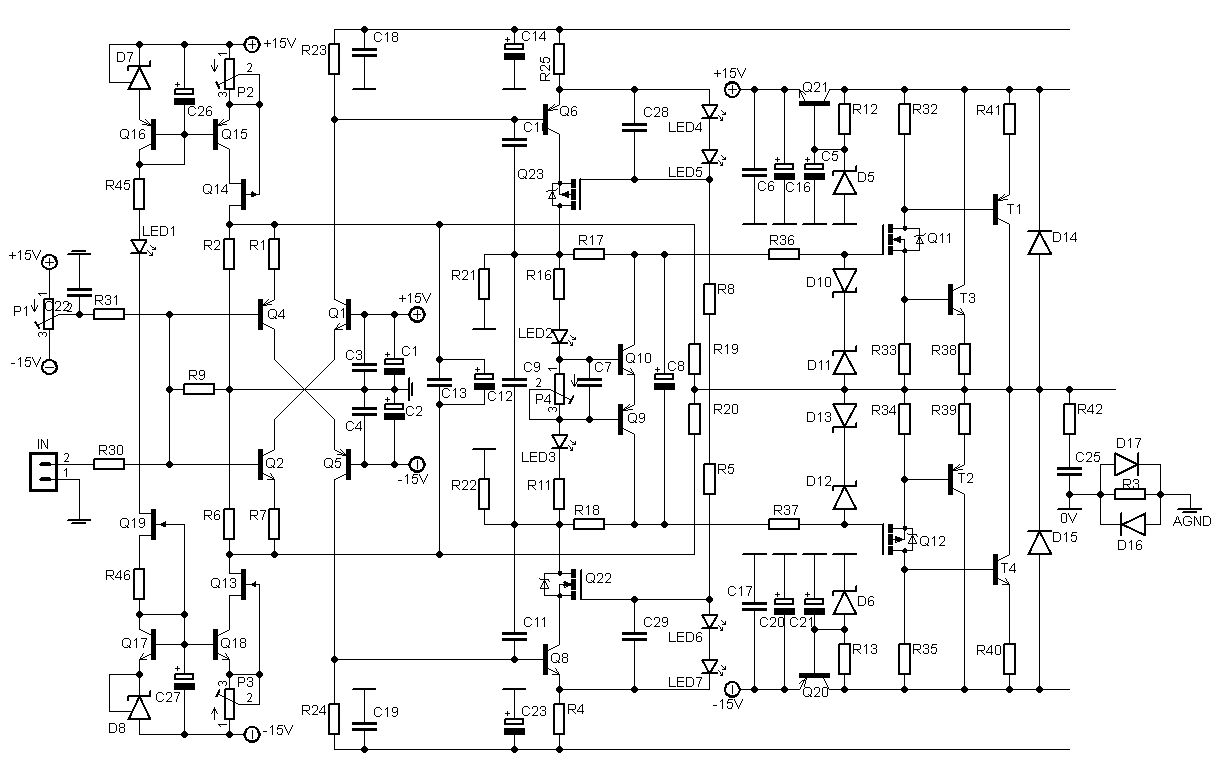

Hi every body!
Is my schema correct?

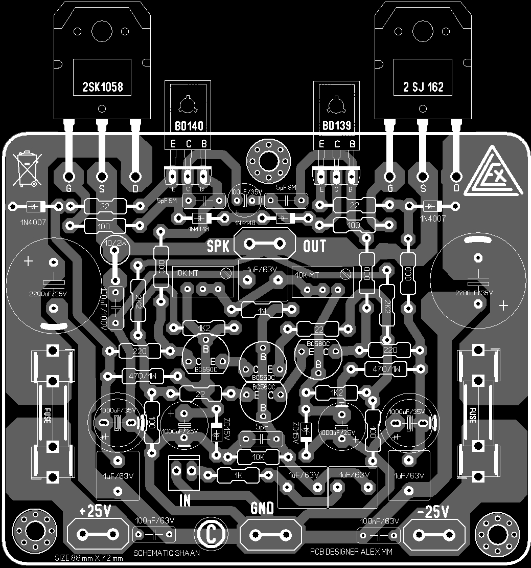

  • PCB SILK TOP VIEW.pdf
  • PCB B&W TOP VIEW.pdf
  • PCB SILK TOP MIRROR.pdf
  • PCB B&W BOTTOM VIEW.pdf
  • PCB B&W TOP VIEW DUAL.pdf
  • PCB ALL TOP.pdf

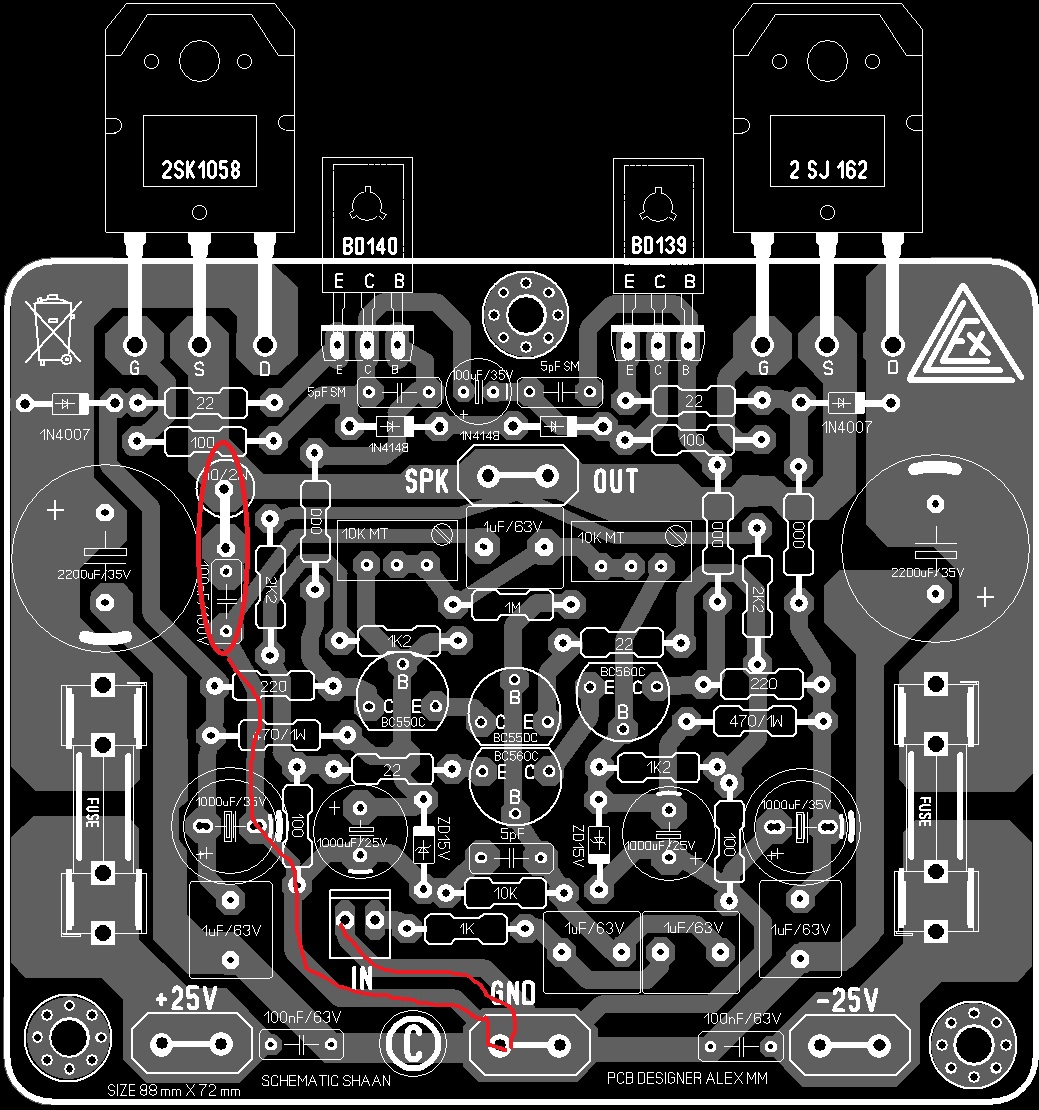

Alex,
I would like to note a weekness in ground scheme in your PCB drawing.
The input ground should be seperated from the zobel and both should go independently to the main power supply capacitors null point.
otherwize there is a good chance of positive feedback and oscilation from voltage drop on ground line that goes from PCB to main capacitor bank.
