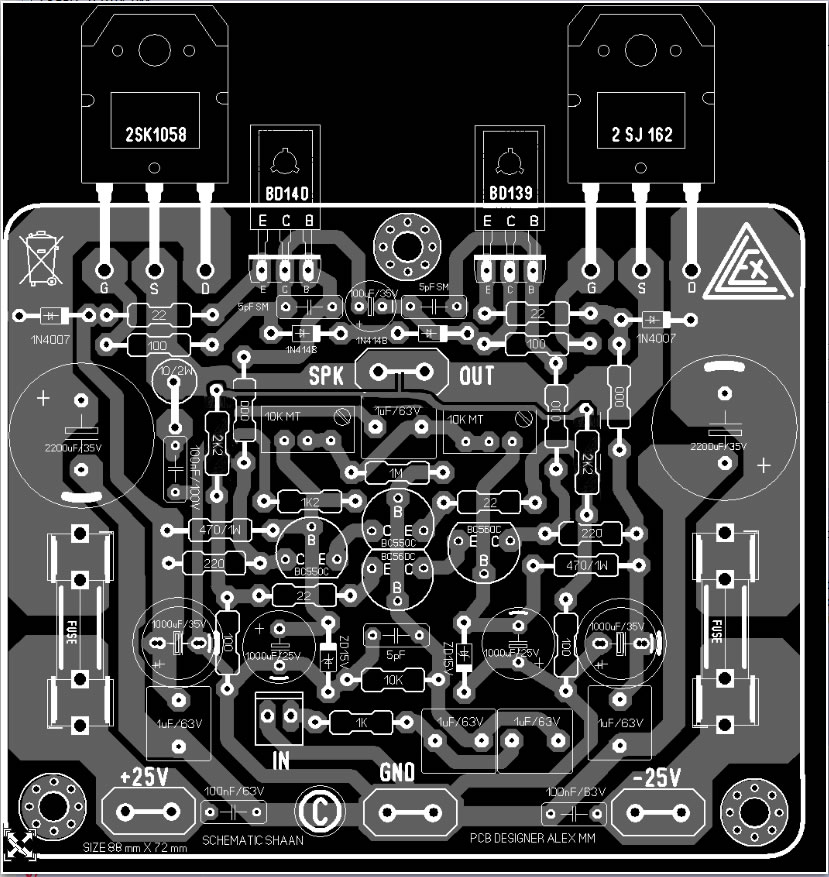

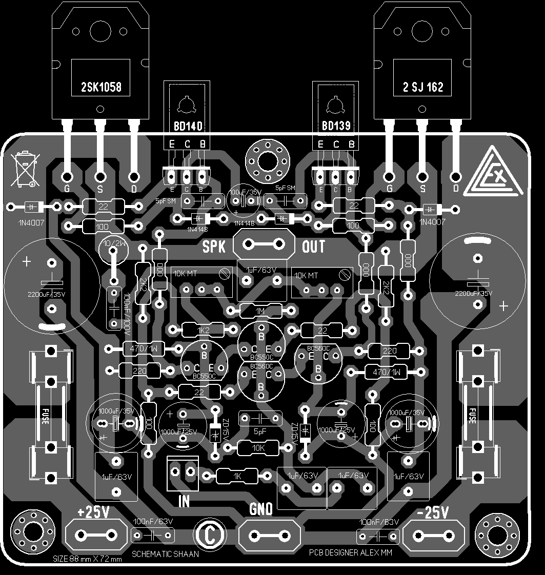

waiting sir Alex_mm making PCB layout from shaan's SSA schematic....
..... PCB for Shaan's schematic was done this weekend as naf asked
Regards Alex.
Nice one, Alex. Just a tip, if you bring CR ti the 2K2 by a separate little track right from the Speaker common point, you will really decrease distortion...... PCB for Shaan's schematic was done this weekend as naf asked
Regards Alex.
Image just to make-it clear
As always your capabilities are of the highest caliber! Nice Alex..... PCB for Shaan's schematic was done this weekend as naf asked
