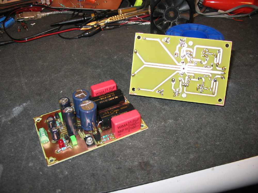

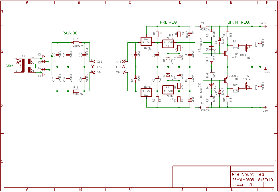

Hi Gents,
The last time i'm playing with different regulators for my UGS-line amp(see UGS-thread on Pass Labs). I was very supprised last week when i reed the review in audioxpress about those shunt regs.
In fact i use the same simple shunt reg which was also a publication in AX a few years ago. Norman Taggard(i hope the name is correct) was the author.
I''m very satisfied about that circuit but replacing the shunt resistor(56R in my case) for the Borbely current source made no difference for me.
I.M.H.O. the power supply rejection of the used preamp makes the difference but the author of the shunt article gave not much information about the used setup and It's all written with a huge pro borbely cab.
As i said, i'm fooling around with different(shunt) regulator configurations but everytime that last cap is the bottleneck.
Yes, the panasonics FC-series are also very good for me. When i swap it for an elna audio grade i become depressive. But in fact we are talking about colouration.
How to solve that?
Nice work on your ckt! I found it somewhat similar to Peufeu's CCS/shunt PS. The AudioXpress author found the use of pre-reg 317 limiting (music more compressed), but maybe your design does not behave that way.
I, too, found that AudioXpress article confusing in certain regards (maybe it's the author, but the chief editor should've done a better job, too). Some main points of confusion regard component suggestions and labeling, notably transistors:
In the schematic below, what is:
- the FET transistor above the 221R (and what's its negative version)? (See below)
- the optimal negative version of BC549C and BC559C in the positions they are placed in the schematic? Are they indeed BC559C and BC459C, respectively?
The negative (-) version of a regulator -- sometimes, for better performance -- may not use the complimentary opposite transistor and/or topology. And, in any case, model numbers (nomenclature) for negative/positive pairs may not be so apparent; E.g. for output transistors … Positive N-channel Toshiba 2SK1530 compl. to Negative p-channel Toshiba 2SJ201. For shunts, author notes use either same as output OR Positive P-channel IRFP9140 and Negative N-channel IRFP150.
Hi Hollowman,
The use of a pre-reg before the normal LM317/337 circuit isn't my own idee. Walt Jung and ALW did this before. I haven't the feeling that there is any compression. I can very easy make an A/B check and i didn't hear any difference but i found out that the last reg(the shunt reg) is very dominant. When i start to test the circuit i had some oscillation trouble but C2/C7 solved the problem.
The schematics in AudioXpress are correct but i used some screab.
IRF610/9610 and bc550/bc560.
So above the 221R a p channel fet (9610) and for the negative version mirror the circuit or look at the super shunt regulator circuit.
Bc459 huh ??? 549 i suppose.
In summary;positive supply, P-channel mosfet+pnp in CCS and P-channel mosfet in shunt. Negative supply N-channel mosfet+npn in CCS and N-channel mosfet in shunt.
Gr.
Johan

Hi Hollowman,
BC550/560 are "lower"noise than the BC549/559 but i think it doesn't matter which one you use in this application.
For the shuntpart of the schematics you need a driver for the mosfet. Please look careful at the schematic in post 6!!!
If you like you can change R4/R8(56R) for the Borbely or Zenmod current source. For me it didn't made any difference but for you???

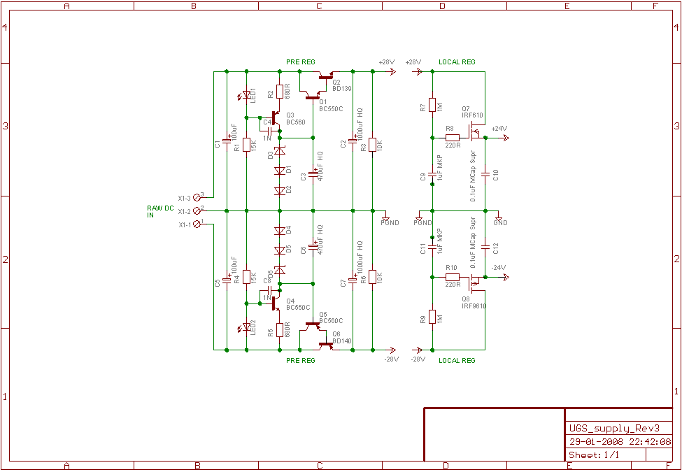

serie reg.
Hello again,
Attached the schematic of the regulator i'm testing/listening to.
You must try different zener/diode combinations to get the output voltage you need. Please also test it with the current you need because there is no feedback and the voltage get's a bit lower when the current raise.
The mostfetfolower is a la Charles Hansen's Ayre V3 if i'm right.
Personally i like Mundorf Suprime cap's but they are not cheap and small. The northcreek cap's are new for me. The price is better than the Mundorfs. For sure when the dollar is low and the euro high. But shipping cost...
I do not prefer any particular brand/type of Zener. When i buy some in the shop at the corner it's always a supprise what you get.

zeners as references are pretty noisy. Their Vn can be as high as 2µV/1/2Hz, where even the 1M-Resistor shown has 128 nV!
It is however not so easy to use low noise references since they are normally low voltage. I use bypassed resistor stabliized with a FET CCS, but it is not easy to fix the voltage.
Any idea to circumvent this is welcome, and, at least for high gain circuits, pretty much a must.
I don't see how the proposed local regulator could work. Does it depent on leakage current?
