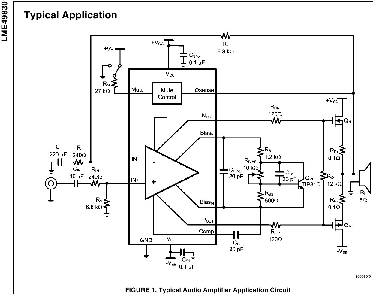

How much power do you want that sub amp to put out? My guess would be 80W, and such things are not so easy to do simple.
One way to keep a power amp simple is to use the LME49830. It does hide some of the functionality, but the circuit is simple enough to wire point to point. Not sure if this method of construction is a good idea, haven't tried it myself. The datasheet for the LME49830 has a PCB layout.
Even simpler is to use the LME49810/LME49811 with Thermaltrak transistors - therefore no Vbe multiplier needed. The easiest way to do that is to get one of these kits. Very serendipitously, it puts out 80W.
