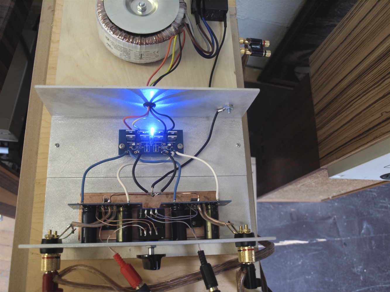

I've already got the amp kicking in a test assembly. Clean and quiet, It seems I got that part right. I also have a pair of 8" 2-ways built up in test boxes. I'm very happy with the sound of the two together but am still planning on experimenting on the GC. I want to build everything in test enclosures first to see how they all interact. So maybe the separate PSU test enclosure would be the right path. Or, since I'm not sure if I'll be sticking with the B1 or even the Phono pre { not sure how it will sound, it was a $25 kit} I should build all the circuits, Use wall warts as recommended to power the B1 and phono and get a recycled +12/-12 computer PSU for a couple bucks to power the opamp circuit? All for test purpose. Then I'd have everything I want to include working and I can make my decisions about how I want them to work together.
THAT'S IT! For now all test enclosures with test PSU's.

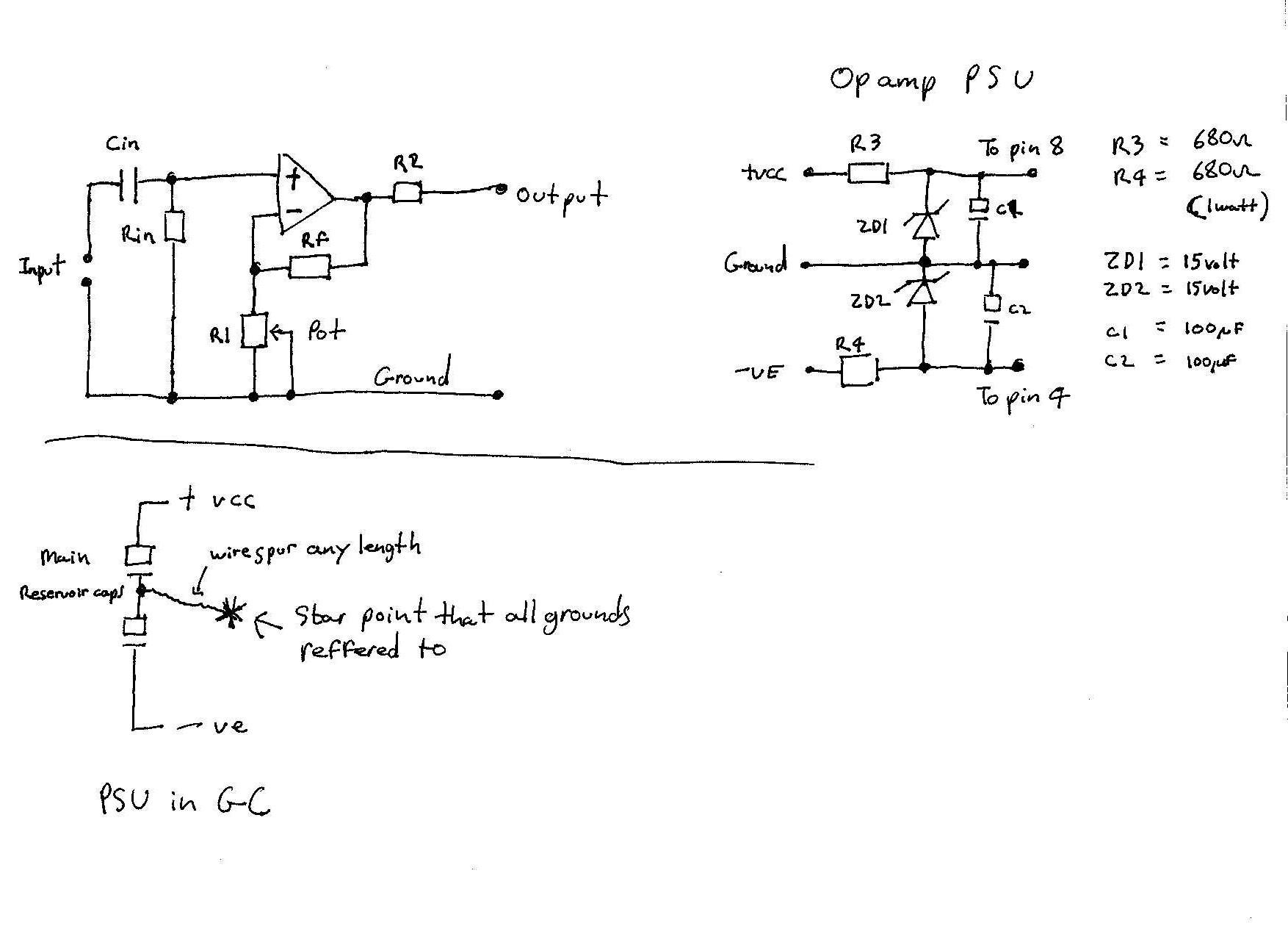

Something like this then,
First grab a copy of the data sheet for the 2604 which I have posted at the bottom.
Any opamps you order, make sure you get the DIP (not surface mount) version which is the OPA2604AP.
Circuit is straightfoward.
PSU first... the opamps takes so little current that a simple PSU is all that is required.
So the input to the PSU consists of three connections that go to the main PSU in the GC.
Do you see how the star earth is a small offshoot from the connection between the main caps. That's because large currents (100/120hz) flow as the caps are continually charged.
Taking the ground away from there eliminates this.
Don't underestimate that issue... it's a very real problem. Always use the offshoot to a make a "clean" ground point.
The opamp PSU is a simple zener stabilised supply. ZD1 and 2 can be anywhere from 12 to 18 volts for most opamps, giving a -/+ 24 to 36 volt split supply.
The opamp has two power pins, pin 8 is positive, pin 4 is negative. The rails don't have to be exactly equal... it wouldn't matter if one were +12 and the other -20.
The caps C1 and C2 are small decouplers, value not critical. You can usefully add a 0.1uf polystyrene cap directly across each zener to cut noise if you want.
The opamp... look at the data sheet... see the two amps and the pinouts within the package.
Cin... I would choose around 0.47uf poly cap and use a value of 470k for Rin. Rin sets the input impedance. If it's lower, Cin needs to be larger to prevent loss of low frequencies as Cin and Rin form a high pass filter.
If you really want the theory behind one resistor and one cap,
RC circuit - Wikipedia, the free encyclopedia
Rf and the pot. I have kept the pot in the "earthy" end of the circuit to minimize stray pickup (using a pot isn't ideal... you are much better initially using one, then fitting fixed resistors... but up to you )
Values... Rf 22k and 10k or 22k for the pot.
R2 is to ensure total stability if driving capacitive load (cable)... it normally isn't needed.
If you fit it use 68 ohm and fit as close to the IC as possible.
Why no output cap... because it's a FET opamp and the offset will be very low.
Absolutely............Do you see how the star earth is a small offshoot from the connection between the main caps. That's because large currents (100/120hz) flow as the caps are continually charged.
It seems like I have been preaching this for years and still I see builders proposing otherwise and advisors still telling beginners to locate the main Audio star Ground between the smoothing caps. AAgh.
