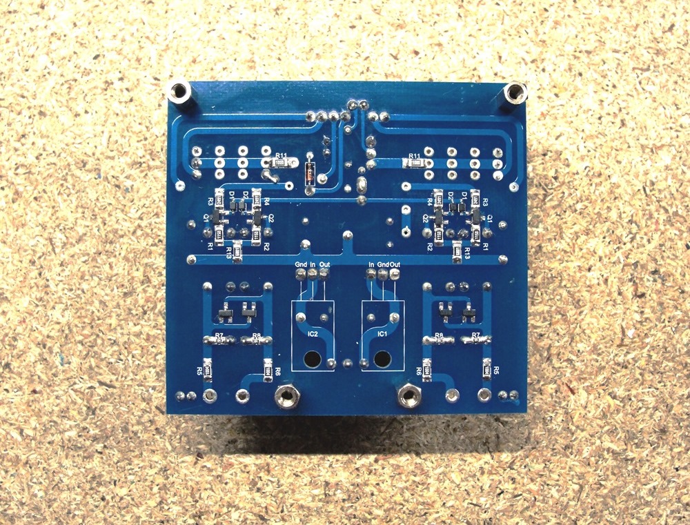

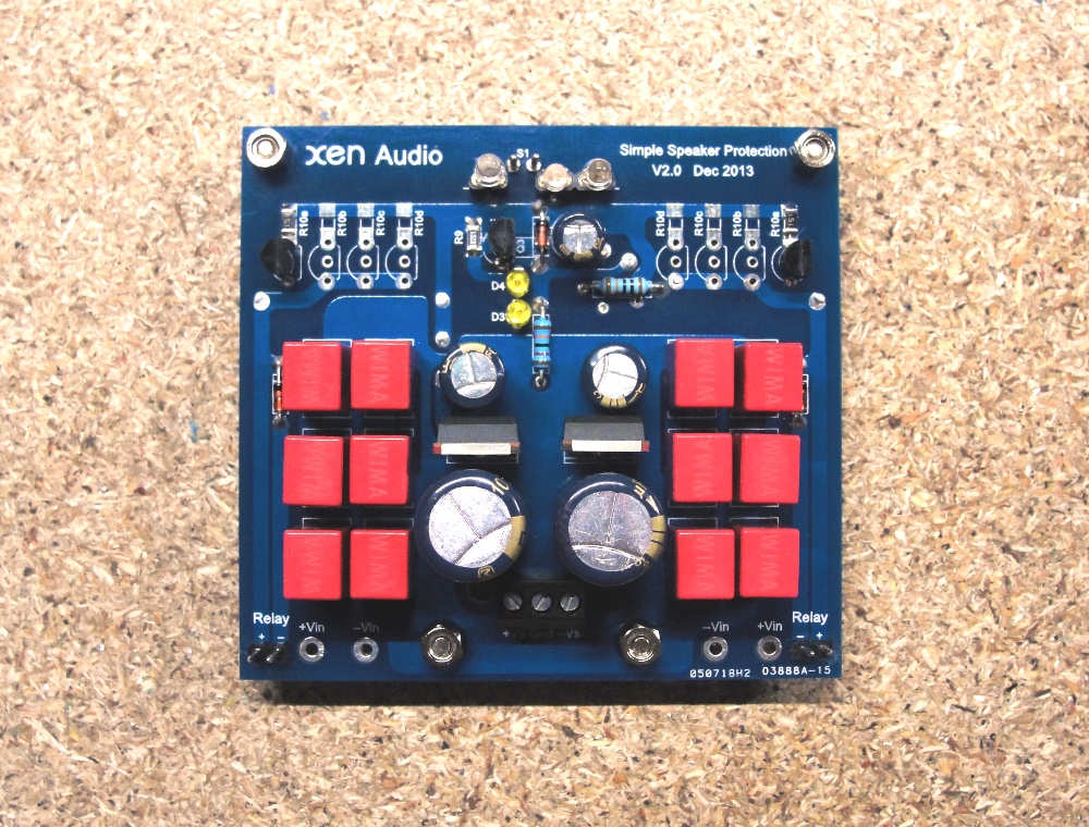

A short note for those using the V2 PCBs :
For power supply you require min. +/-18V 50mA.
There are 7815/7915 regulators on board, with capacitors before and after.
So a rectifier after the transformer is sufficient.
The Gnd of your amplifier should be connected to the mid-point of the protection circuit power supply via a 1k resistor.
There are two relay connections and two detection circuits.
Unused relay connections can be left unconnected (isolated to prevent accidental short circuit).
Unused detection inputs should be tied together to prevent unwanted trigger.
Patrick
