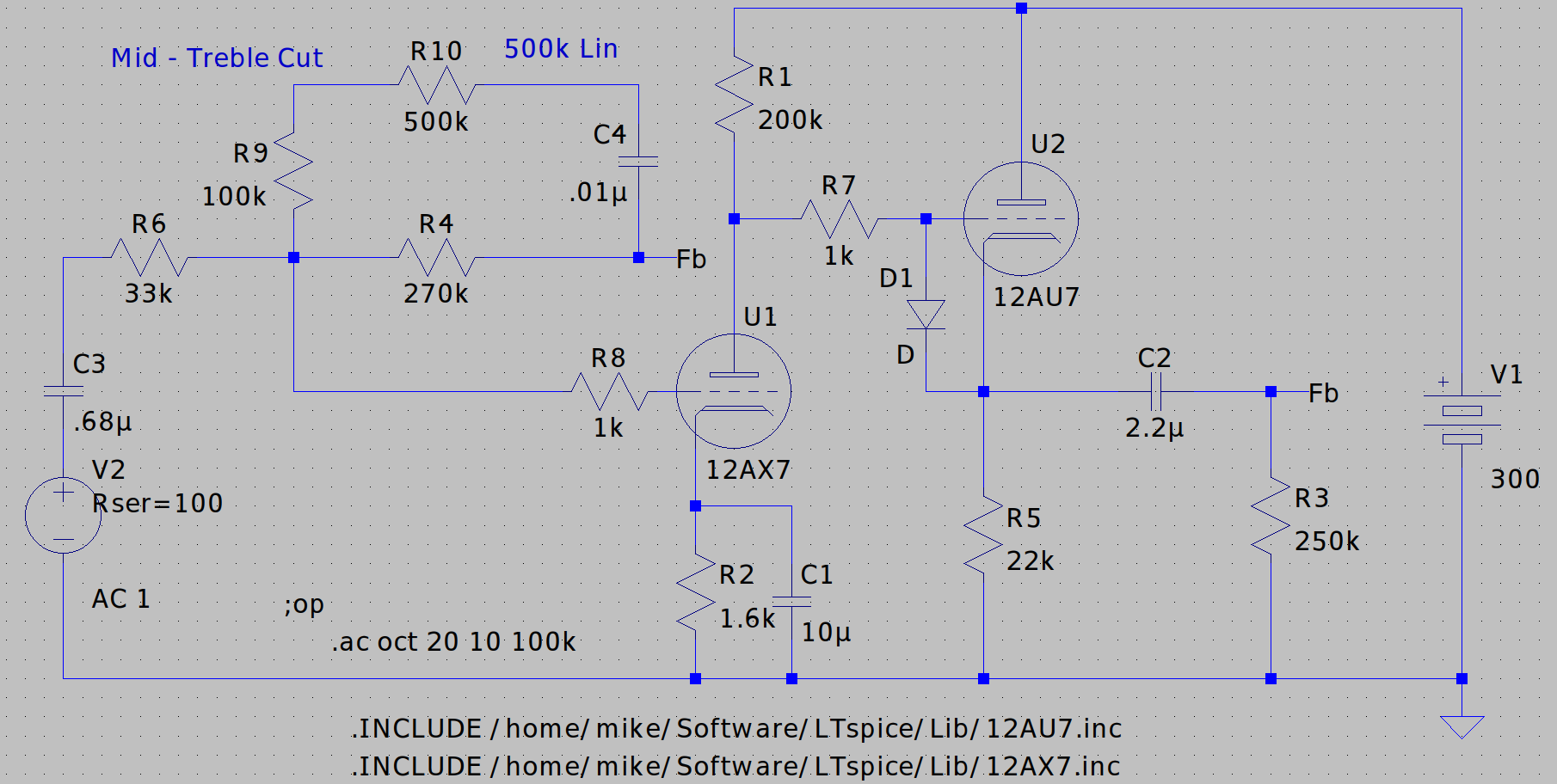

OK, so I hope that life is settling in enough for me to actually try a simple project. So I was thinking of a simple preamp using parts bin bits which includes lots of 12AX7s and 12AU7s. The basic idea is a 12AX7 gain stage direct coupled to a 12AU7 follower with FB from the follower output to the input. Gain is set a bit on the high side intentionally since my power amp is pretty low sensitivity.
Of course my natural tendency is toward mission creep so I thought why not add a simple contour control to the FB loop since that is probably all the EQ I would typically need. R9, R10, C4, and L1 make up the contour control. With no L making a mid/high shelf is no problem but adding the L naturally results in some interactions that cause a big bump around 25k-100kHz at least in the simulation.
Besides the extra very high frequency response my concern is stability. So my first thought was to add a cap (comp cap on the schematic) to roll off response over 30kHz.
So the question is this type of contour control a bad idea over all and if not what would be the best way to stabalize and control HF response?

Interesting Schematic.
However, L1 is 4 what? 4H, 4uH, 4mH?
Lots of inductance for L1 will have lots of distributed capacitance (end to end across L1).
I suspect that regardless of the simulation, L1 will self resonate somewhere and give a large wrinkle/ripple in the frequency response.
And, depending on L1, if it has a core that is grounded, there is also the stray/parasitic capacitance of the winding to ground.
I do not see any of this in the schematic, so it is probably not included in the simulation software results.
Then there is the series resonance of L1 and C4. Another item to check. The Q of L1 / C4 should be fairly low due to R9 and R10.

So lest this get out of hand I think that something like this is a better bet. Simple mid and high cut which at full down is -3dB at about 80Hz and max cut of about 9dB. Any further tone control can be added in a separate EQ. later. The follower output should be fine for driving my tube PA and a sub amp if necessary.
KISS.

The diode connected directly to U2's grid, reduces the effectiveness of R7 grid stopper.
How please? AFAIK a grid stopper is there to reduce the effect of the Miller capacitance. As the diode is biased off due to U2's cathode being at a higher potential than it's grid and by inference higher than U1's anode. What is the diode doing to reduce the effectiveness of R7?

The diode's anode-lead presents extra metallic area that can pick up (phase-shifted) signal from the anode. The self-oscillation frequency of small triodes can be high, so even a small piece of conductor is not a zero risk.
Place the diode on the other side of the grid stopper resistor, and the Q-spoiling effect of the resistance will be helpful
This seems like a lot of hair-splitting to me. The purpose of the diode D1 is to protect the grid/cathode circuit from a large positive voltage at startup. It can do that job just as well on the other side of the grid stopper resistor.
As Bigun already explained, the grid stopper resistor R7 should be physically located as close the grid pin on the tube socket as possible to do its job of suppressing HF oscillations. Putting the diode between the grid stopper and the grid pin on the tube socket requires that the grid stopper be moved a little farther away from the tube socket. Will this matter much? Probably not. But there is a valid reason to move the diode to the other side of the grid stopper, but no real reason that it should be placed next to the grid pin.
Thanks Rod, makes sense. These minor tweaks can have big consequences especially with twitchy valves like ECC88's & ECC81's who are as stable as Mr Trump.
I have used these diodes before on cathode followers, beware though when the previous stage is directly coupled, as, if whilst fault finding the valve with diode is left out, it effects the previous stage as the diode is not turned off and will pull the previous stages anode voltage down. That caught me out once, took a while to figure that one out.
Back to the OP's schematic,direct coupling is all well and good but it can be a pain in the **** to set DC conditions correctly, I advise maybe popping in a preset as part of R1 and or R5, at least for a prototype.
