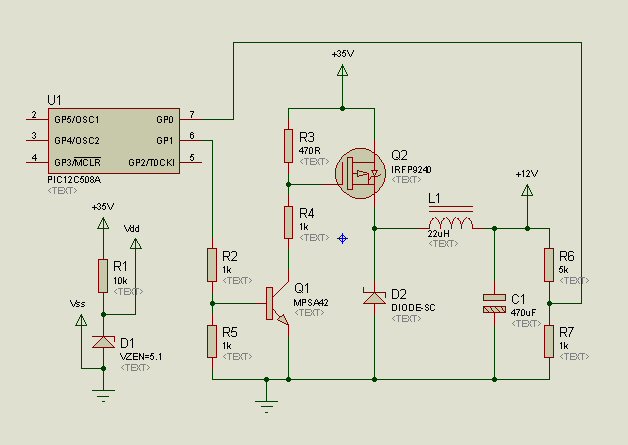

Here is the simple PIC12f508 code.

Any reason not to use a switchmode IC such as UC3843 or similar?
I recommend running faster than 20 kHz. Otherwise, you'll hear your magnetic components whine quite clearly. I also recommend using a buck or buck/boost topology. It looks like you're running very high peak currents through the mosfet and zener diode. I don't think that's good for the reliability of those components.
Or better yet... Leave the design effort to the pros and go with one of National Semiconductors' SimpleSwitchers. On some ICs all you need is a resistor network and a couple of caps. On others, you have to supply an inductor and a diode as well. It's not rocket science, but it is slightly more cumbersome than the average linear regulator design.
If you don't need a high output power, something like the cheapo flyback supply described by Dwaine Reid in Electronic Design April 8, 2010. "Build Your Own Ultra-Low-Cost Isolated DC-DC Converter" would work. You should be able to get to the article through a google search (or go to Electronic Design directly).

The main problem seems to be the amount of extra components needed.
I can use an 8 pin PIC that is around 60p.
The zener is just a fast diode, used wrong part from library.
The inductor is 70p.
The P channel MOSFET can be a cheap part.
The circuit relies on a PIC input threshold of 2 volts, so all I have to do is scale the feedback voltage for the PIC.
I have used the watchdog on the PIC in case of failure sending 35 volts to the 12 volt supply.
Both this and the Electronic Design article are dead simple. but I can see "possibilities" where such a low-cost design could have a lit more features.

It's a bit hard to read the schematic. I've redrawn it to make it a bit more comprehensible. Is this what you've got?
w
That looks correct.
It is just a first fraft.
w
THANK YOU!!! Now that the resistors are drawn as resistors and not transmission lines, the inductors as inductors and not resistors, I do recognize that it is indeed a buck regulator. Fantastic.

What extra components? A UC184x-series controller would require 3~4 $0.03 passive components in addition to what you have. In return, you get a power supply with load regulation, line regulation, and low temperature coefficient. You don't have to use the current mode control. Just ground the current sense input and you have regular voltage mode control.
There are less expensive options out there. SG3524 comes to mind.
So your reference voltage is purely the threshold voltage of a logic gate?! First of all, that voltage is not guaranteed by the manufacturer. Sure, they may have min/max limits, but they're typically fairly loose. Secondly, the threshold voltage will vary with process (i.e. lot-to-lot variation), temperature, power supply voltage, loading, and a whole slew of other things. In addition, operating a logic gate at the threshold voltage will cause the gate to chatter and draw high supply current. Think of an inverter where both the NMOS and PMOS are on at the same time. That's what you have going on.
You may be able to get it to work on one prototype. But try building two of them and measure the difference. I'm also curious to see your Vout vs Iload and Vout vs Vin plots... 🙂 Especially over temperature...
If you insist on using the PIC, I strongly strongly suggest that you use one with an A/D converter. Write the code to drive the switch with a pulse width modulator (remember to use double-buffering). Make a real control system where the PWM pulse width is inversely proportional to the ADC value. This could lead to some learnings about how control systems work. Mess with the gain - i.e. the constant of proportionality between the PWM pulse width and ADC code.

The PIC does a bit more than supply a 10KHz pulse.
It only supplies the pulse if the output is less than 12 volts.
A PIC input threshold is 2 volts and this is used for a comparator to measure the output volts.
Finally got around to building the PIC SMPS.
There is a problem with the PIC input pins as they have hysteresis on them.
This causes a step in the output voltage.
I have ordered a PIC12F510 which has an A2D on board, this should fix the problem.

Why not just put in a comparator (opamp), which you probably have lying around?

You can buy PIC's with comparators in anyway. I just chose to use an ADC as it doesnt cost any more.
I strongly suggest using proportional control rather than on/off control for controlling the pulse width of the switch drive. A comparator has way too much gain at the switching transition. This high gain in your control loop will make the system unstable and you'll end up with huge voltage ripple (best case) or complete lack of control of the output voltage (worst case).

The PIC only outputs a single pulse if the voltage is below 12 volts.
This is a tiny amount of charge. The gain is very low but it still reacts very quickly to change.
The pulses are very short, 50KHz.
I had considered a PID technique but this involves so many calculations the PIC would never keep up.

I didn't suggest it on the basis of cost, or that it was ideal. I suggested it on the basis of probable availability for for a solution to the hysteresis for a bit of messing around at midnight on a Sunday evening.

What are you writing in, QBasic?! PID is the second simplest control method in all of digital design.
