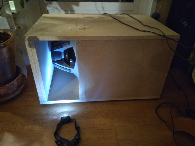

Here is a picure of the build. I hope I can post some measurements later.
The grey curve in the Hornresp SPL simulation above is the pure closed box response without the short QW front resonator.
There is quite an increase in midbass output even from this very short QW front resonator. I would have made it longer if I could, but I did not want to fold it since that often introduces a lot of higher order harmonics due to reflections inside the resonator.

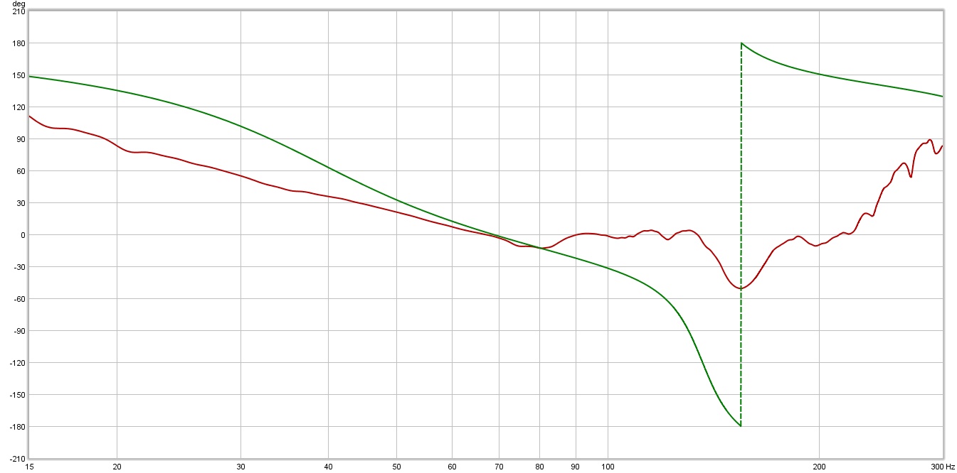

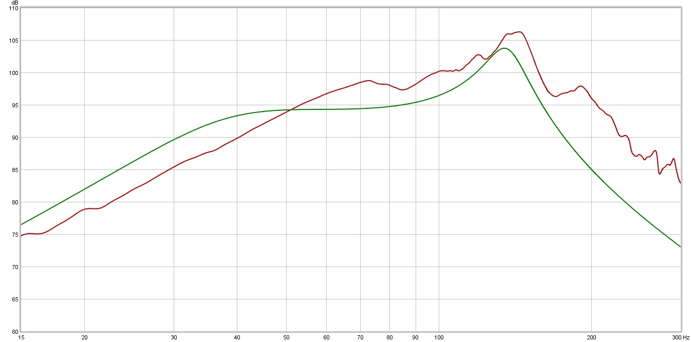

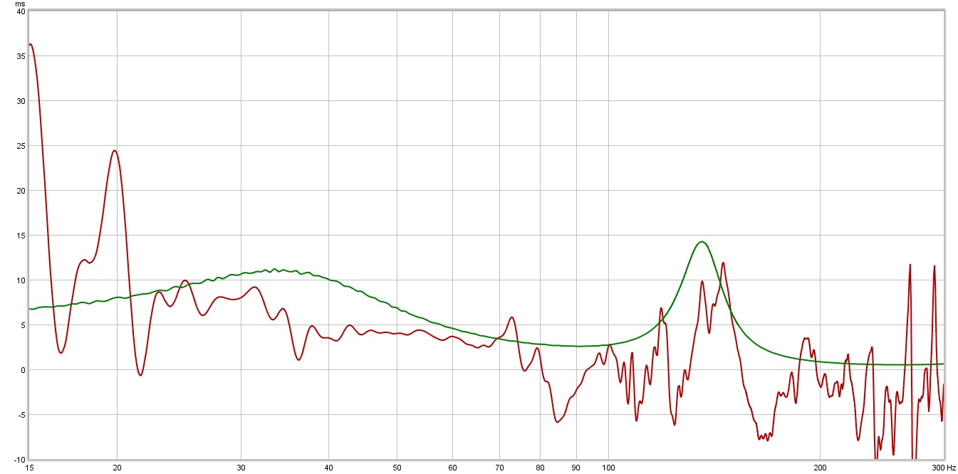

Here is the simulation compared to a measurement of the box laying on my living room floor and with the Umik very close to the mouth of the front resonator.
Spl, Group Delay and Phase.
I don't think the stated specs of the drivers are correct, and there might be some small leak around the flange of the driver. It is made of plastic and we had a hard time tightening them down without warping the driver flange. We used a lot of hot glue around the parameter.
It does tend to sound nice though. It is clean, punchy and plenty loud. The car cabin room gain flattens the response downward, but it is a little rolled of below 40 Hz. Nothing that some EQ can not fix, but without EQ it sounds a little light weight. It does have some horn character with a very snappy and punchy midbass and a quite physical and tactile reproduction, making drums sound very live and entertaining.
