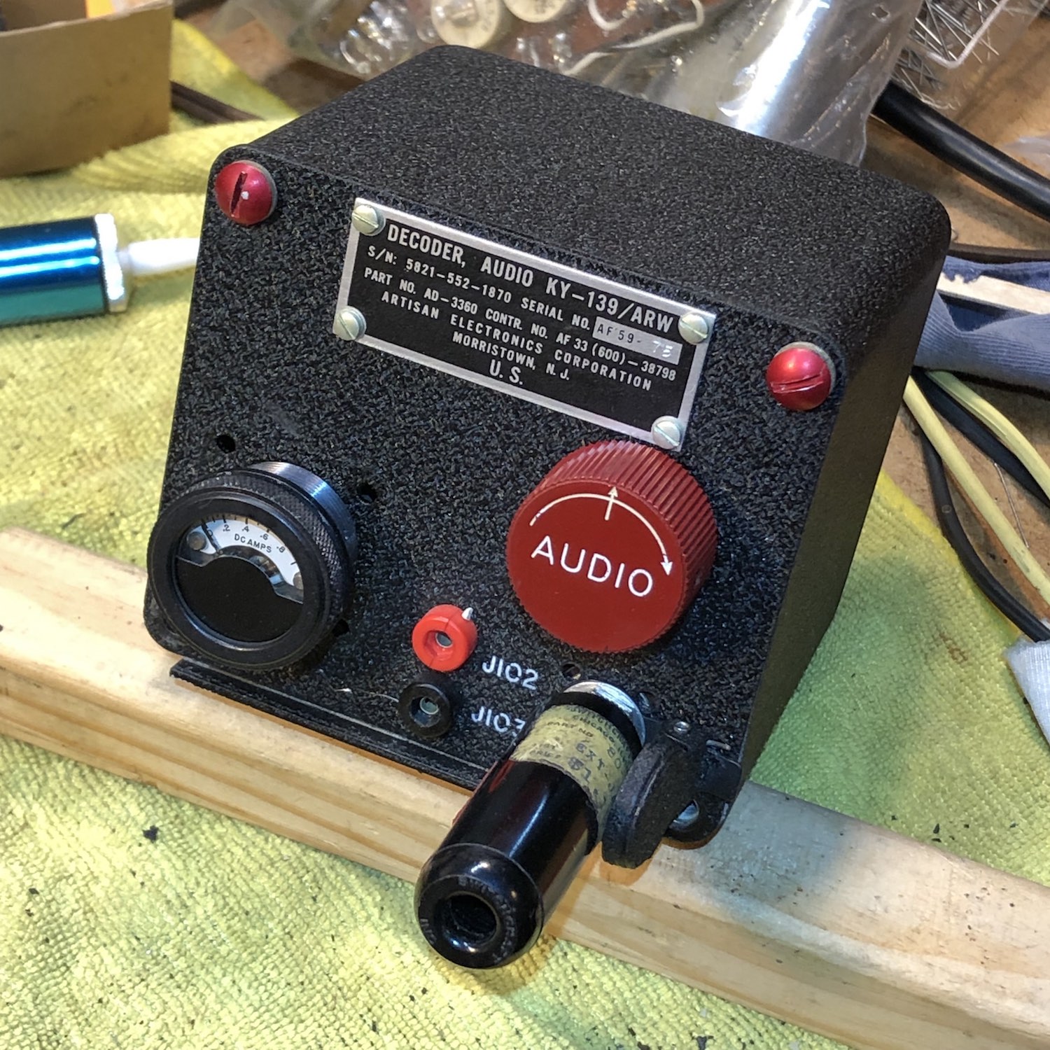

I'm making a little phono preamp for a friend, repurposing an old surplus military box.
I'm planning on using the Electronics Salon RIAA preamp, as I have it already-
Stereo Phono RIAA Preamplifier Module Board, Preamp, MD-A310. | eBay
Thought it would be handy to add a headphone amp inside.

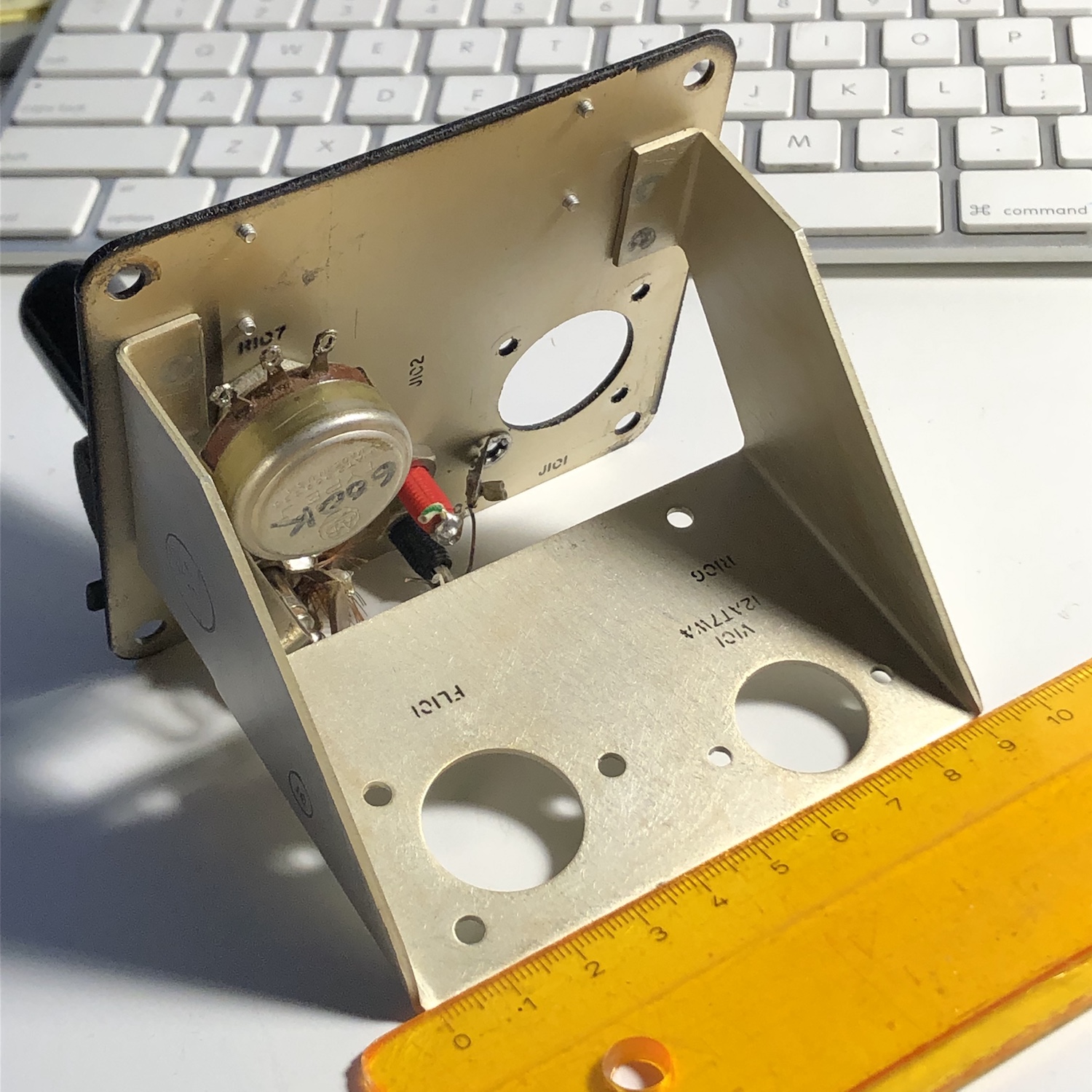

Spotted this thread and thought your design could work well. But it needs to fit in this little box. 85x60 mm or thereabouts.
What do you think?
Cheers- Kent

The board I used for this romp is 2.5" by 4", containing both channels. If you split it in half, the package would be more compact. The size will also depend on how much you want to accommodate lower impedance headphones. 1000 uF output capacitors will do for 50 ohms+, 1500 for 30 ohms and above, and if you want to handle 16 ohms, you'll need 2200uF. You'd have to string the amp between the +/- supply rails of the phono preamp.
