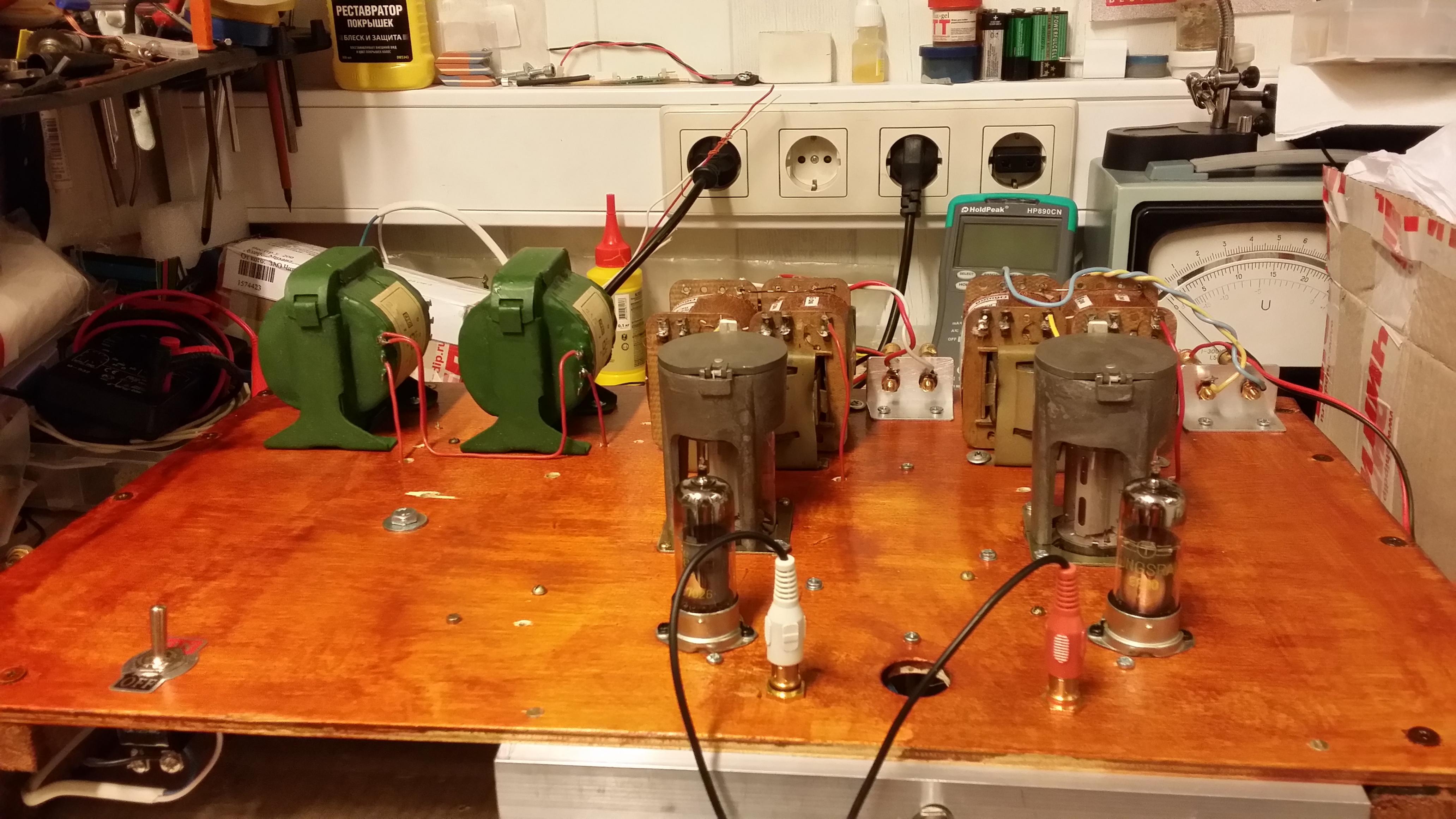

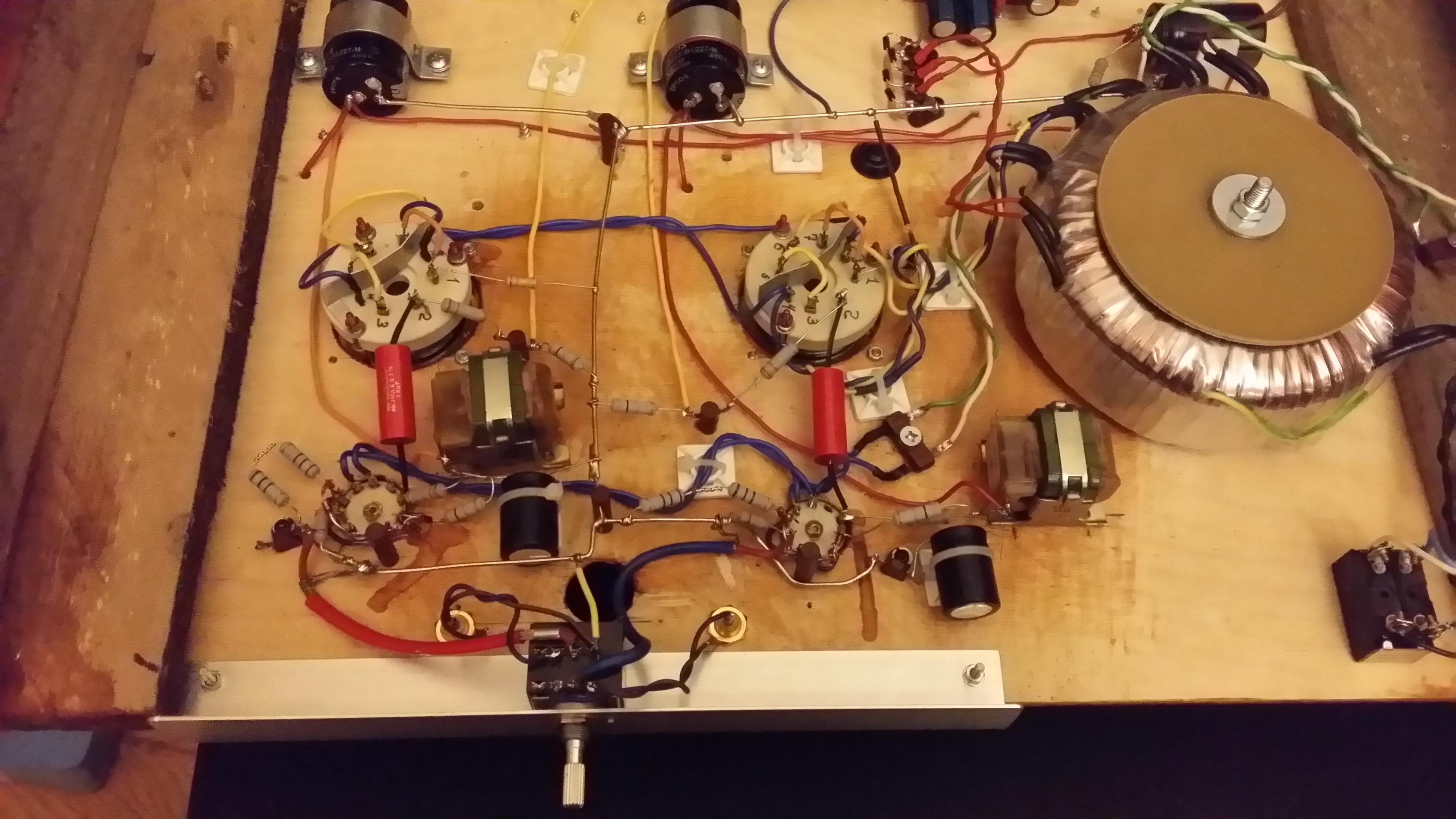

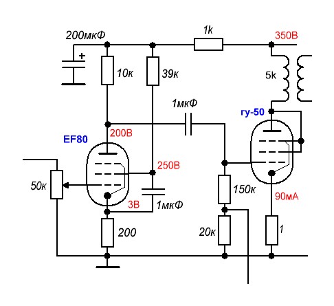

Hi all!
Just finished prototyping of my first SE amp ;)
Sound very good with my 12" full-range TQWP
WBR,
Mike.

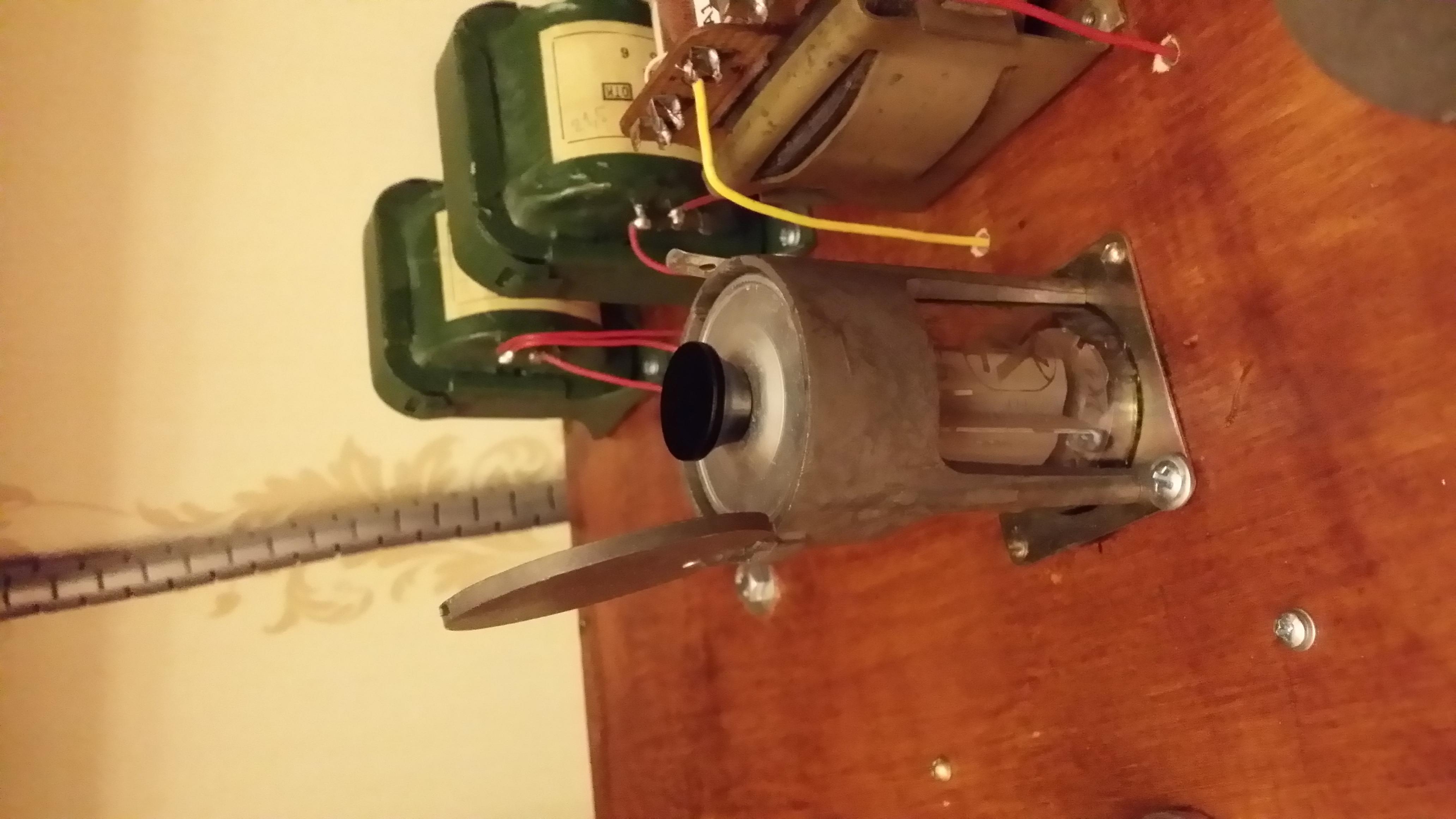

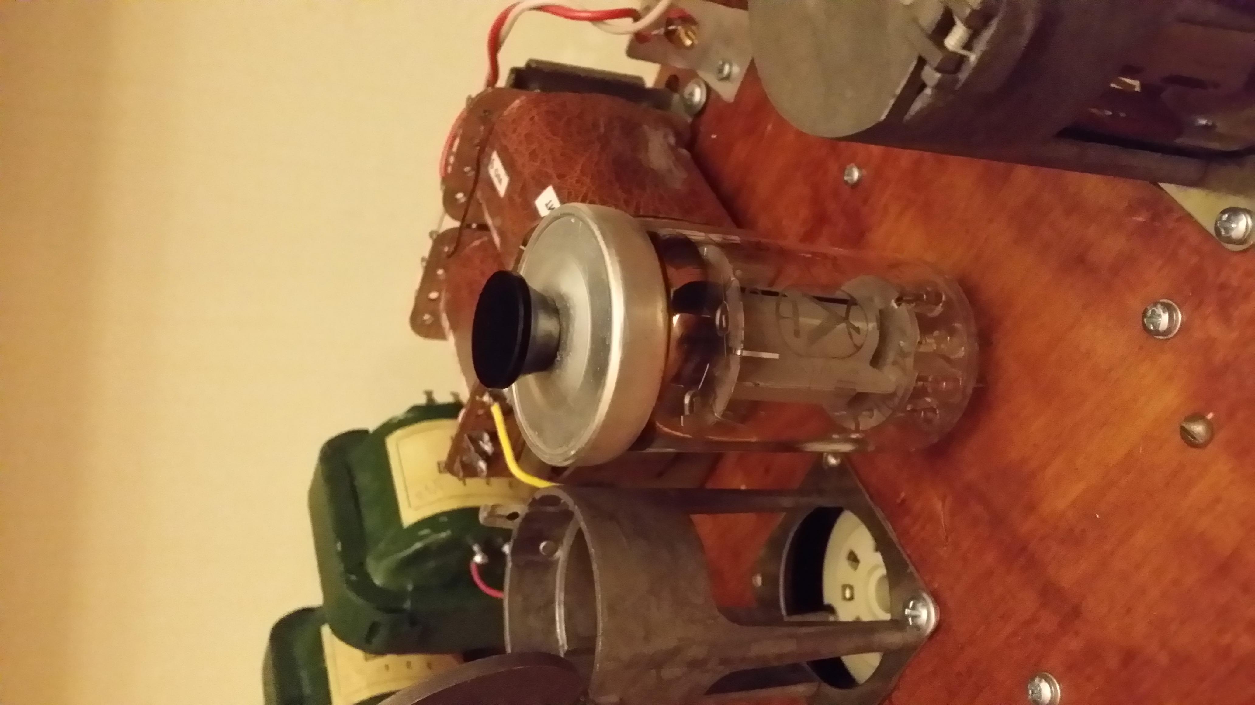

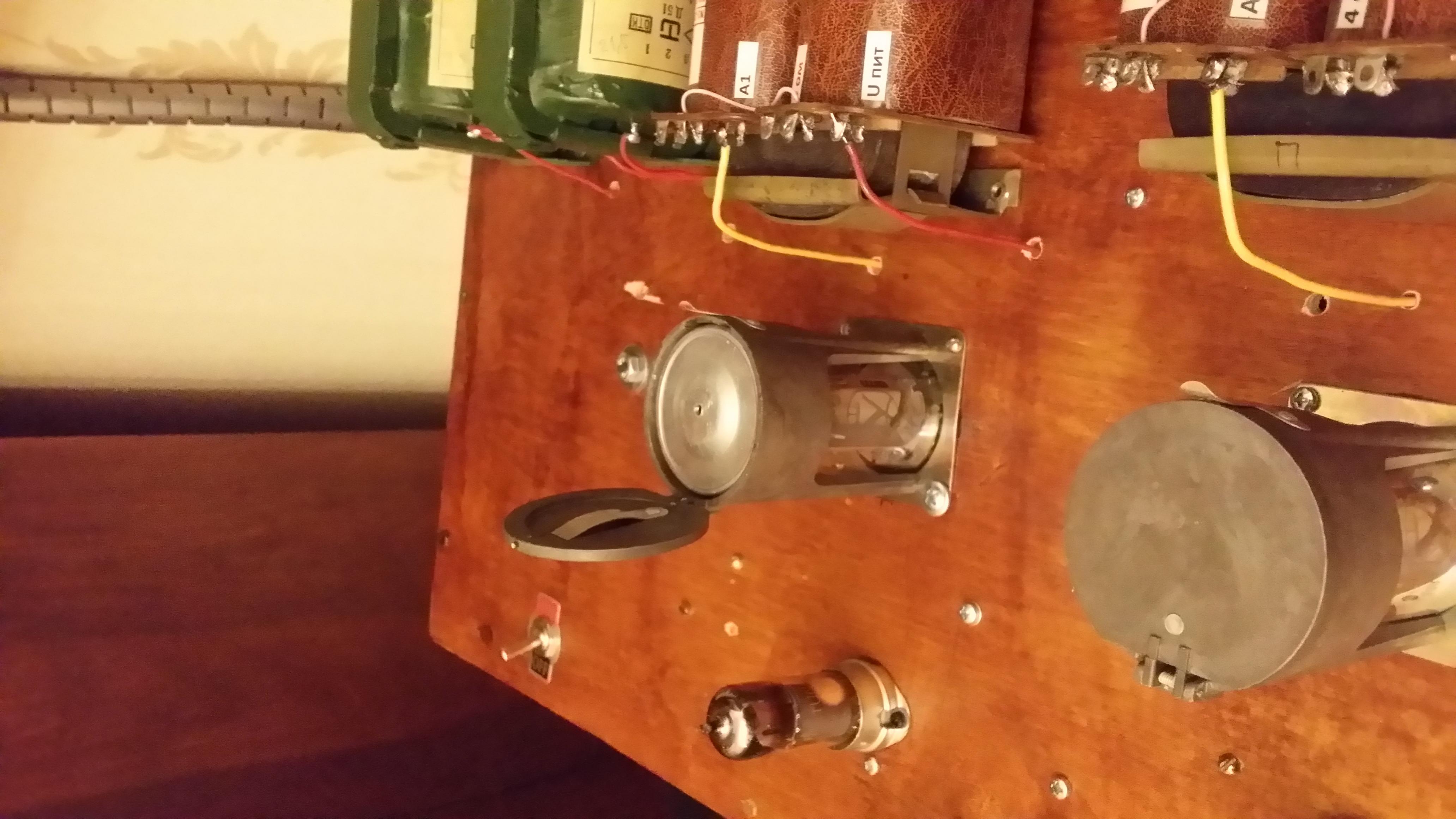

Green objects -2 chokes 20H 150ma each (military edition :)) lid can be opened for tube replace- see the pics. Not sure what brown detail you asked....
