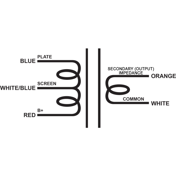

I have decided to fix the rectifier tube issue before working on the UL taps.

This weekend, I will take another look at the UL taps.
