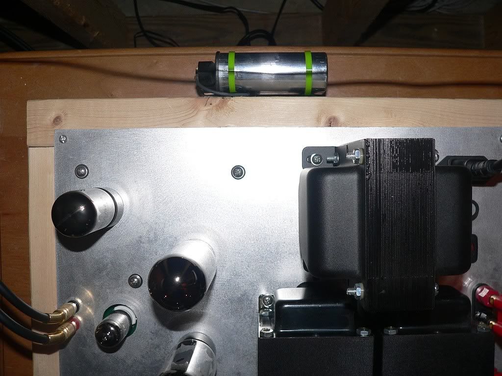

Well, I sorta forgot my 9"x14" chassis was kinda snug for the Simple SE and all its iron. I've got virtually no free space underneath. In a brilliant flash of stupidity, I decided to hang the cap on the outside of the chassis.
http://i69.photobucket.com/albums/i43/Ty_Bower/Simple SE/P1140551.jpg
http://i69.photobucket.com/albums/i43/Ty_Bower/Simple SE/P1140548.jpg
I'm not too sure I'm happy with the thought of 450 VDC on the exposed contacts. 😱

I'll install a non-inductive cover and ground the cap's housing if I were you. Uncover HV always made me uncomfortable.

I like the day-glo zip ties.
How does it sound? Are you running it as a bypass on C1 or on C2?

Assuming I've wired it correctly, it is in parallel with C2. It's tough for me to evaluate any difference in sound. I've recently made a bunch of other changes in the system. I think I need to listen to it for a few days, then try unplugging it and see if it is missed.
It has small enough capacitance that you could probably put it instead across C1 and keep a more conventional motor run cap on C2. Assuming of course you have room on the chassis.Assuming I've wired it correctly, it is in parallel with C2.
