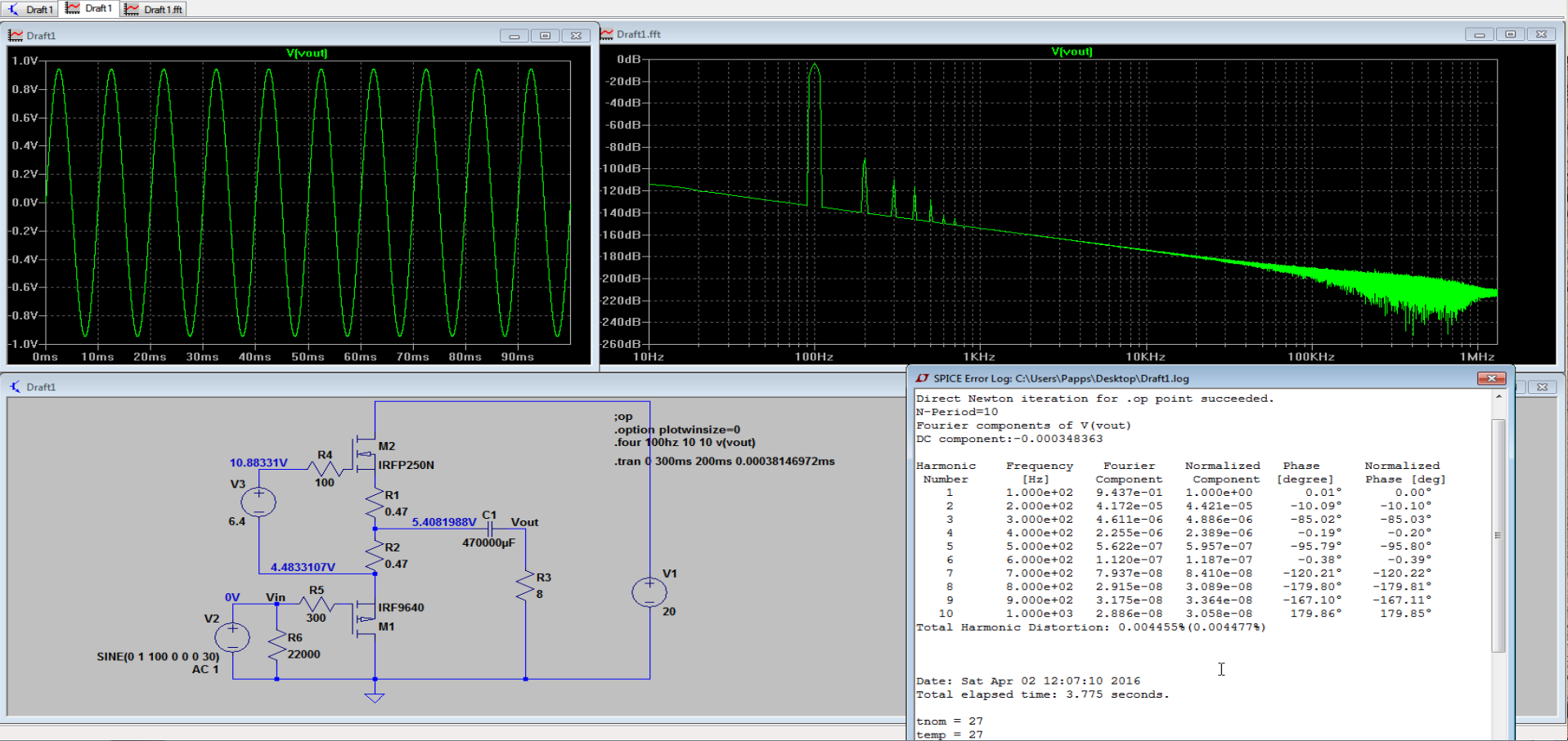

Hi Johannes,
Just want to say thank you by posting on YouTube a clip containing your SPICE.
https://youtu.be/J9WCaXorwdA
Cheers
Pascal
nb: my amp is a transformer PCF, still waiting for few P Mos to do a mutation to a transformerless PCF.

Thanks for testing my ideas and playing with the IRFP7430. It is a fun mosfet, even though it can have some serious attitude and character if used in a wrong way.
Your amp seems to sound very large, vivid and alive with the PCF.
In my experience PCF seems to work like a true "presence"-control in more ways then just increase the level of the midrange.
There seems to be a quite dramatic increase in distortion when you apply PCF to the SE-amp with the IRFP7430. How much PCF do you use? If pushing things far into negative output-impedance territory distortion will skyrocket and the speaker might start to sound very strange.
PCF is a very useful tool to increase control over the bass and to let the amp have some muscle and authority, but if overdone will lead to some strange phenomenon.
I have had my speaker displaying a hollow and metallic "twang" whenever subjected to any kind of transient. I guess it was just at the verge of oscillation. The speaker sounded like a broken 3 inch fullrange driver at the bottom of an empty tincan.
What do you think of the IRFP7430? Have you compared it to any other more "normal" mosfet?

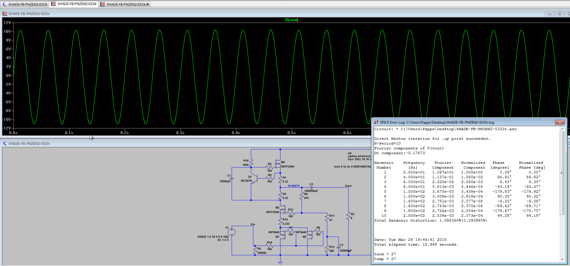

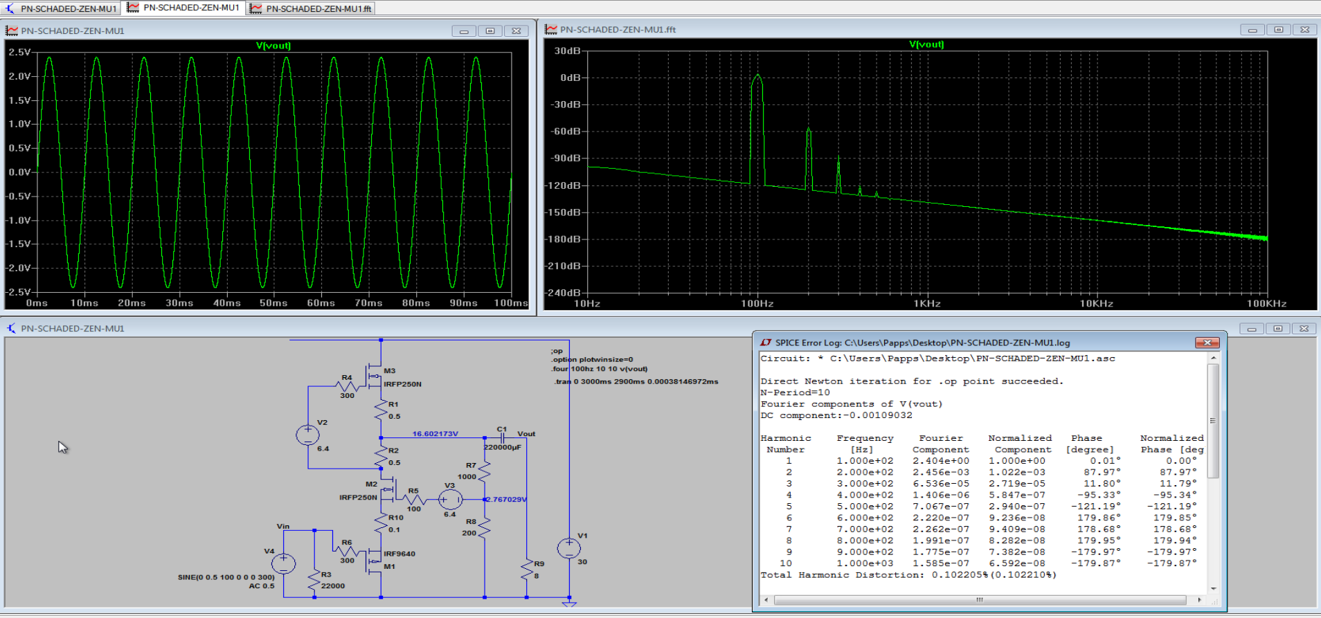

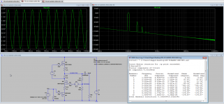

Back to PCF subject, on my last experiment, I had done only a switching PCF in and out to see how it affects the harmonics of the content
https://youtu.be/tfM3nDKFAIE
My next step will do a variation of the positive feedback amount (voltage divider at 8 ohm load).

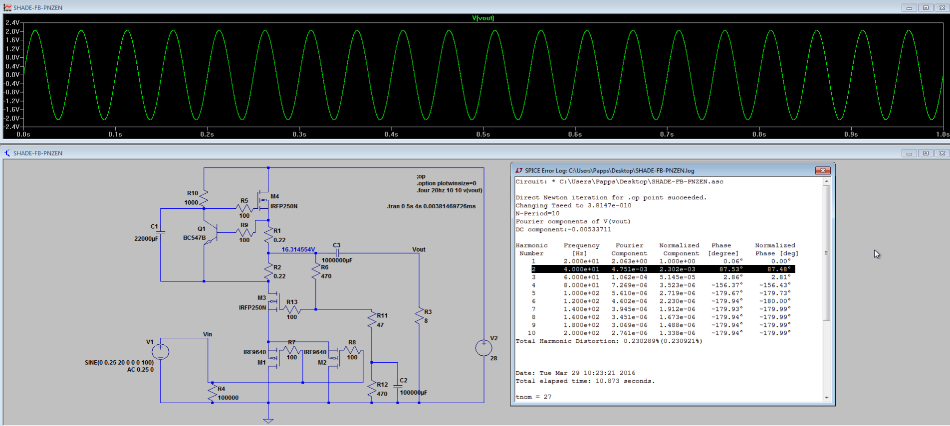

On your SPICE, I realised the limit is 7.5 ohm / 0.5 ohm before oscillation.
On my circuit, it will be a simple 500 ohm pot with a cursor to play with.

Johannes was kindly provided the SPICE's file to the forum, it was on my screen when I made a video, not related to my built amp.

- Simple Schade feedback without transformer
