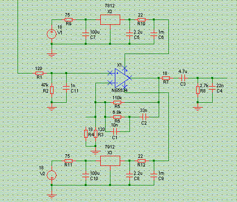

Simple RIAA amp from c't magazine
The main problem in Rods RIAA amp is - in my opinion - that the second correction network (the high frequency lowpass, a passive R/C network) is situated at the output of the amp and the filter characteristic is therefore always influenced by the following circuit. Everything below 100k is a clear no-no then. A ZEN V4 is definitely not suitable, although it inhibits a higher input impedance than earlier Zen versions. There is also not enough amplification level to drive a Zen amp.

I used 10nF 33nF and was thinking of 100k and 8.2k
And have 470ohm something to the ground.
Here you use 10/33nF 110k and 6.8k
Is that 18ohm//120ohm to ground?
/halo
It is not my design. RIAA is not very accurate. But it sounds good for a cheap preamp.
Switching in that 18 Ohms resistor brings gain up to 54dB or so, enough for some MCs.
Yes, maybe some. The open-loop gain is a little bit too low. You get larger RIAA errors becauce of the low feedback and also may the distortion increase(mayby not so important?).
RIAA Values
The values of the resistors & caps are not accurate.
if you want to use the .047 mf cap the resistor value should be 67.6K by deviding 3180 by the value of the cap.
The second part of the EQ. is the value of the resistor which in the schematic is 6.8K which means that your cap in parallel with it is going to be .011 mf by deviding 75 by 6800 Ohm.
The mid range curve is the combinations of both Eq's the high & the low put together. in this case your mid rage friquency is way high at (352) . But the correct mid constant is supposed to be at(318).
So to correct your RIAA curve & make it as accurate as poissible
you can use these values to put it at the closest you will ever get
The 1st resistor value is 67.6 K in parallel with .o47mf cap
that will give you the perfect (3180).
The second resistor value is 5.76K in parallel with .013 mf cap
you can get this value by putting .012 & .001 in parallel.
Your two values will come to a perfect (75)
Now when you put both of the Eq's together you will come to
a closest perfection of (315) for mid range curve. The
the formula ask for (318)
Good luck
