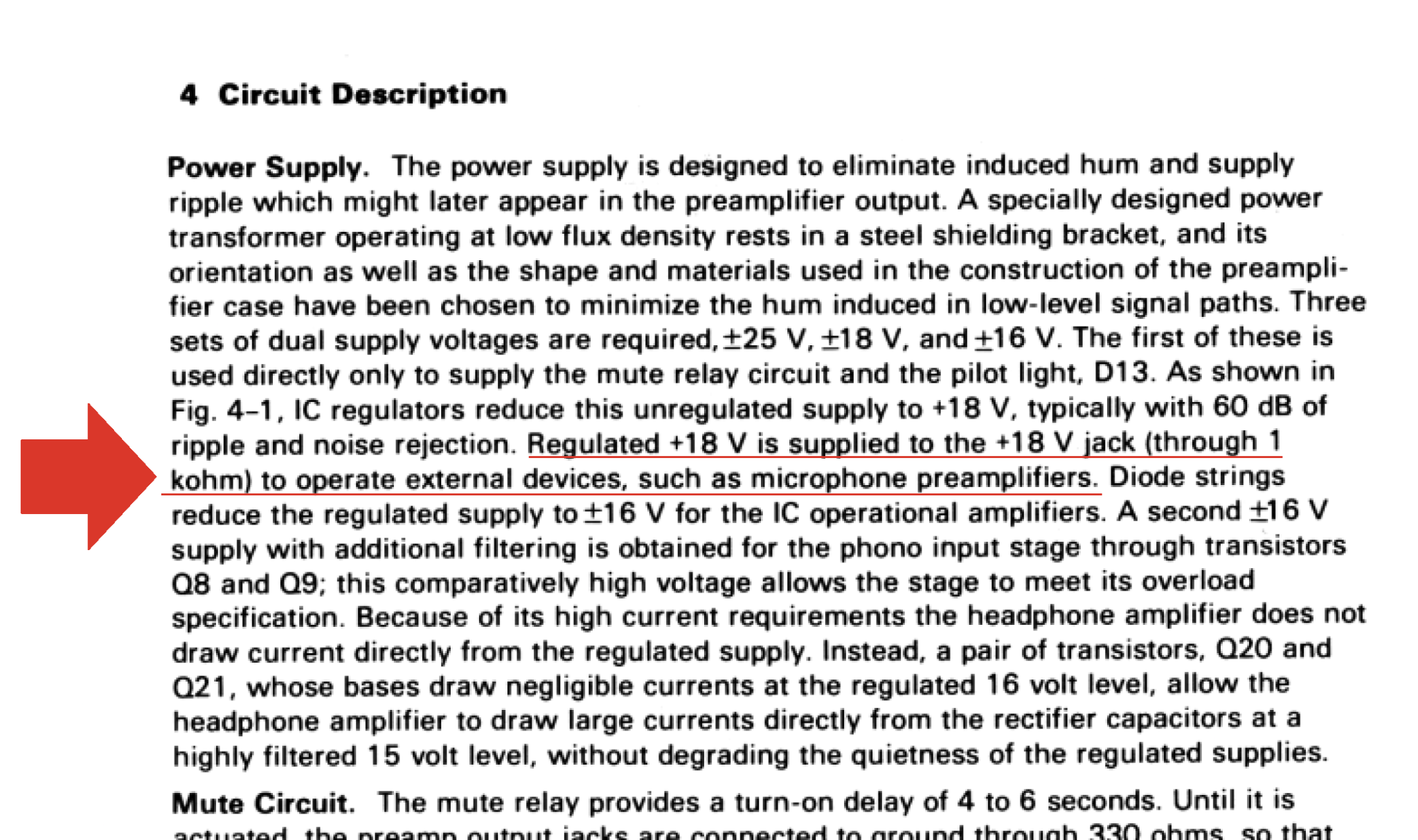

This is phantom power for condenser microphones, a few mA is plenty. Studio grade phantom power is 48V through 6k8Yes, referenced it in my last post. I don't know what a microphone preamp us or the typical current requirements.
