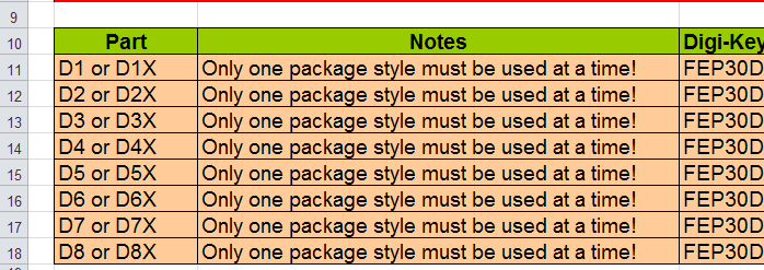

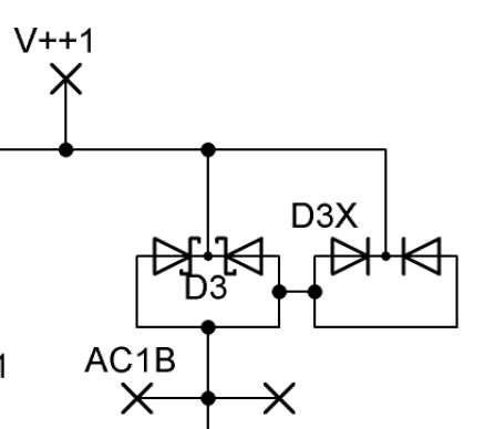

I looked at the schematic in your link. It looks like each leg has four diodes in parallel, two schottky's and two normals. I can't see that as being correct, is that really how it's designed, or does one choose which element to put in?
The Bill Of Materials includes the magical word "or".
The PCB Layout only has room for one or the other but not both.
As I suspected, thanks.
The question I still have is, it still appears to parallel two like devices. Diodes will tend to runaway thermally in parallel, one device will end up carrying all the current.
When two dice are put into a common package, there is no guarantee that they will share equally either, even if they are adjacent dice from the wafer.
