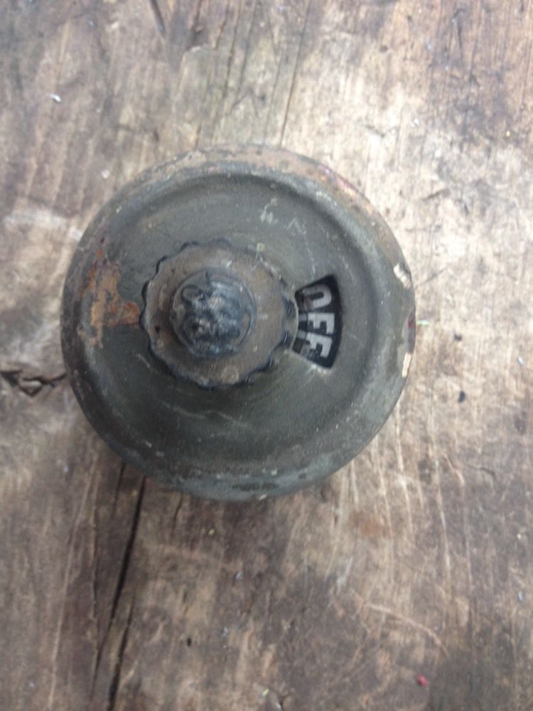

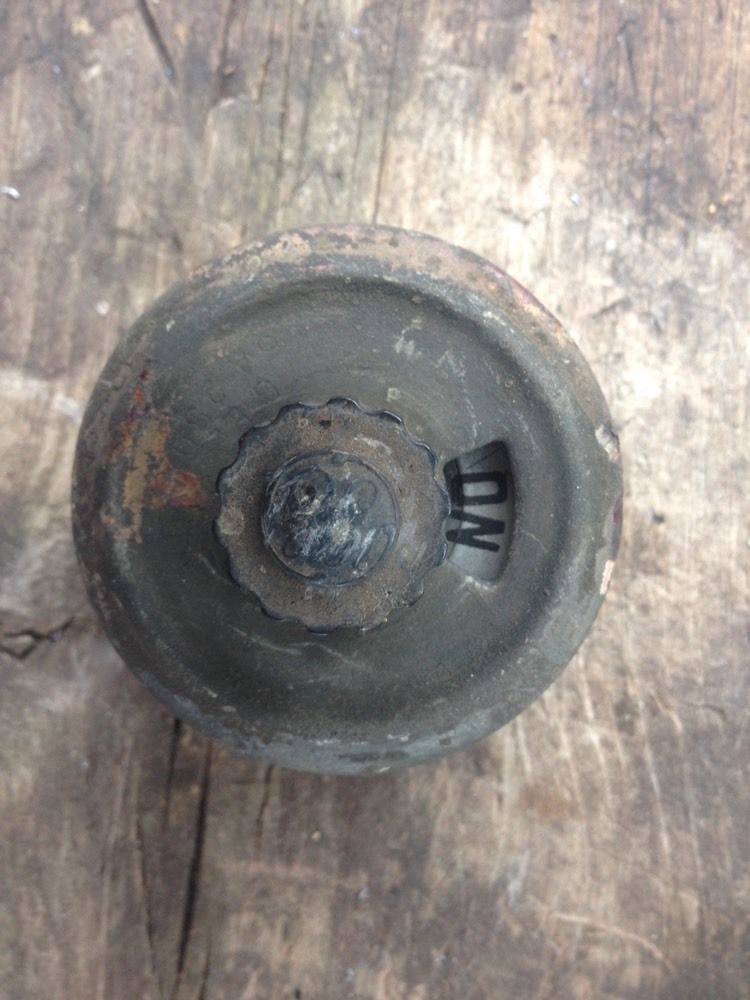

I would avoid using a really old switch unless you are absolutely sure that the insulation is up to modern standards. This is especially true if other people might use the item.

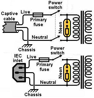

If your tube amp is Class I protected (i.e. three pole mains power connectors with chassis connected to neutral/"ground", the "gold standard" for diy tube gear), a single pole mains switch is safer and more reliable.
The predominant use of dual pole switches is due to the prevalence of today's class II gear, which requires dual pole switching to be safe.
No. This is because you can never be certain that 'neutral' really is neutral; electricians have been known to get this wrong, and people wiring plugs get it wrong too.If your tube amp is Class I protected (i.e. three pole mains power connectors with chassis connected to neutral/"ground", the "gold standard" for diy tube gear), a single pole mains switch is safer and more reliable.
Double pole switches are best for both Class I and Class II equipment. Single pole switches belong back in the era when electrical safety was not taken as seriously as it is today.
@goldenbeer: IMHO a single-pole mains switch is safer and more reliable only in situations where the physical design of the connector ensures that live and neutral connections can not be reversed. It does not depend on the ground connection. Even a class II device with a polarized connector would be safer with a single pole mains switch.
But: At least the german three pole mains connectors can be connected in two different orientations, reversing live and neutral. In this case, a two pole power switch is required to ensure that the live gets disconnected when the device is switched off.

For class I equipment ( - and using isolation power transformers, the typical diy stuff - ) where the yellow-green earth is connected to the conductive housing, it is typically safest and most reliable to simply switch/break the mains loop on the primary side of the power transformer using a simple single pole switch.

We may disagree on "overall safety", but certainly there's no doubt that the double pole switch has more potential failure modes, incl. the possibility of hidden or dormant failures. Single pole switch is the most reliable and the most obvious in (normal and abnormal) operation.
IN the first instance to the OP don't even think of using old switches for mains control.

Well this turned into in interesting conversation. I am already using old knife switches to activate relays for my inputs so I might as well do the same for the power too....using the proper relay of course.

For class-I apparatus, BS/EN/UL60065 states that if you use a captive mains cable, you must use an all-pole mains switch, i.e. both live and neutral (but not earth); the power switch is for safety.
If you use a detachable IEC lead then you can use whatever power switch you like (or none at all); the power switch is for user convenience, not safety.
