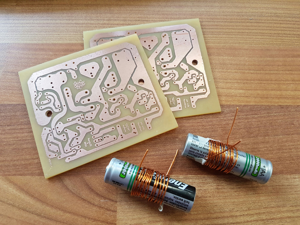

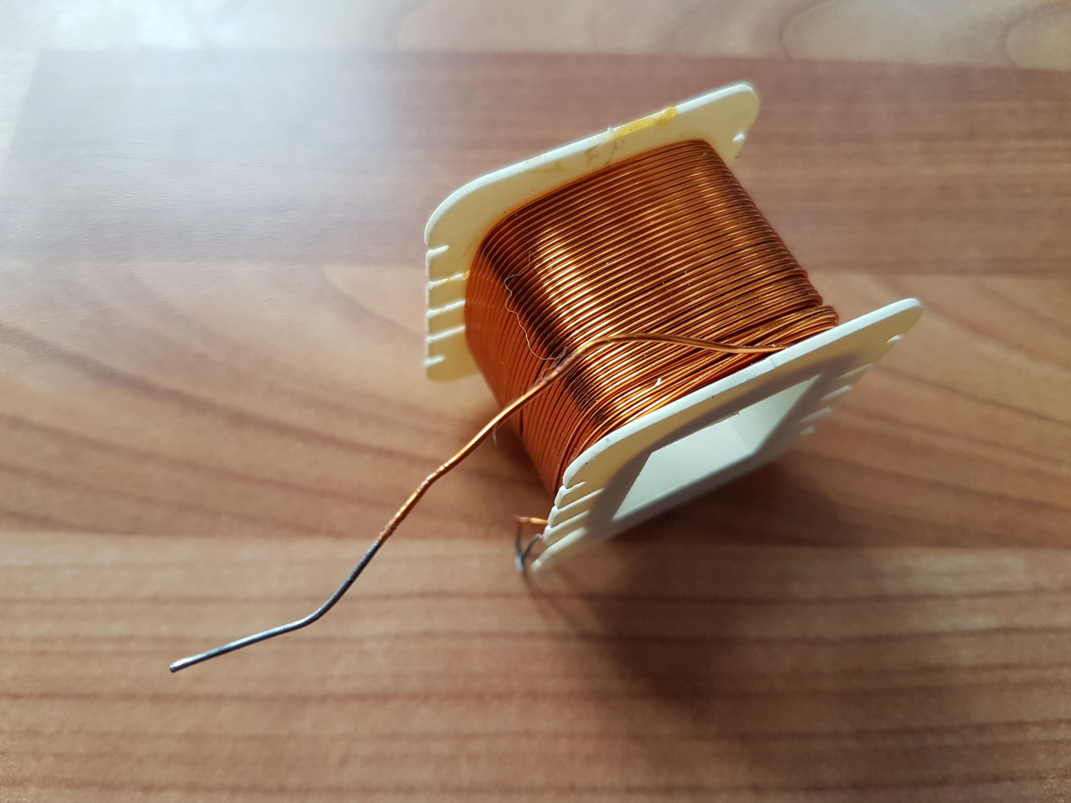

I am starting to gather the components to build this amp and wondered if I could save some money by using the enamel wire from an old crossover.
L1=1.5uH - the build notes suggest 10-15 turns around an AA battery with 1.2-1.5mm wire.
The wire I have is 1mm. Can I increase the number of turns slightly to achieve the correct inductance?

Don't worry about it too much - try to get 12 turns around a AA battery and your are close enough.
Thanks Xrk! 🙂
