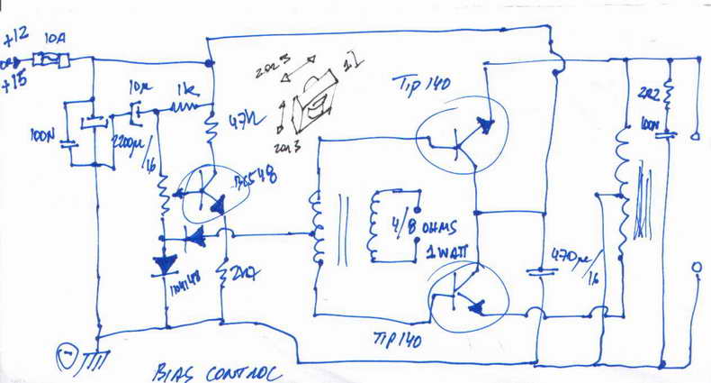

Hello Ddog...look this thing and evaluate
This is not exactly you need....but can match your need with small efforts.
You have to find an automobile radio receiver....mono or stereo, the way you want.... that can put something alike 1 to 2 watts RMS output in 4 ohms...... 4 volts off audio is perfect...... 2 volts can be helpfull too.
So, with the advantage that you already has tone controls and volume controls.... and also a good sensitivity using the volume radio's volume control as your input.
The output goes to the amplifier largely used world wide..... the first transformer is used to invert and give positive and negative cicles into two PNP darlington transistor (can use the one you have.....better than 10 amps each one is better).
This transformer is a 110 volts AC to 8+8 volts
110 volts AC to 9+9 volts
110 volts AC to 10 + 10 volts
110 volts AC to 12 + 12 volts
Or, if easier to you 220 volts AC input to 16 +16 volts output
220 volts AC input to 18 +18 volts output
220 volts AC input to 20 + 20 volts output
220 volts AC input to 24 + 24 volts output
all them minimun capacity is 200 miliamperes secondary current... if more it's ok, but transformer will be bigger.
the other one, is an AC small transformer that you dismount and put 48 turns of cooper wire (the one used in transformers, isolated, painted and protected against shorts)..... first cut the 1 or half milimeters diameter wire in two pieces of around 3 meters.... it depends the transformer size.... those wires are shorted in the beginning of the turns, soldered together and those parallell wires will be the coil.... 48 turns....... and three points.... one shorted and two others open.... so, you have three points....if you prefere.....may be easier and better... i do not know.... you can make 48 turns.... extract a small loop and them more 48 turns on it...... the E form laminated material will form 2 to the inches long...... 2 inches high and the metal part will make 1 inch large...... so....... seeing up side down you will discover that the letter E center leg measure around one square inches....my english is awfull..... stay stand by.... not sitted and look to the assembled transformer upside a table...... thickness off metal looking this way will be around an inch.... a small transformer.... 100 miliamperes or something alike.
This transformer is used to make the colector charge resistance to output..... and also to invert to amplify both positive and negative cicles of the signal.... i am sorry if you understand a lot and i may be "teaching old doctor how to measure temperature in termometer"..... sorry, i will see if you PHD or doctor in eletronics latter.
This amp is used since seventies.... small changes...... in the past no darlington exists.....now, people here is using darlingtons.... and with two of this circuit you will make a lot of good sound!....yes!...... Ein Gutten machinen!...... people put 2 units in their automobile and bigg speakers and bass and drum shack our apartment windows when they passed in the near street..... 20 stages down....more than 50 meters distant..... shacking glasses!
Can be a surprise...... can beat some Ueristêingsfarenhouser Tecnicsonic unt Marantz machinen......
Specifications are around that:
Voltage to work: from 12 to 15 volts DC, 10 ampéres each unit
Power output: can reach 70 Watts RMS ..... i believe in 50 Watts.... and completely clean around 35 RMS in 2 ohms.
Distortion when reach 70 Watts RMS under 2 ohms is 5%
Iddle current must be adjust by the trimpot to 80 miliamps
Normal consumption with 12 volts is 8 amperes
Power consumption to low distortion is around 96 watts... can goes into 150 watts range
Eficiency of the system....... 74 percent!..... 24 percent is lost!
1500 Squared centimeters heat sink..... something alike the normal 8 fins heat sink... the old ones used to 2N3055..... but with 12 centimeters each fin side.
Use two speaker .... better to use 50 watts, 4 ohms units parallelled....minimum 25 centímeter paper diameter.... long excursion and box tuned in 40 hertz..... speaker with a flexible suspension..... called here acoustic suspension... the speaker to use, normally in sealled enclosures.
The bias trimpot, to polarized tip140 darlingtons is adjusted to 80 mA and their value is 10 K ohms
If someone do not agree, please tell Destroyer X.... if something wrong tell Mr Ddog and also E Mail to Destroyer X.... if someone simulate and encounter another values..... please.... let me know
I will put a scratch..... made it fast...... is not my design..... is public ...... everybody is doing this same circuit.
Sorry scratch quality...... but the audio will surprise you!
Carlos Eugênio Mergulhão..... is the Destroyer X..... destroyer because i am old an changing transistor leads i am always putting fire on them..... X is extra, special, plus ..... very special destructor!

hi destroyer!
...car spl competition guys were always as crazy as their designs....
You tell PNP, but your schematics show NPN .
From circuitry NPN looks suitful for me.
Just to understand the circuitry:
The 220V winding (or 110V) will be connected to the
speakers? ..... not shown in the schematic....
Last but not least. Are you sure about your given
circuitry for the bias control?
Bye Markus

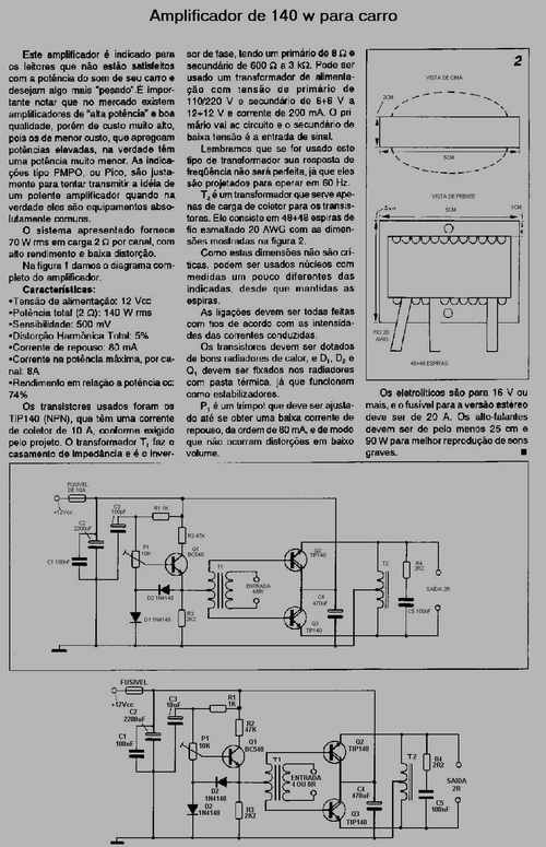

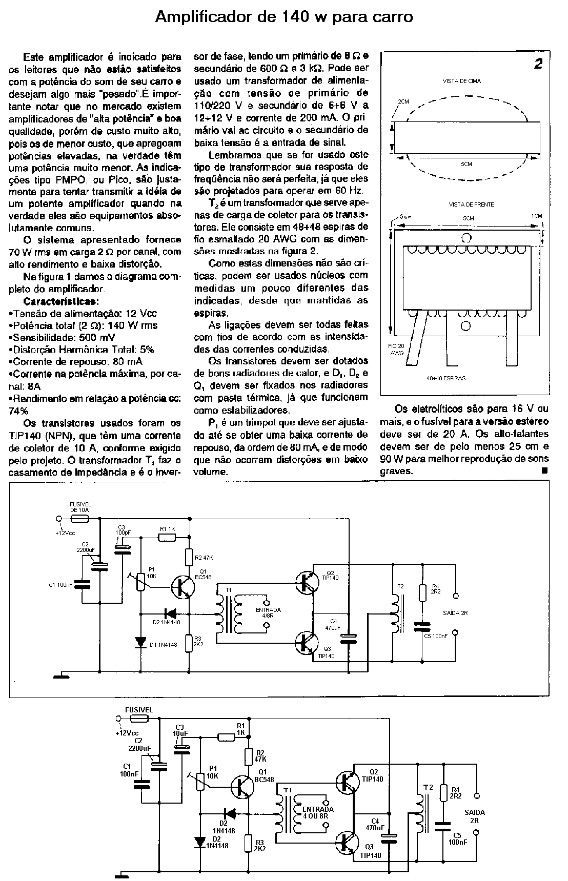

herr Chocoholic asked more informs related car audio booster
The image is bad....but you can check some off the connections.... you will like..... it produces from 12 to 15 volts.
Power is voltage multiplied again but the same value (squared) and divided by the impedance off the speaker.... so you can have something between 70 to 112 Watts (distorted)....but you can have around 50 to 80 clean audio.
A lot off people uses and is considered good....not wonderfull....but good enough!
regards Markus.....Her chocoholic.... i cannot......140 Kg, 180 centimetres high..... very fat!
Carlos is the destroyer X
