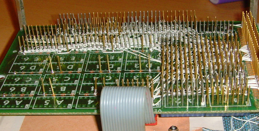

Andrew, when I have gone to the university to study "Information Theory" 40 years ago and have been taught, how to layout PCBs (using wire-wrap technology): one of the major rules has been to avoid "stray capacities".

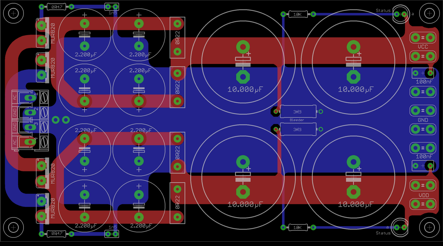

I am currently using a PSU-layout, shown in the picture below.
And I think: it is not bad at all.
Best regards - Rudi

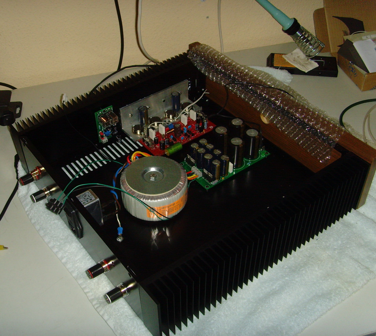

Find attached a picture of this PSU in a beautiful wooden case, featuring a TO3-SYMASYM (what else?!).
Best regards - Rudi
P.S.: The PSU shown above serves as a "Backend-PSU" only.
I have derived a "CAP-Multiplier Frontend-PSU" from the backend on this PCB..

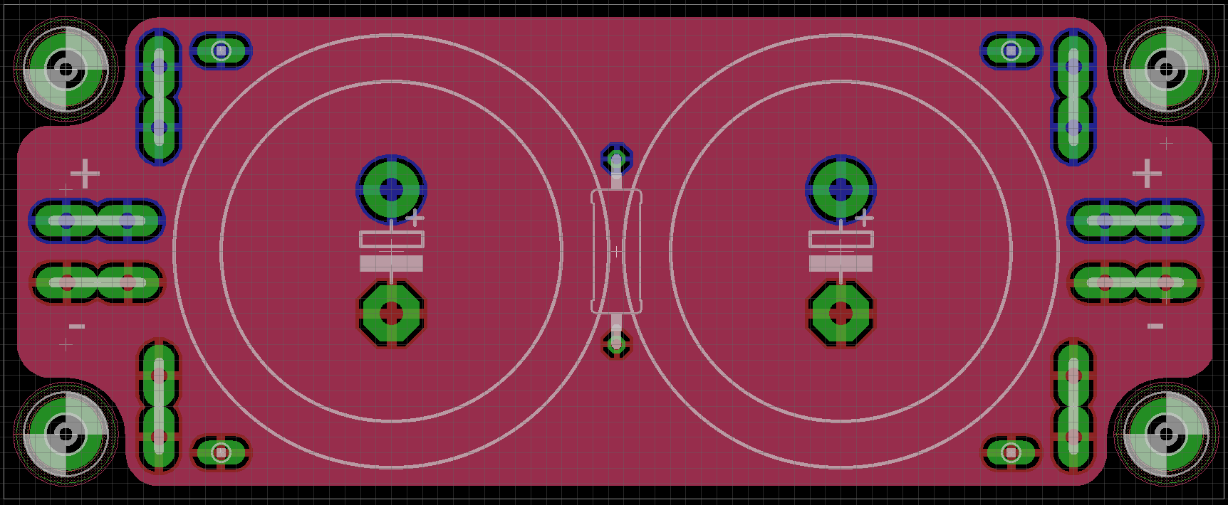

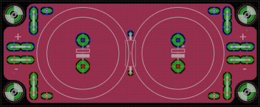

Attached is the two layer filter caps PCB that I just sketched. Layers are identical, one for V+ another for V-. One board is for two 35mm snap-in caps (one rail). The bridge rectifier will go off board. Two boards can be connected to form star ground between them while small size (100x40 mm) allows to put them flexibly withing the chassis.

I've done a few 4 layer boards for clients. They're actually easier to do than 2 layer boards. All the +/- connections just drop right to their own planes
instead of having to be routed, so there are many fewer traces. Either through-hole pads connect directly to the +/- planes, or if smt a short trace goes to a
via doing the same. At 4pcb, you can get a 4 layer pcb (up to 30 sq. in.) for $66. Osh Park is good for smaller pcbs.
