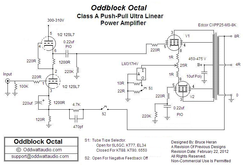

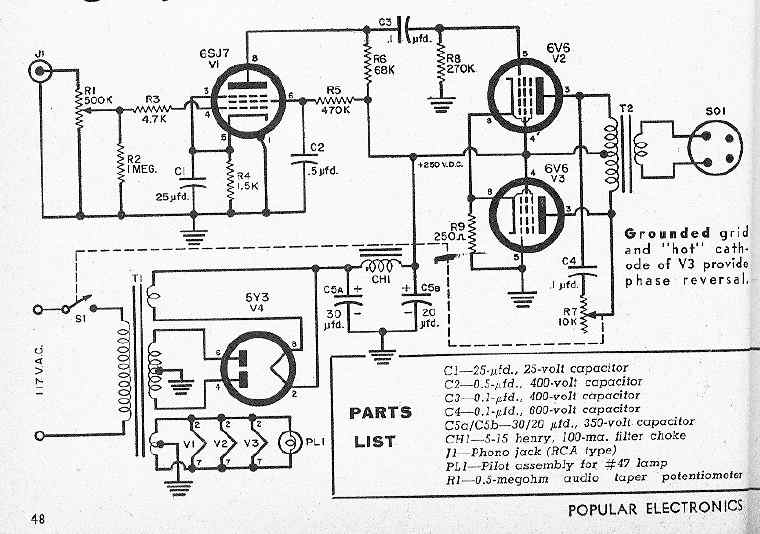

Have anyone tried this circuit, I really like the simplicity of the schematics.
I am wondering if someone here has some experience with the sound qualities of this amp.
Save your valuable time & $$$, the driver should be an ordinary phase inverter stage. I did extensive tests on self inverting output stage amplifiers a couple of years ago, reported here on DIY. All were inferior no matter what tail was used. Not recommended at al!!

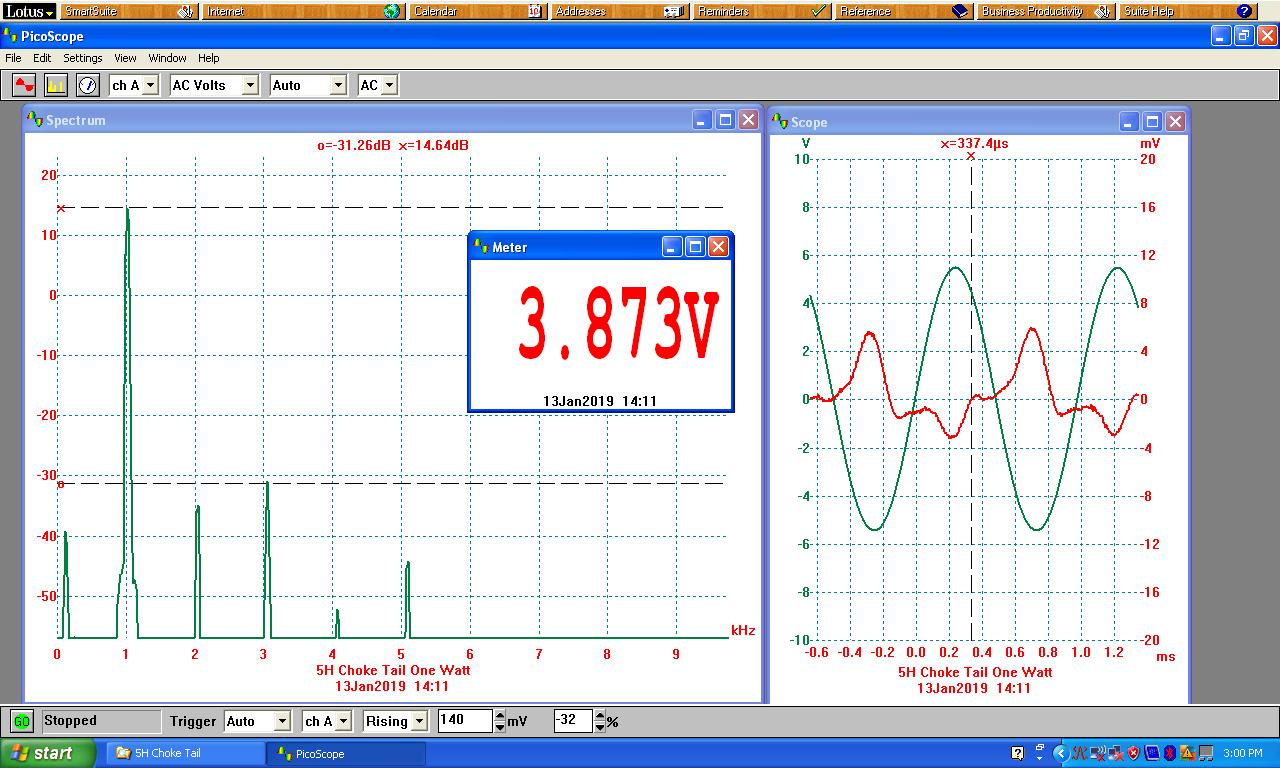

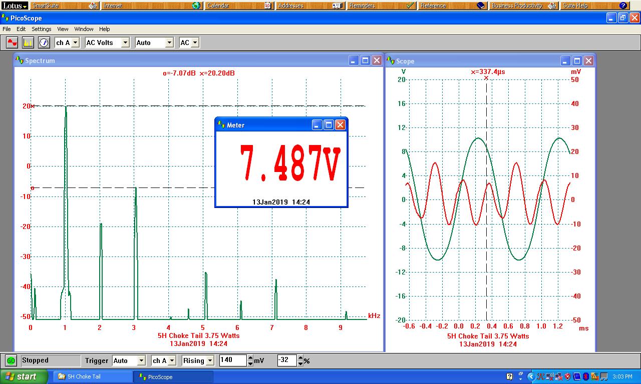

The best tail was a choke. If interested, I'll repost some of the test results later.🙂
Please do so.

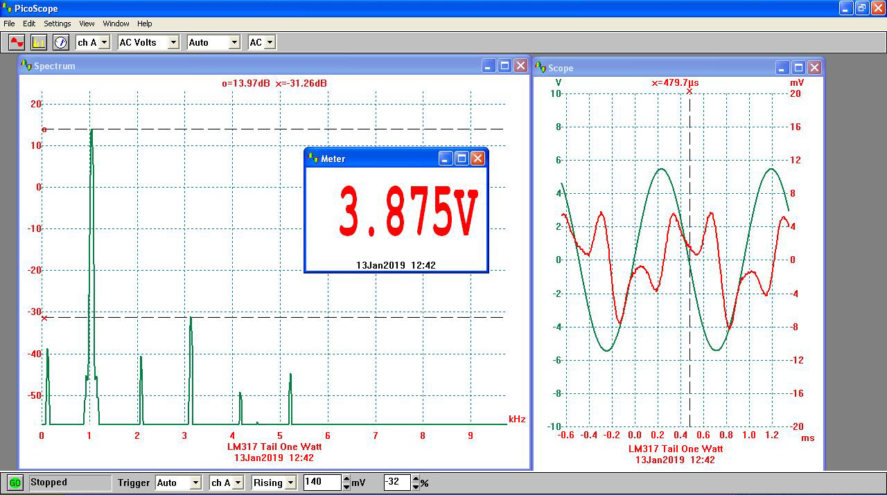

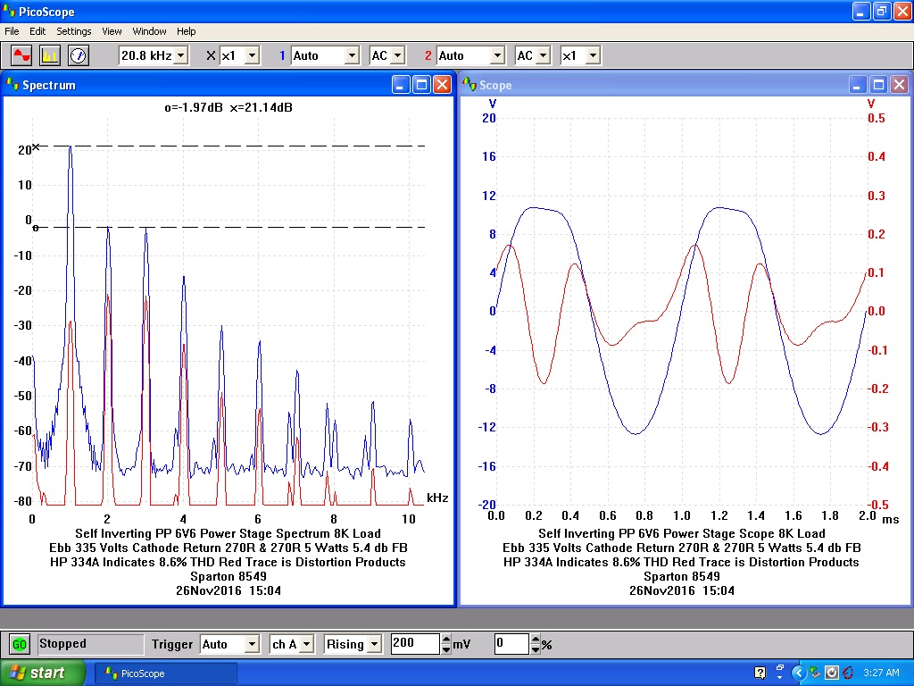

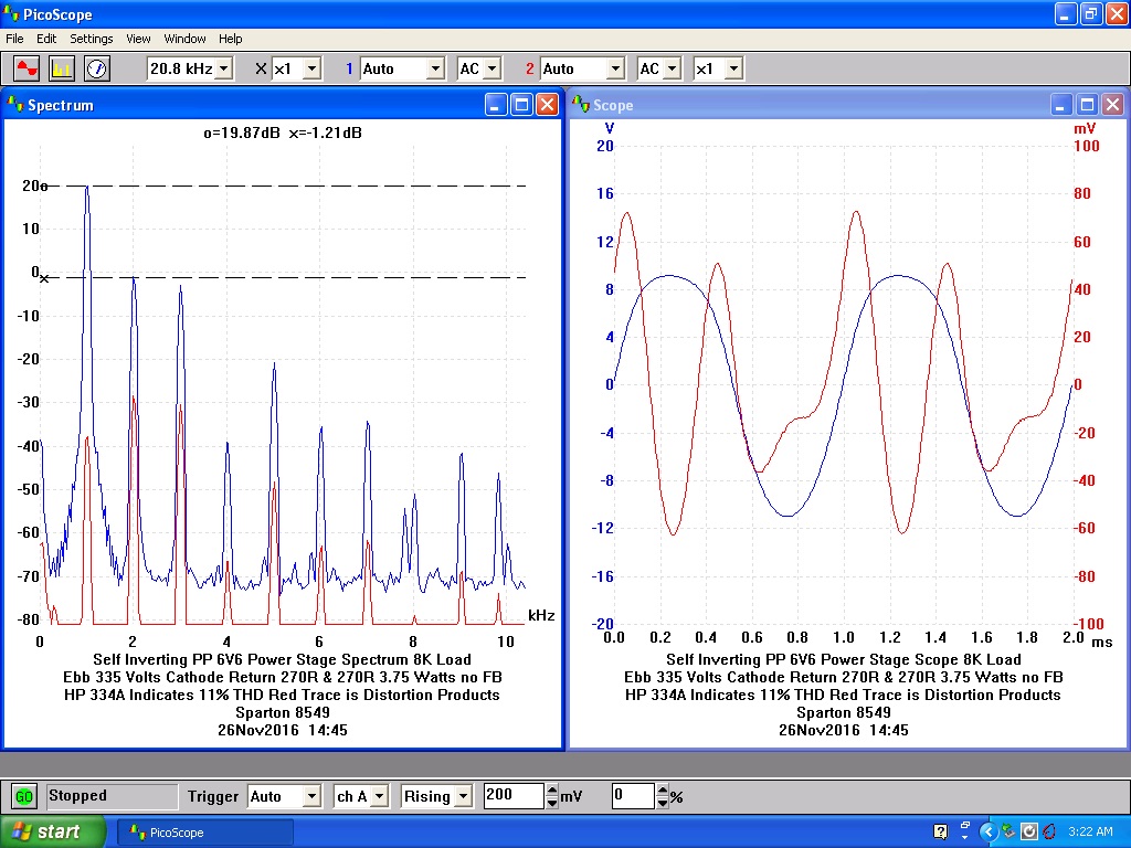

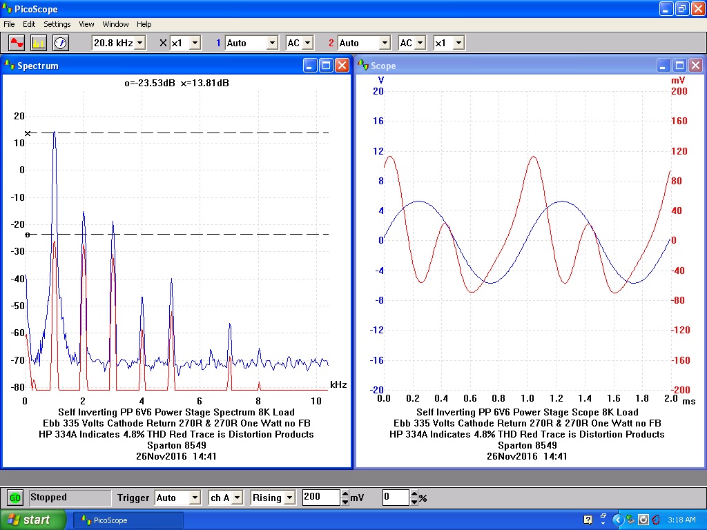

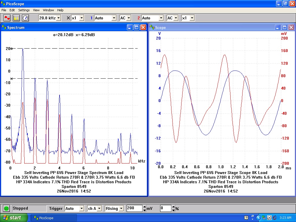

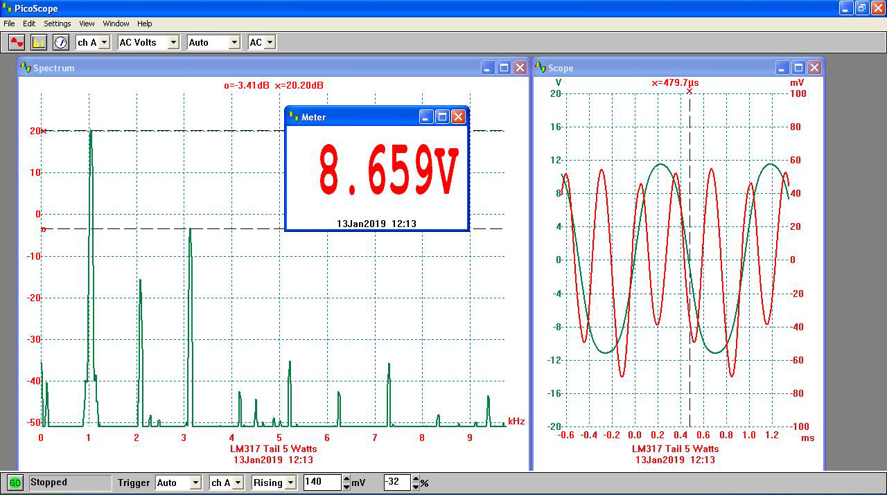

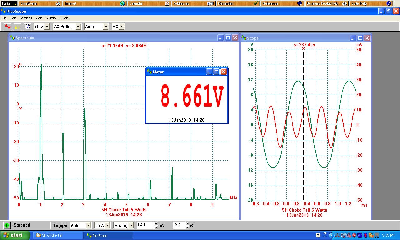

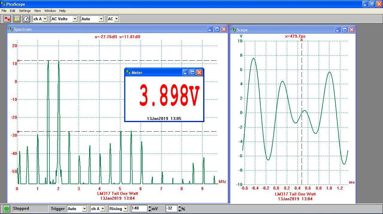

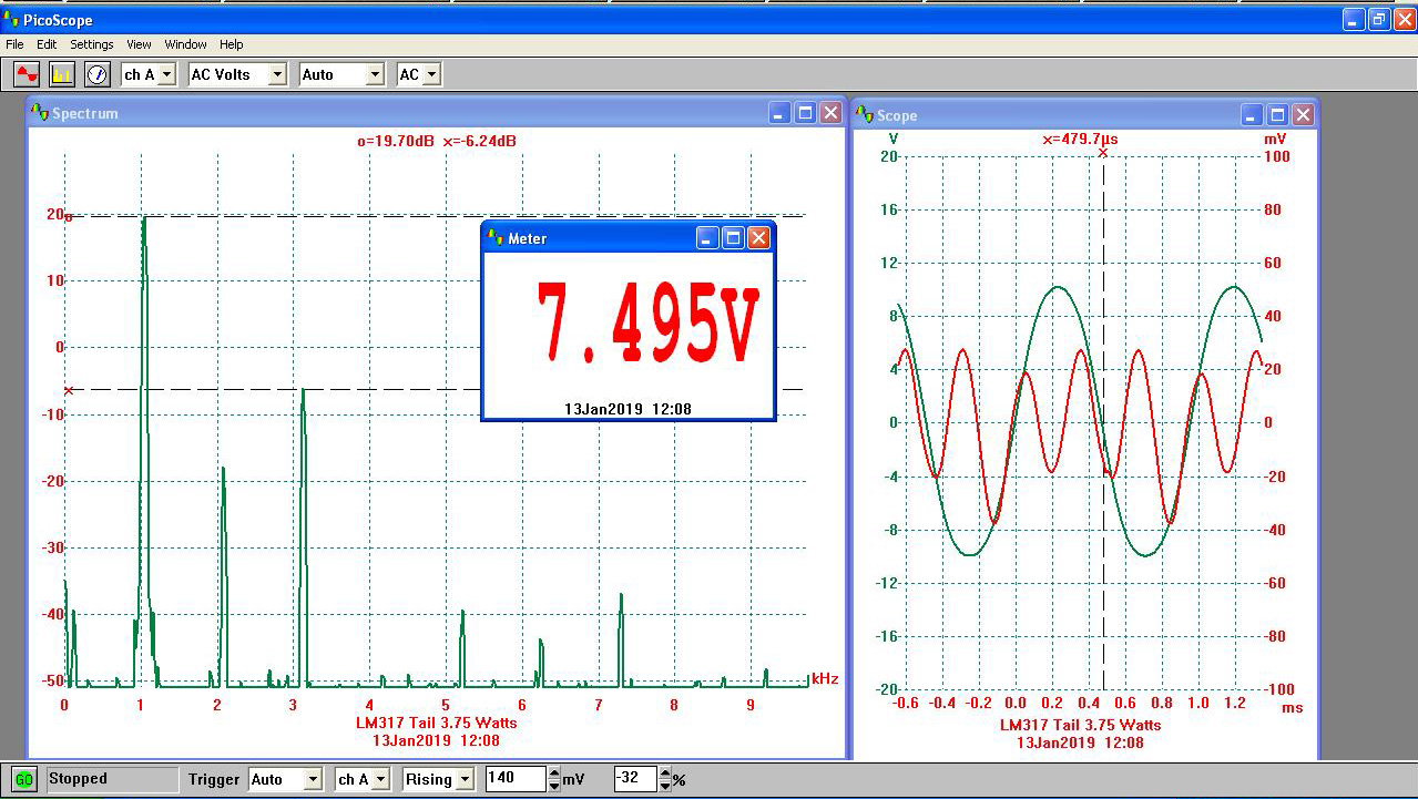

Here are some of the many results of the self inverting output circuit with PP 6V6s connected as in the Oddwatt. In this case the driver is a simple triode connected 6AU6. There is no NFB at all, these results are for the bare bones circuit. In no case could the circuit deliver more than about 1/2 what is possible while using a proper driver stage.
I did a summary of results that covered many of the earlier circuits back to the late 1930s, just gotta find it. I'll post more later.🙂
Hi, Others results differ however, not to get into arguements. The class A stage show is indeed limited to about 35% of the input DC power. That's a given. Using various tube combinations up to KT120s you can get as much as 40 wrms output. In various sizes the amps are a comercial product and work well. But you still need to realize they are class A and that does limit the output. With a conventional splitter and bias arrangement you can get a lot more output...if that is what you want. Many folks don't need it and like the forced class A operation. Different strokes for different folks.🙂
But much easier to get both power & fidelity while running Class A with several different versions of ordinary phase inverters.🙂

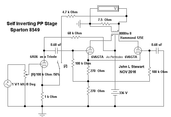

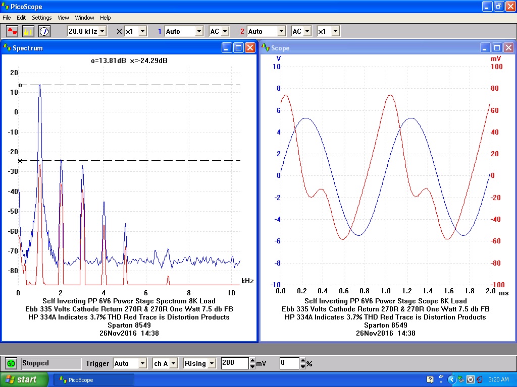

Sparton 8549 Consumer Receiver PP 6V6s
I looked at several attempts at the Self Inverting PP power stage, this is another from the mid-40s. The cathode resisters are 270R each. The performance is better than those circuits with only a single cathode resister. But still needs help. I tried limited NFB to further check performance. All here for your curiosity. Or not!!🙂

Some Miscellaneous Additional Info

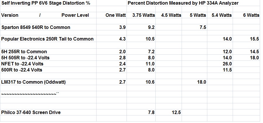

I found several examples of the Self Inverting Power Stage. Here is more info & a results table of some of the tests setup. I tried to get better results by terminating some of the tails on a negative supply, that didn't help much.
All the results are real measurements on the bench, not simulations. Test equipment included an HP 334A THD Analyzer, a MetraHit 29S Precision DVM & Wattmeter &Pico Technology 3224. The PicoTech Scope/Spec A has 12-bit resolution so dynamic range is 72 db, sufficient for most vacuum tube work.

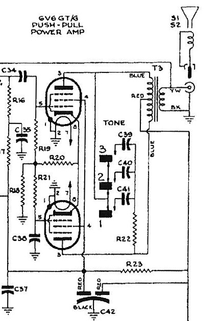

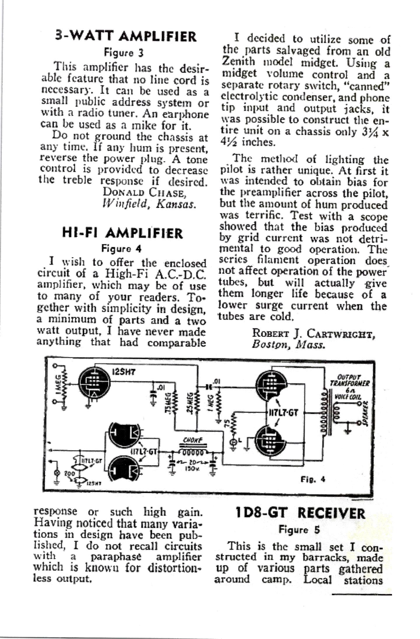

A very old example of the circuit runs a pair of 117L7GTs at WW2 time. Probably leftovers in a tube stash, parts were scarce.

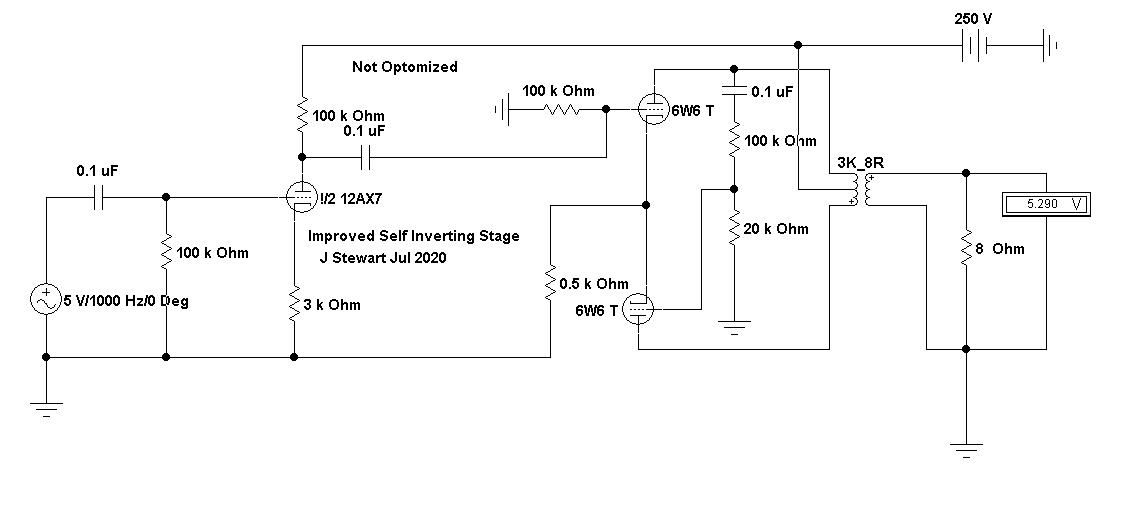

Improved ? Self Inverting Stage
I found this on the iNet a while ago. But haven't tried it. Looks like it might solve a problem, I found it was impossible to drive the second grid far enough negative.This circuit looks like it would do that. But the drive to the 2nd grid would have all the distortion from the other side. Still worth a look for the sake of curiosity.🙂
