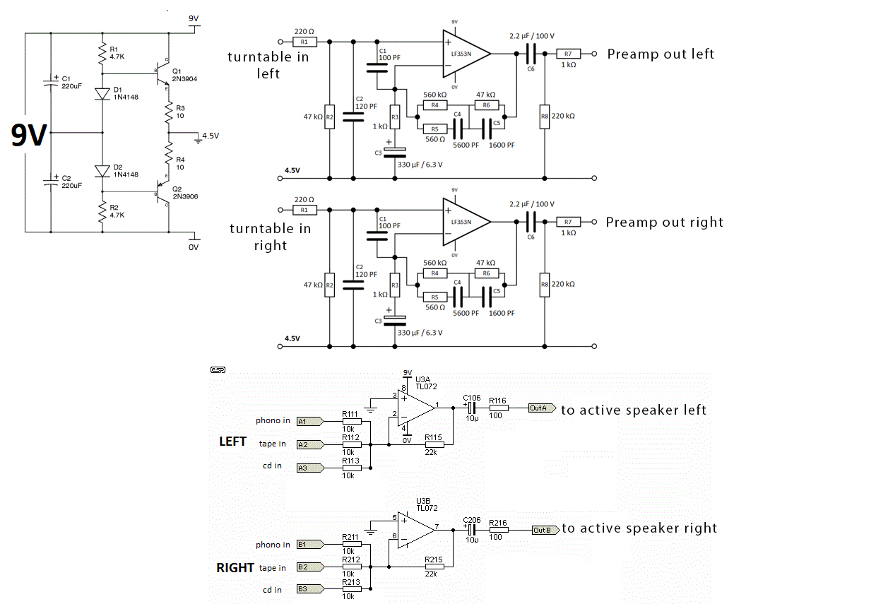

So, this is my final plan. I added a simple mixer in the end so as to fit everything in one enclosure. Tape player has its own preamp so I'll just add it directly to the mixing op amp.
Ι am also thinking to add a 3 position switch before the mixing amp so as to choose which player plays. But if I just add a 3 position switch is the final op amp necessary? can I skip entirely the final mixing stage?
The power supply voltage is too low. Of at least+/-15,and best of 18-20 volts and ramp NE5532 or OPA21604 . It is better to apply a passive correction
I asked about this and the answer was that even a +-3 volt is enough. Isn't that true? What will be the difference with lower voltage? As I said earlier in the post, shops are closed and I only have access to eshops and my stack. I don't have a NE5532.

If you're going to accept a tape player input from the earphone jack (up to 7 vac), you need at least a +-8 v power supply. So 18 v wall transformer. If a line level jack (2 vac), then +-3 is okay. I don't understand the passion for+-15. My disco mixer sounds fine, better than my vacuum tube PAS2 since I put *****y polyester caps in the PAS2 to replace the off value paper ones.
You haven't biased the inputs to the middle of the power supply, the virtual ground. I think the + input of the mixer op amp goes to virtual ground through 22 k, same as feedback resistor. Or 11 k for a gain of 2. There was a bias to virtual ground version of the mjf RIAA schematic.
You need volume pots on each input, shunting after the 10k to virtual ground. My disco mixer used 40 k pots.
You can have many more 10k inputs to the mixer op amp. I have 5 on my disco mixer, which doesn't hum or hiss. So you don't need a 3 way switch. Just turn on the one input you are listening too, and turn off the other ones.
You can use 4558 for the 1 gain mixer op amp. Only the 50x gain RIAA op amps need to be low noise, like TL072 or better 5332 or 33078.
Oh, gee, you did the RIAA with LF353. I think that is first generation, really hissy. Look at the datasheet, the noise value probably is higher than TL072. Noise value of 33078/5332 is even better. Note different impedences noise specs are measured at make them apples and oranges numbers. If you use a socket for the op amp, you can try different ones to see which is the quietest. I spent 2 years purging hiss from my RA-88a, which came with 4558 op amps and pretty serious hiss and hum.

So If I bypass the mixer and replace it with just a 3 position switch. So that I only choose which input goes to the output will it be ok? (so for the tape and cd player that have their own preamps it will be just connecting the input to output).

Ι get it. This won't be a problem for me. I live in a really small house (18m^2 to be specific) so changing the switch won't really be a problem. So I'll built my schematic without the mixer. As I said earlier most eshops don't have stock transformers and I'll try to do the best with my stock.

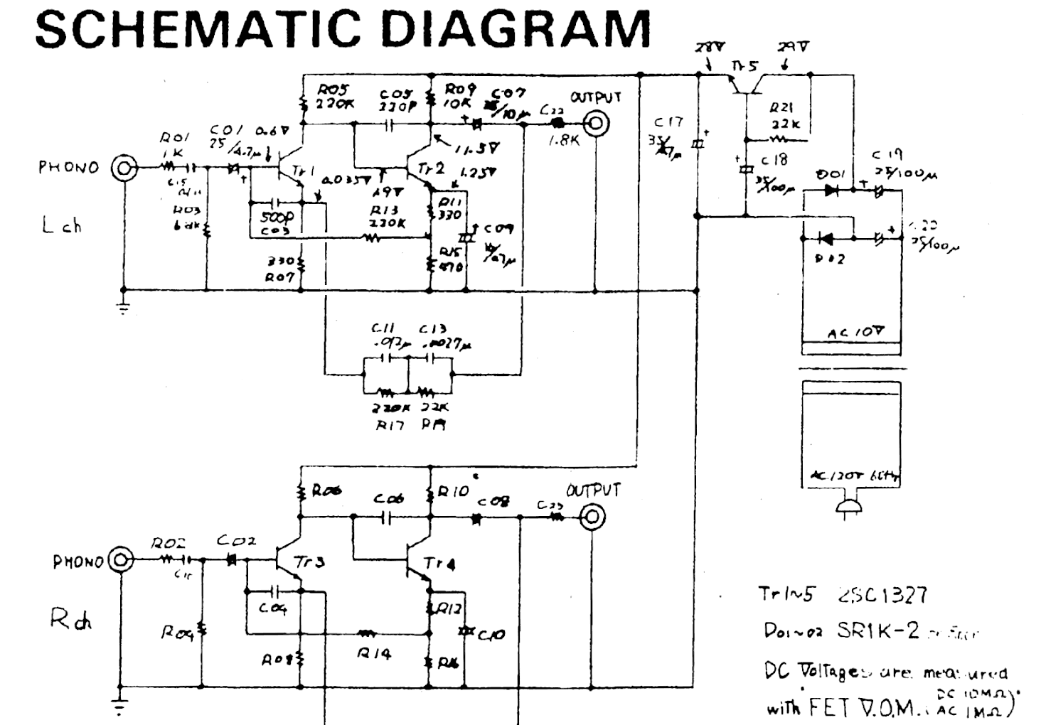

I found the schematic too!

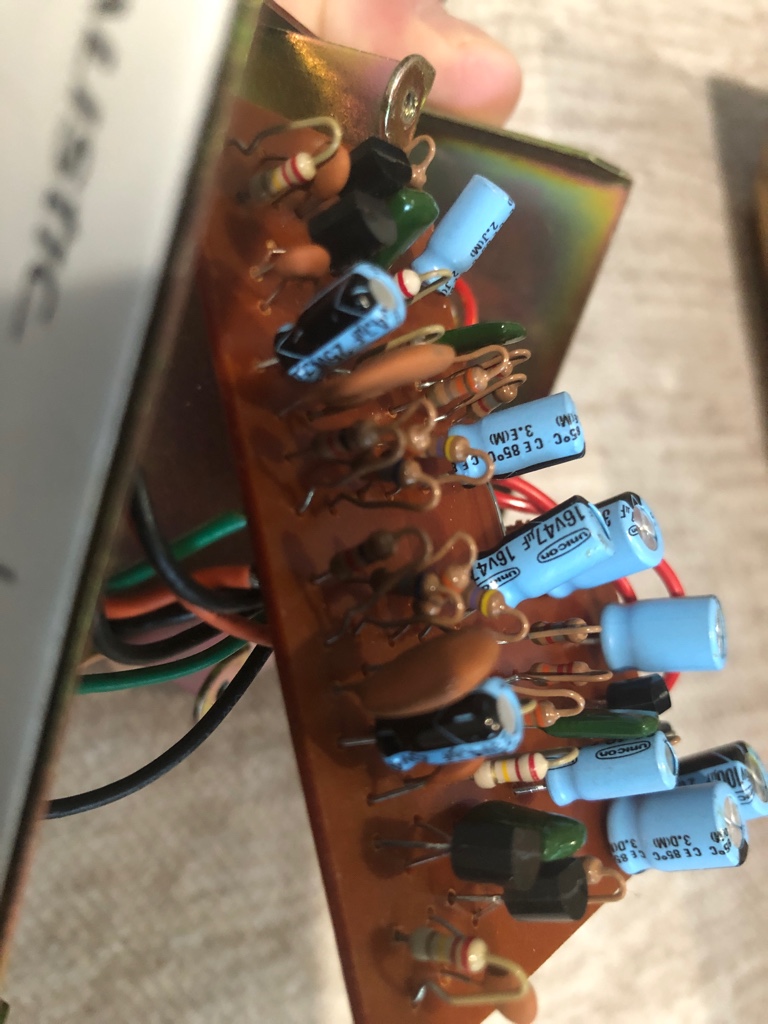

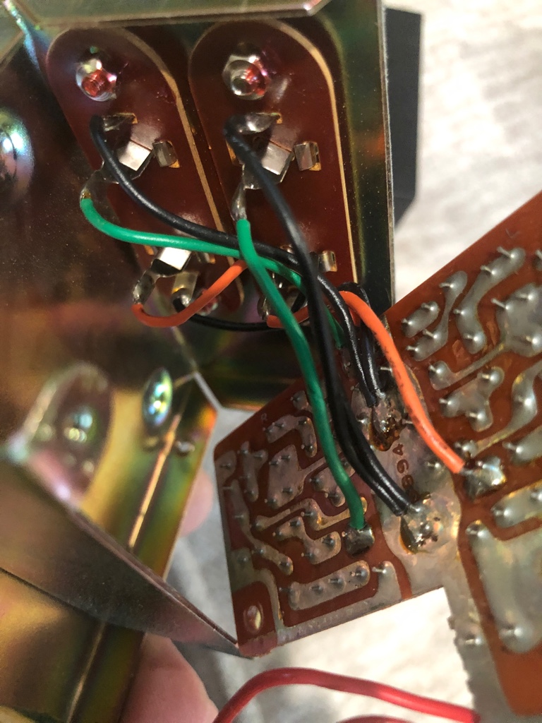

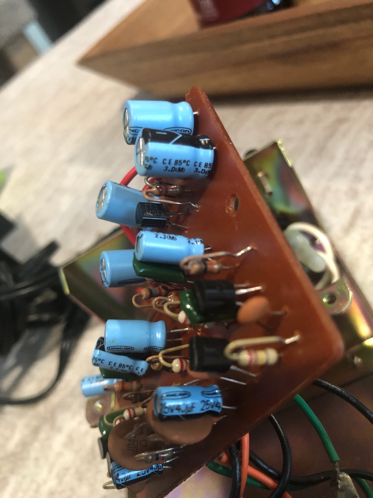

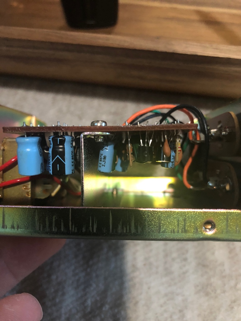

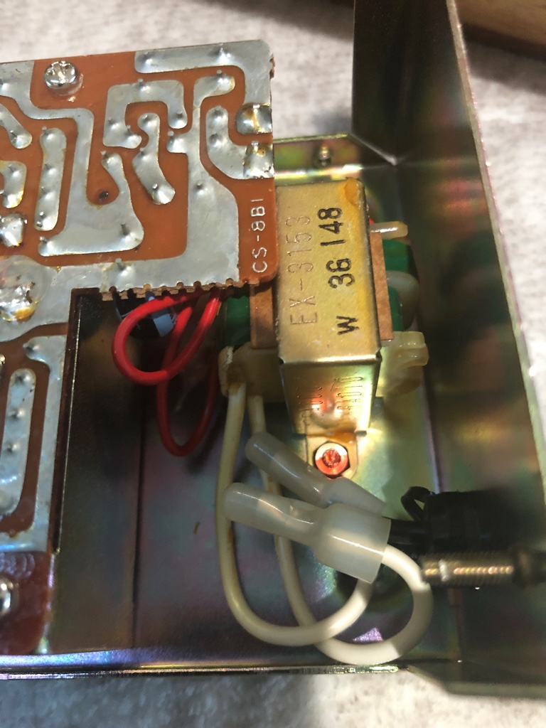

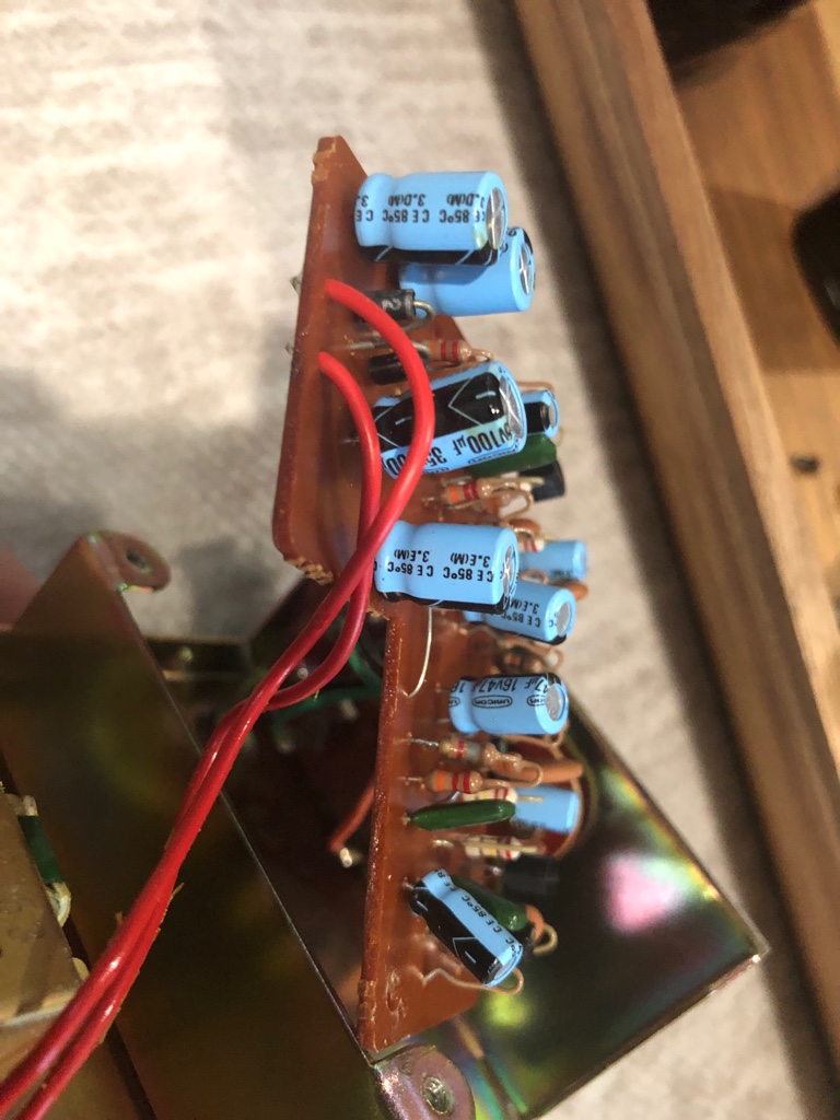

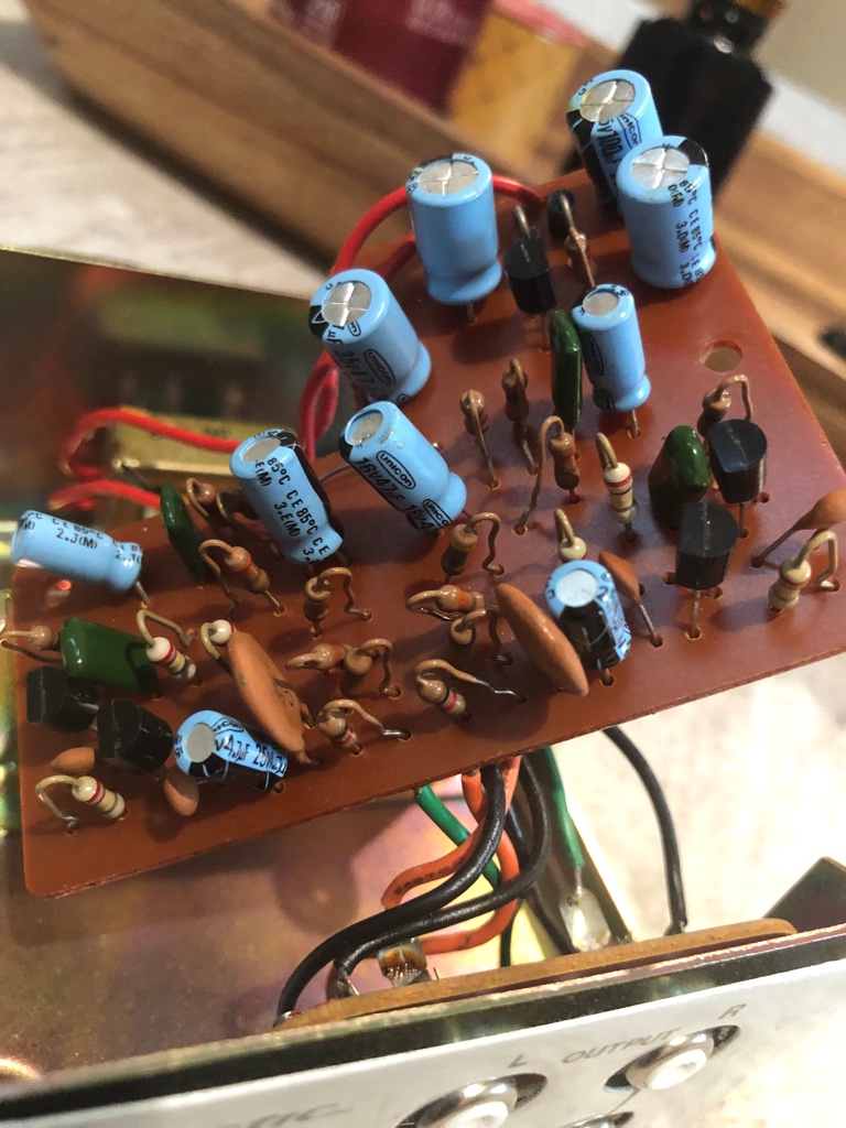

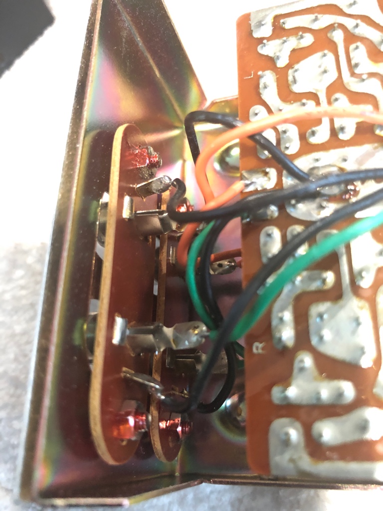

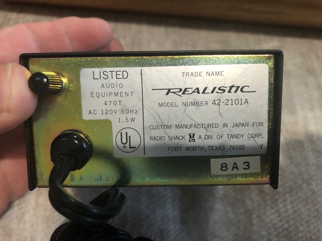

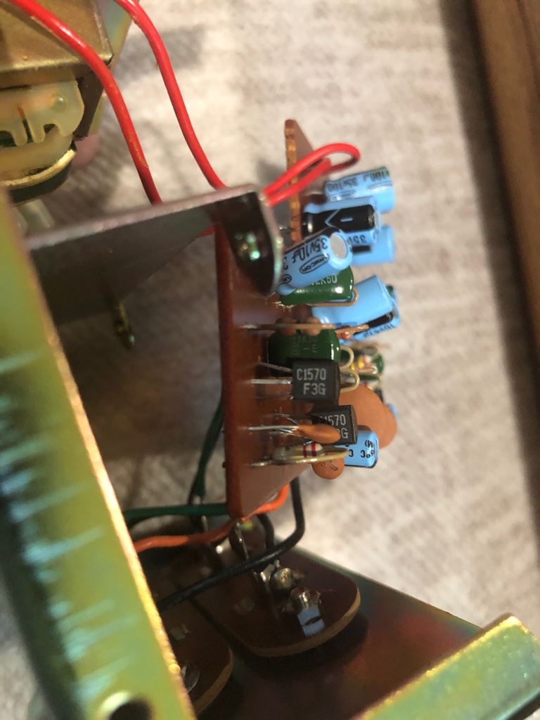

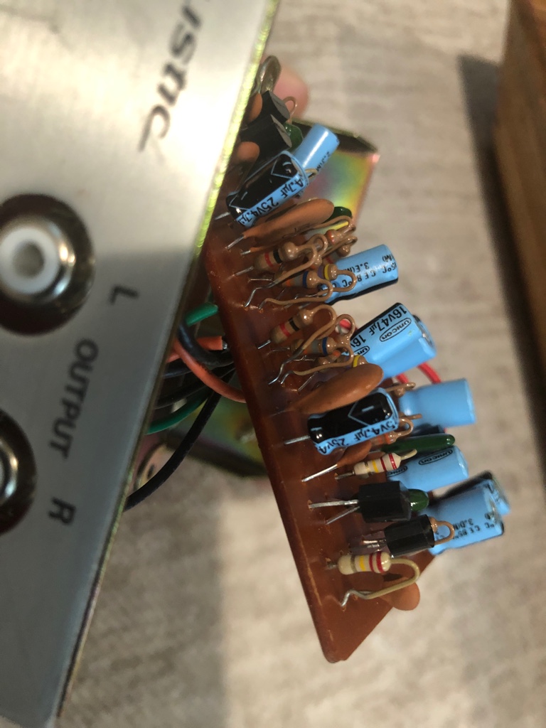

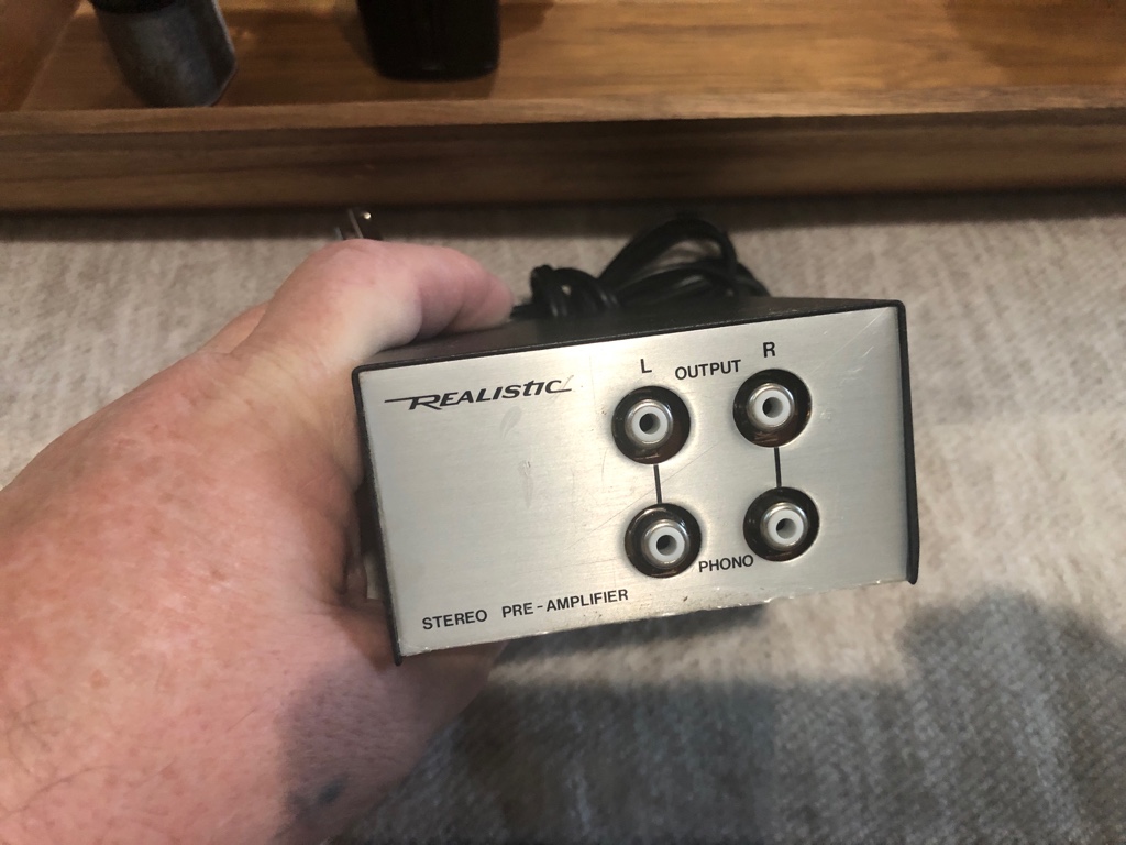

Here’s a few photos of the RadioShack realistic stereo hi-fi preamplifier Model 42-2101A.....
There is an older round-shoulder model which was a complete piece of unpolished turd. Not enough power, not enough gain, and reject-grade transistors.
The later square-shoulder model 42-2101A et al was almost decent. I have heard much better, but good for the price. They adapted the too-small power with a doubler for a good 28V supply. Bottom barrel transistors had got MUCH better in the decades between the two series, the 2101 was less likely to hiss like a dirty steam radiator. The RIAA EQ is about as good as it gets with 10%/5% values.
There is an extended discussion of the 2101 over there. Even perfboard layouts and SPICE runs.
Another factory scheme:
