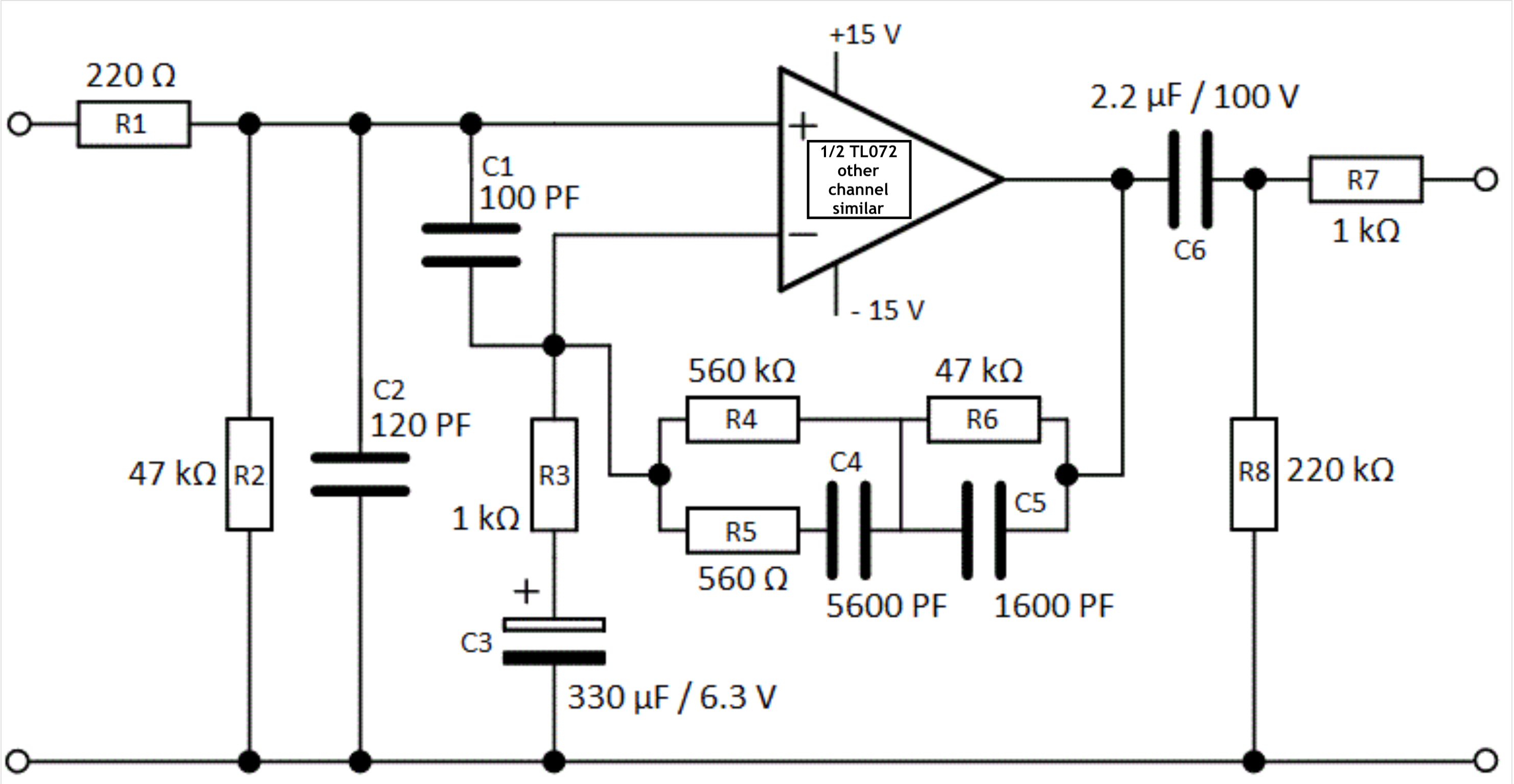

I just bought a used AKAI AP-103C turntable. I thought that I could build a phono preamp myself without doing my research before buying the turntable.
I am not really an audiophile I just want to listen to my records. Is there any simple schematic for a phono preamp?
The basic problem that I encounter is that most schematics need +-V and ground meaning that I have to use a center tapped transformer that I CANT FIND IN ANY ESHOP in greece. Shops are closed because of covid. So I only have access to eshops and my stock of components.
If it's possible I would like a TL072 schematic (because I have a couple of them). I don't even care if it has eq or volume knobs.
(I have experience from copying effect pedals so I can transcribe schematics but I am not that experienced in understanding them)
Thanks in advance!

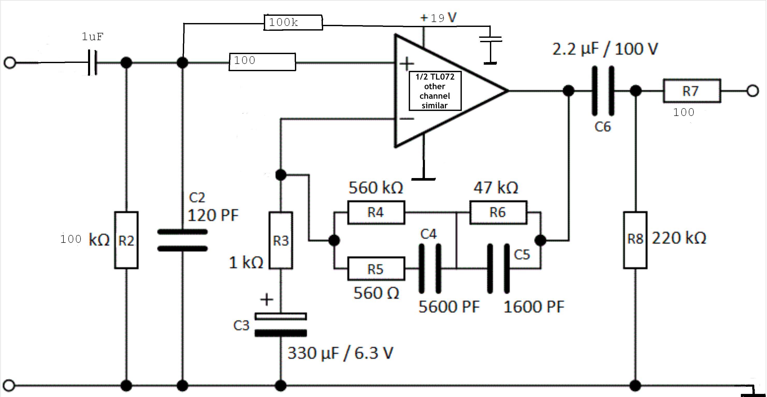

Here is a simple but accurate RIAA pre amp that you will find nice to hear.
It works from +- 6volts up to +- 16volts so not picky at all. With a virtual ground it will run on +12volts but dual rail is better.
Some questions:
I don't have:
1) 330uF (C3) caps. Can I replace them with 220uF or 470uF?
2) 560k (R4) res. Can I replace them with 510K?
3) 5.6nF (C4) caps. Can I replace them with 4.7nF?
4) 1.6nF (C5) caps. Can I replace them with 1.5nF?
5) 2.2uF/100V (C6) caps. Can I replace them with 2.2uF/50V?
I have all the basic values of resistors (x1, x1.5, x2.2, x3.3, x4.7, x6.8 etc) plus some x5.6, x8.2 and some random values.
I have all the basic valus of capacitors plus some random values and a few of in between values.

If you replace the 330 uf cap with 220 uf, you might miss a little bass. 470 uf it might be a bit excessive.Some questions:
I don't have:
560k resistor series a 47k resistor is pretty close to 560k.
4.7 nf parallel a 1 nf is pretty close to 5.6 nf.
1.5 nf parallal a 100 pf is 1.6 nf
Your 2.2 @ 50 v caps should be fine with a 24 v or 30 v power supply. Or less, even +12 or +9.
BTW you only need +-3 volts for a RIAA preamp going into an amp with 2 vac sensitivity for full volume. Op amps won't go closer than a volt or two to the rail, so I am splitting +18 race car transformer into +-8 v with two zener diodes to power my RIAA mixer. That gives me enough headroom to accept a 5 vac radio earphone output in the mix. +24 into +-12 is also doable. Look for wall transformers for old hedge clippers or radios or whatever. I find them at Salvation Army charity resale shop for $1 or 2. You need at least 100 ma, which is way below what most of these put out. Notice at below the rated current, they put out about 40% more than the rated voltage. You do NOT want a wall device that is a switcher power supply - those don't weigh much.
The TL072 is pretty quiet, better than a 4558 at 50x gain. ST33078 or NJM2068 would be even quieter, but would need a 33 pf cap parallel the feedback network to prevent oscillation. Also 100 nf disk caps across the power supply pins within an inch of the high gain op amp. I used one 100 nf cap for two op amps, no oscillation. MC33078 or NJM2068 are $.33 to $.50 but if you ordered some they might get lost in customs.
Happy building.
Do you mean 4.7 nf parallel a 1 nf is pretty close to 5.6 nf ?
I thought about those combination. If I am not wrong even the tollerance of this components makes the afforemantioned combinations acceptable.
I apologize, I edited out my error after you read it.Do you mean 4.7 nf parallel a 1 nf is pretty close to 5.6 nf ?
Yes, your parts are probably 20% tolerance so if the combo comes in 10% high it is probably no worse than anything else. If you have a cap meter, probably all modern 20% parts are 18% low; that's how precisely they make them now.

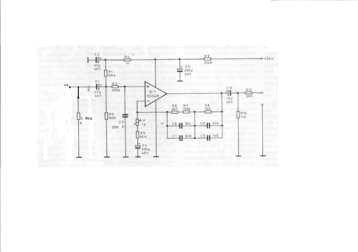

Ι'll try this if the first one fails. Is there a replacement for this IC?single supply phono pre.......
Thanks for your response. I posted a split rail schematic in the beginning of the post. Will this work combined with the preamp?I edited out my error after you read it.
Mjf's schematic will also work with half a 5532, which is perfect for stereo. 5532 is another quiet op amp, so cheap that it is not counterfeited. Uses a little more milliamps power than the TL072.

Oh! That's really helpful.
I would like to ask one more thing. The Op amp operates at a range of voltage. Is it possible to use eg. 9v power supply ? (like those I use for my guitar pedals?)
See post # 10. Yes, 9 v will work split to +-4.5. 6 v will work split to +- 3. You only need headroom for 2 v signals out to your power amp. Ie 1 to maybe 1.5 volts off the power rail for all the signals in & out. The input voltage is about 50-100 mv, nothing.I would like to ask one more thing. The Op amp operates at a range of voltage. Is it possible to use eg. 9v power supply ? (like those I use for my guitar pedals?)
