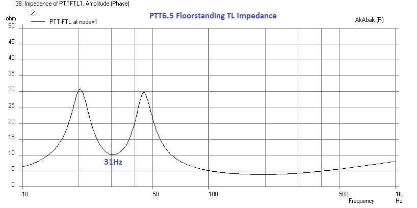

Hi MainFrame99,

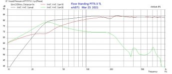

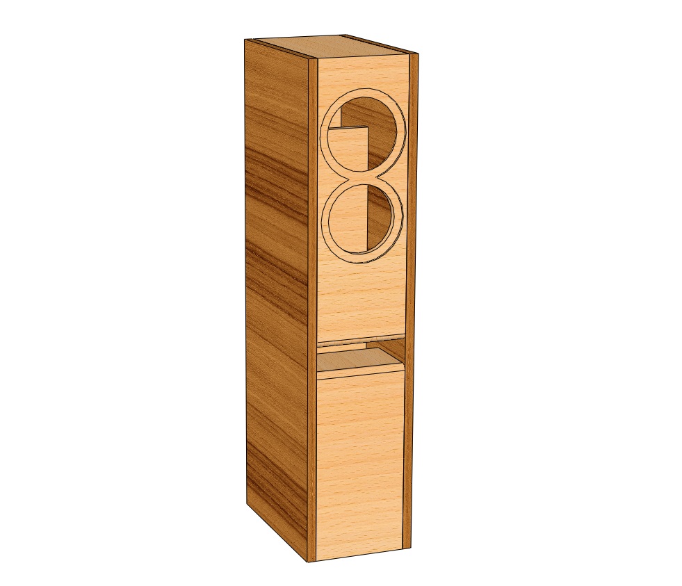

Yes, I have a floorstanding design - it has been fully simulated in Akabak and CAD plans have been drawn, please PM me if you are interested in the full plans. It uses all 3/4in BB plywood and is 40in tall x 14.25in deep x 9in wide (external dimensions):
Without room gain, and after baffle step loss in 4pi space, the speaker has a nominal sensitivity of about 84 dB and a -3dB point is 40Hz and -6dB is 29Hz.

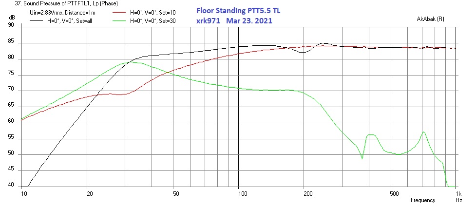

Here is the predicted SPL vs frequency - it is designed with a smooth rolloff that will integrate with a room's modes to give a nice response down to 30Hz:
Here is the predicted impedance curve which shows the tuning is at 31Hz:
It is designed with the PTT6.5 woofer on the top and the tweeter below it (RST28F with WG300 waveguide for example). If you want to use it with another tweeter, that is fine too but you will need to design your own XO or go with active DSP amplification.

Different designs. The floorstander is larger volume and will play a little deeper and smoother.
I am not aware of anyone else bothering to sim it in HR since I have already done it in Akabak, which is probably more comprehensive, and hence more accurate. I am not sure how to simulate variable damping in HR as that is critical to getting this TL properly tuned.

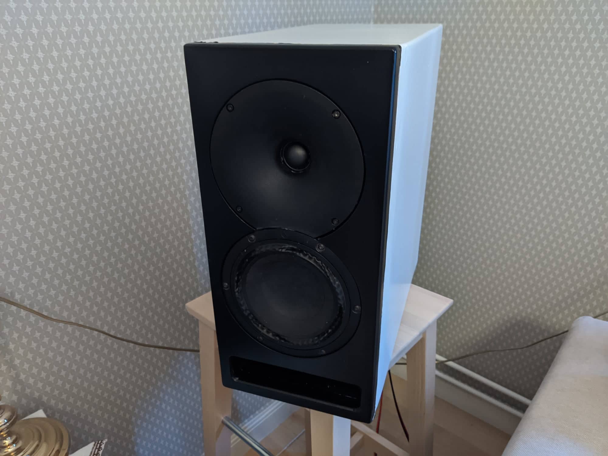

I have thinking for a long time to fix the ugly MDF so I put on some vinyl and glued the front baffle with epoxy, was not sure it would be enough surface with the overlapping vinyl on the back side.
I must had some leakage on the baffle with screws even if I had some sealant.
My EQ in nanaDigi just sounded to much in the low end so I had to remove the low shelf filter.

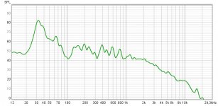

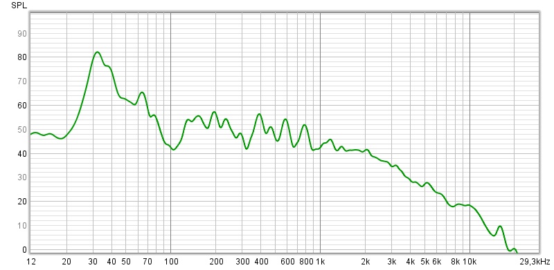

Here is an RTA measurement at listening position with the 30hz song in post #321.
65db only EQ at 44hz where the room peaks and high shelf.
So the baffle got tight and I gained some low end.
I'm happy!
I mean that's good but I am a little surprised.
I'm happy!
Nice work, Solve! So do you think it was a small pinhole leak somewhere? I can tell where your bass is now relative to what you had before?
Yes it must have been a leak somewhere I did the candle light test but it's only
possible at outer lines so maybe the port wasn't tight.
So I recommend to glue the baffle.
