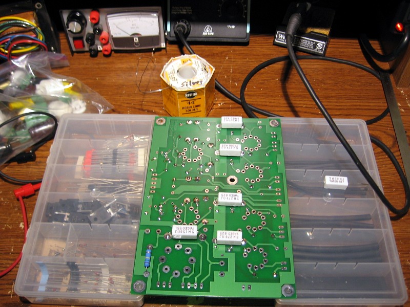

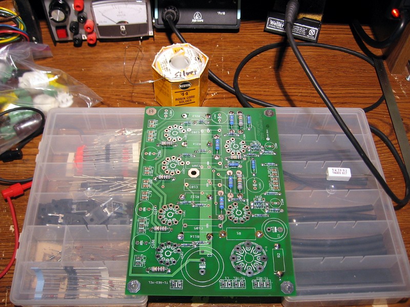

Had a bit of time to stuff the resistors this evening. I followed along with the bottom assembly procedure and didn't notice any errors, though I put resistors on both sides for various reasons. The only comments are really for beginners:
Swapping R2 and R4 seems like the easiest error to make. You do mention it at the beginning, but maybe it's worth using a slightly different R2 value?
It might also be worth it for soldering novices not to solder joined pads until both parts are in (R110 and R111, for example).
Identifying resistors by color code is a good exercise, but the precision resistors might be confusing for some since it is not always obvious which way to read them (1.00k, for example). I've also seen some (not these) were it is hard to tell what the colors are because the resistor bodies are so dark (red looks like brown, etc).

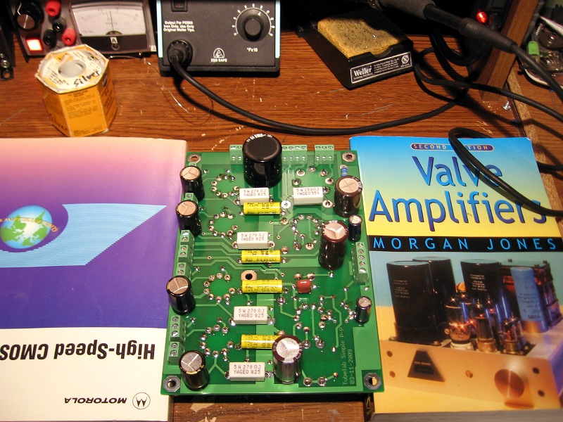

The board is stuffed. A few discrepancies in the parts list for the caps:
C100/C200 are listed as 1000uF@16V but the supplied parts were 1500uF@6.3V. Looks to be the bypass cap for the input tube section cathode, so 6.3V should be fine I expect. Might match the cap in the pictures, but it's hard to tell.
C102/C202 are listed as 47uF@450V but the supplied parts were 82uF. Looks like it matches the picture, though.

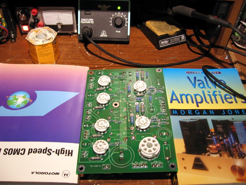

I was a little weary of standing the noval sockets on their toes to align them with the octal socket. The tips barely reached the top surface of the PCB. I opted to seat them fully instead. I remember doing this for the SSE and TSE, but I don't remember them being so close to the edge. Maybe it's because I used Belton noval sockets on those?

The first 3 amps I built, and the first few parts kits that Sherri put together used the values that you have. They were based on components that I had in stock. I have since ordered 50 sets of exactly the parts shown on the parts list. I retrofitted 2 of my boards which are being used in the dual mono Simple PPP amp. I have also built 2 more boards, which have been tested, but not assembled into amps yet. Many of the pictures were taken using boards built last year.
The board with the tube sockets standing on their tip toes has been doing duty as my tube tester / tube matcher. I have stuffed about 50 6CW5's through this board, often multiple times in order to come up with 6 sets of reasonably matched tubes. No issues were seen with the sockets.

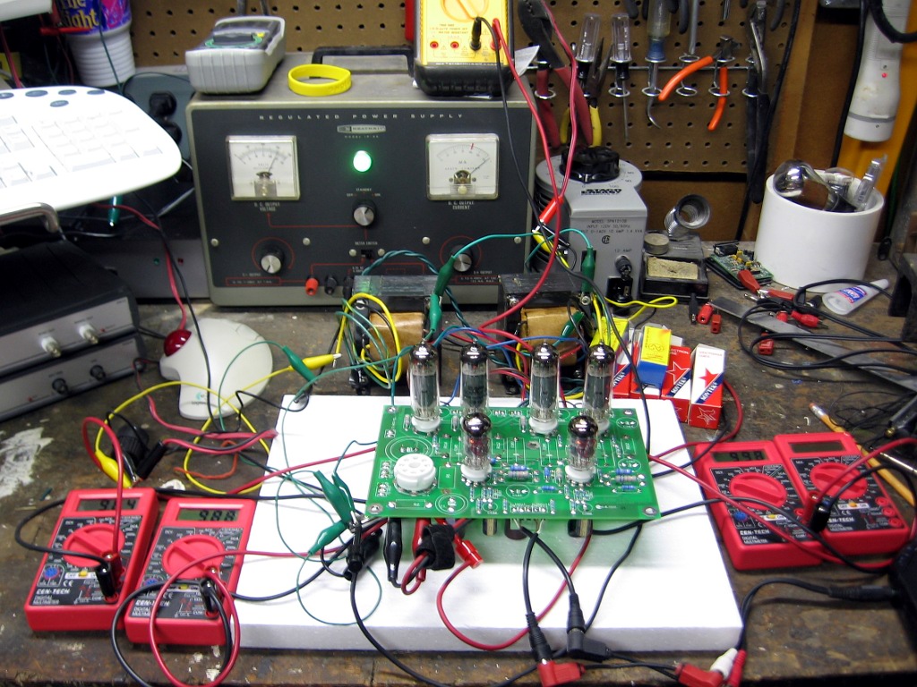

I'll put it on a "proper" breadboard sometime soon and try it out in the other room on some good speakers. I have a power transformer or two for this thing somewhere. I know the one from the abandoned "Bevois Valley" amp will work, if I can find it.
I just thought you might like to know that it works just fine. No issues at all.

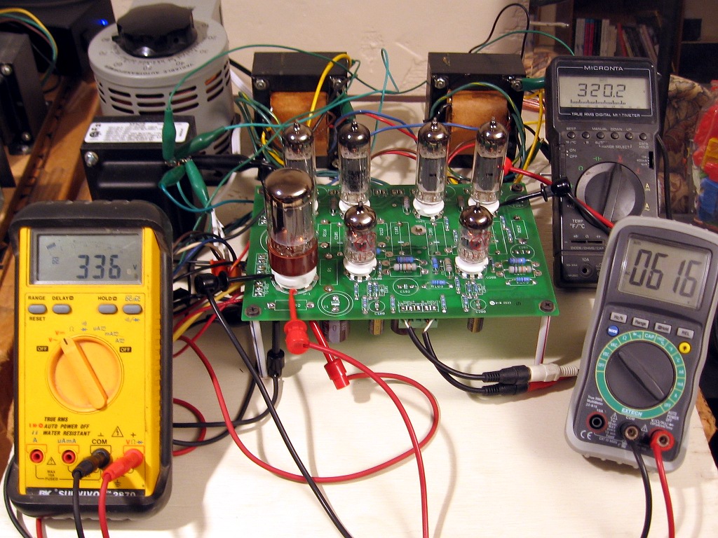

Here is the amp on a breadboard. I found a Hammond 373CZ, which will do 650VCT @ 173mA. Since they have a reputation, I brought it up on a variac and could not get to line level without reaching scary plate-to-cathode voltages. I stopped at about 77% (85% is line-level) in the attached picture. It shows B+ on the left, the HT winding at the right-front, and the plate-to-cathode voltage on V201 on the right-rear meter. The primary is wired for 120V operation. It seems that this transformer is too hot for this amp. I wanted to point out that at least in my case, 615VAC under full load is the max I would put into this thing. The XPWR131 is probably not a good choice either. 600VAC seems like it would be safer.
Comments after being attached to my 98dB speakers: the amp has some 120 Hz buzz, but I am not surprised. I think the Simple SE was similar before I put the choke on. The amp also has some hiss with the inputs shorted, but not much. Less than my ST70 I would say. However, the amp has a lot of GAIN. I hear lots of noise from my SqueezeBox that I don't hear with my other amps. I had to turn the SB volume way down. It is directly connected, so it may be quieter through a real volume control.
I didn't listen to it long...just a few tracks. The noise from the SB was bothering me. I hate audio adjectives, but my initial impression right off the bat was that the amp sounded "fast". A couple of live tracks I listened to had good detail and good imaging, so I was happy about that (the ST70 lacks both). The bass felt laid-back, which surprised me a little. George, I am using the black and yellow wires on the OPT secondaries as the 8-ohm taps. The other two wires are left disconnected. Is this right?

OK, that might explain the weak bass. Also, it occurred to me that I don't have the NFB connected, so that would explain at least some of the excessive gain. I have two little blue caps that were in the bag. I can just try those and see what happens.
Need to hook it up to the scope next.

This is correct. Assuming an 8 ohm speaker, use the black and green/yellow wires with EL84's (6600 ohm load) and use the black and green wires for 6CW5's (3300 ohm load). The yellow wire does not get used. These OPT's are somewhat ugly but the cores seem to be a common size. This allows the reuse of end bells salvaged from other transformers. I ripped the power transformers and tubes from several HP audio oscillators that had been sitting outside in the rain for years. The tubes (6CW5's) have found use in my amps. The end bells from many of the power transformers have found their way to these OPT's and a repainted pair can be seen in the 6CW5 amp on my home page.
Make sure that the black wires are connected to the grounded feedback terminals (one terminal block is backwards from the other). Swap the blue and brown wires as needed to insure negative feedback.

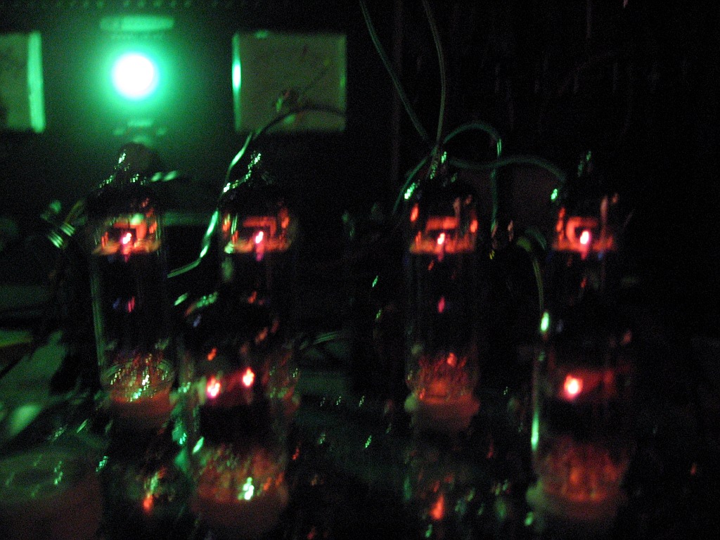

I have come to the same conclusion. This trait has been shared with several of my other amps including the "red board" and the 300Beast. So far the only thing these amps have had in common is the OPT's. I have ripped one of these transformers apart to discover that they are constructed completely wrong by audiophile standards. There is NO interleaving at all and the core material looks identical to my Schumaker battery charger. I have the spec sheet somewhere. They are rated for "80 VA" from 80 Hz to 4 KHz. Yet they sound and measure quite well. I have also proven that they will pass over 200 watts at 1KHz, but no more than 20 watts at 25Hz.
