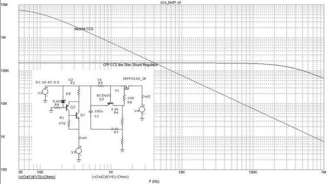

Btw, R15 in your second circuit will work as intended. Now the zener noise is filtered and the opamp inputs get almost equal impedance in both ac and dc. I asked if you have simulated the performance of the CCS alone, ie impedance against frequency.
Please show me a sketch of the schematic, parts, values, and I'll run the sim, no problem.

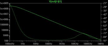

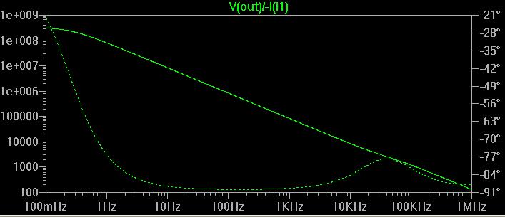

Not at all. If you noticed, my circuit does not use a "follower" as parallel element, but it tries to provide some extra loop gain there. This means a N channel MOSFET instead of P channel and the opamp is flipped. Such a configuration provides at least 6dB of improvement in both output impedance and line regulation, at the penalty of a small reduction in the phase margin.
OTOH, OPA627 is not the best in such an application. I think I already mentioned, it may not have enough +/- output swing to correctly drive the MOSFET. Also, the bandwidth of OPA627 is limited, leading to suboptimal HF performance. LT1115, THS4031 or even LME49710 will do much better. Even the noise will be better.
The "weird" cap provides even more loop gain, but then you don't need to like it.
I meant the CCS part of your regulator.
I'm at a loss. Can you write it as V(part_number)/I(part_number) ? I just don't know which CCS you're talking about, sorry.

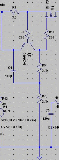

ikoflexer said:Ah, oh, , what's up with me. Thank you guys, here it is, much like the one Rafal posted.
BTW, does anyone have the Stax regulator schematic handy? Could not find it yet.
Not sure what you are doing in your sims, but for measuring the impedance at a node you need to set all other AC voltage and current sources to zero, then inject a 1A AC current in the node you want to measure the impedance at and read the voltage across this current source. This voltage is numerically equal to the impedance at the injection node. No calculations are required. Sweep the frequency, of course.
