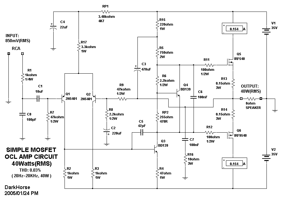

here is schematic of mosfet ocl amplifier,not my design..
THD <=0.03% full output,I want to build one..
everybody had try this circuit?

deleveld said:
What is the point of r3? It doesnt do anything at all.
Why not use a current mirror for the LTP. It will almost certainly lower THD and increase slew rate.

Hi,deleveld:
somebody suggest R3 should be add,they said it will make the circuit work more balance...So I do..
as the title named "simple",this is the basic circuit of the complecity struture you say so..least device can be gain more fidelity..I think
and also suitable for the people who hated trouble like me,because it is much easy to do and don't need more component..

Graham Maynard said:
Hi Darkhorse,
Don't forget the output stage Zobel network that will be necessary to stop a real world construction of this amplifier from chasing its tail.
Cheers ......... Graham.
Thank you!Mr.Graham Maynard.
the output stage zobel network must needed!I miss..
and also input stage need shunts a small capacitor 100pF..
so sorry for my untight manner!forgive me please.

DarkHorse said:
Hi,deleveld:
thanks!
Whoever told you that is wrong 🙂 It *looks* more balanced, but in electrical terms it is not. There is no way you can get the currents in each leg of the LTP even remotely close with two resistors like that.
Take out R3 and then adjust R2 until the current flowing in each leg of the LTP is as close to equal as you can get it at idle.
You also need a small (22-220pF, determine experimentally) capacitor across Q3 base-collector otherwise you will see oscillation when you build it.
And I really think you need to make R5 and R15 equal. Simulation results are not always real 😎
I believe this is a common mistake. People think because it looks on paper to be more balanced, then it is. In the books I have read and amplifiers I have built they don't have a R3.
My understanding is it will still work with R3 but it will have more distortion.

I've heard it 'equalizes' R*Cmiller time constants in LTP, sounds sensible but I'm not sure about real profit.
I don't know if I am right, but this amp seems to me low open loop gain and no frequency compensation,
.... aaghh someone suggested a zobel-don't know if this would be enough comensation

You guys don't have a clue.
"larger value(10uF) may
casing more distrotion.."
The suggested Miller cap was 22~220pF, 10µF is only 500,000 times the value recommended.
Multi Sim will not tell you how big to make this cap, it can't. You have to build it and they find the actual value from the actual layout with the actual parts.
"about R5 and R15 should be the same value:"
You could replace R15 with a diode if you wanted to, it does not have to be the same value as R5.
"R3"
Would need to be the same complex impedance that is seen at the base of Q3. Since this varies with frequency, temperature, and load, it is never going to happen.

richie00boy said:
10uF across Q4 to shunt/lower impedance is OK. However, I was talking about Q3. Here 22-220pF will be required. As djk says, you will have to build it to determine the value.

My mistake, when you said "should I shunts a 100nF capacitor to Q4 as buffer?" I thought you were talking the Miller cap which goes from the base of Q3 to the emitter of Q4.
A bias shunt from the emitter to collector of Q4 could be in the range of nothing to several hundred µF.
Too small of a cap and the signal can modulate the bias, if a large cap is used it must be of very high quality or the treble will suffer.
I frequently use 2.2µF with about 10mA in the VAS.

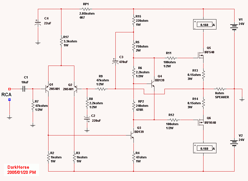

good bay,everybody:
I have modify the circuit diagram according to what we had refered,I chang the PS voltage from +/-24V to +/-35,this can casing the amp output more linear in high voltage supply.and you
can use your transformer with 2*AC18V~25V to get +/-DC25V~35V.
you need to meter the output terminal's voltage is 0V through adjusting RP1(set to middle at first) and RP2(set to MAX at first).
with high voltage power supply,it's output power from about 20W(+/-24V,8ohm) up to 42W(+/-35V,8ohm),more suitable for household audio device,is it?
note:Q4 should contact to heatsink where is near to Q5 or Q6,this is good to Iq stabilization.If your loudspeaker impedance is 4Ohm,I suggest use lower voltage supply(=<+/-30V).
any comment please?
