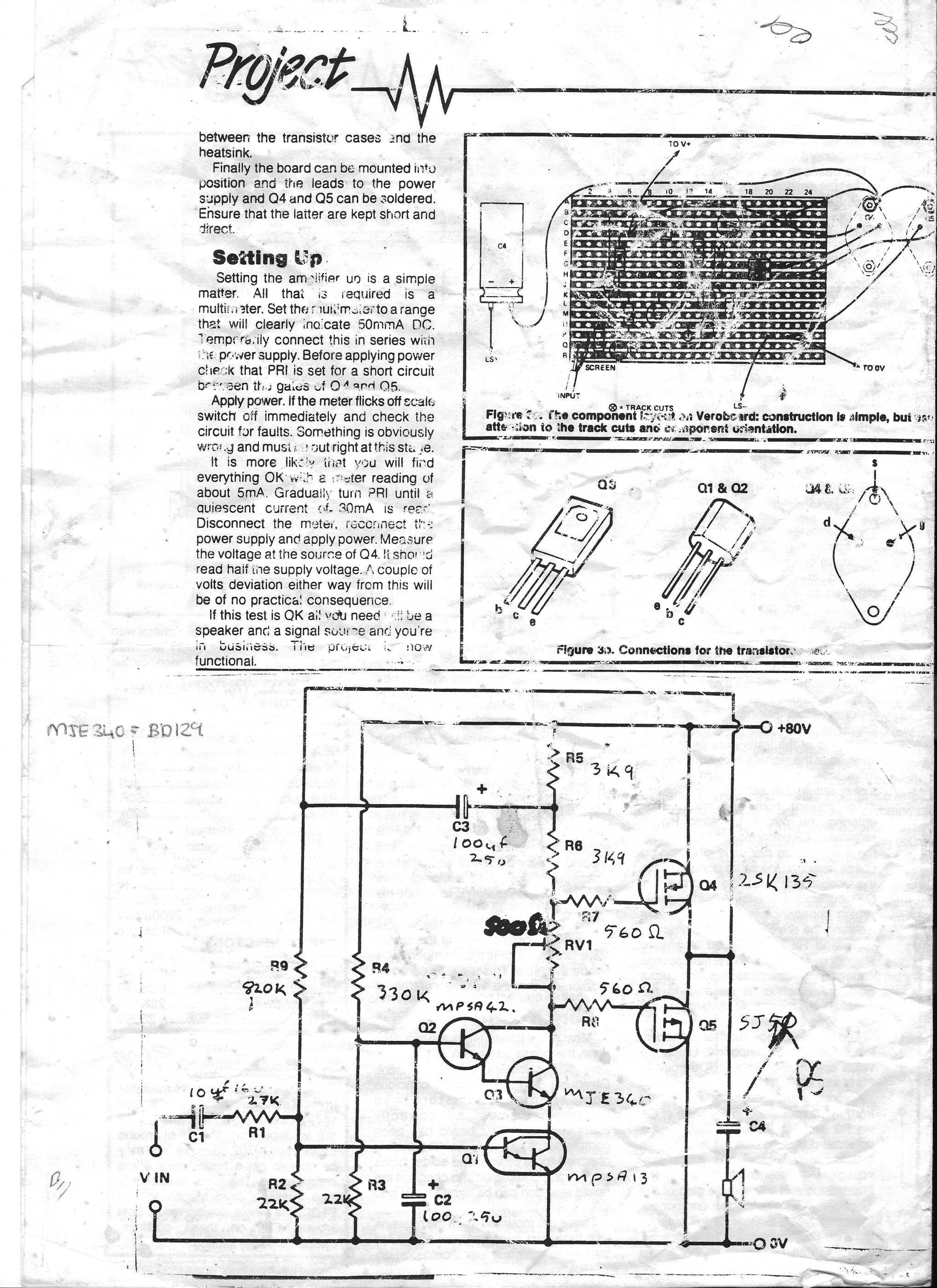

S speedy6963 Member Joined 2012 2021-08-06 7:06 am #1 2021-08-06 7:06 am #1 Should I build this, I am trying to make something simple that will play well. It sims well in Microcap. M1 and M2 are LND150 mosfets M3 and M4 are Exicon double die lateral mosfets. R7 is bias adjustment R8 adjusts offset Attachments 2021-08-06.png 400.1 KB · Views: 218 Bruce@bluff Member Joined 2005 2021-08-06 7:35 am #2 2021-08-06 7:35 am #2 I used this circuit to run my mobile for years. I doubled up on the fet's 2sj162 and 2sk1058 never gave me a days trouble Attachments 80 Watt mosfet amp.jpg 834.6 KB · Views: 214 You must log in or register to reply here.
