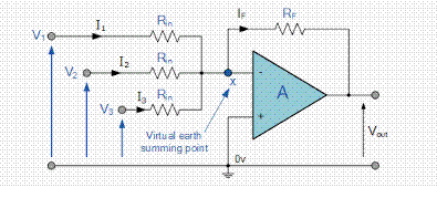

Any inverting amplifier will perform good as summing amplifier, from a high mu triode to the best op amp. Only need a kind of supply (single or dual), a couple of resistors and pots for each input, and a only one resistor from output to input. The ratio between them will give overall gain.
So use 5532 if you like. Op amps are op amps basically. You will read threads about who prefers what type, but thousands and thousands of mixers are on the market based upon basic TL072 or 45xx series op amps. If you see a dual op amp of say the OPA series, the circuit would also work with a TL072 or 5532.
