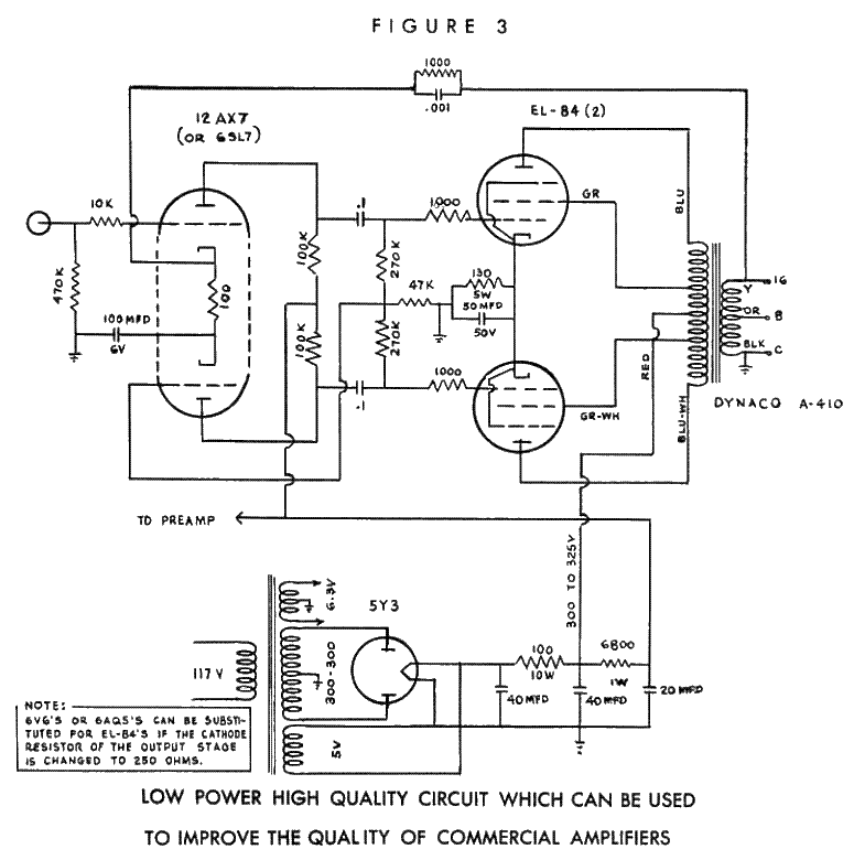

I'm building the attached design into a recently cleaned out Magnavox console amplifier. How would I adjust the input circuit before the 12ax7 with the addition of a 100k volume pot? I've got an idea but I want to make sure it's not way off since I'm just learning and this is only my second build. Detail is appreciated, I learn more from a single question like this than hours spent reading tomes on design and theory, thanks!

Cut the left end of the 10k grid resistor, and connect that end of the 10k to the pot wiper.
Connect the bottom terminal of the pot to ground, and connect the top terminal of the pot
to where you cut the 10k from.
When you turn the shaft of the pot full CCW, the bottom terminal is the one that is shorted
to the wiper (middle terminal).
Ok, wasn't sure if I should ditch the 10k grid resistor or not.
Cathode biasing circuit stays the same I would guess?

Ok, so I can probably drop that 470k resistor if using a 100k volume pot ahead of the grid stop resistor (10k)?
Another quick question regarding this end of the circuit. The 100uf 6v cap......I've seen it listed as 16v in modern updates. My regular parts source only had 100v caps for this application. I've got a few 50v versions I chopped out of a Parasound solid state amp (maybe 20 yrs old). Would either of these higher voltage 100uf caps cause a problem here? I hate buying small quantities of 30 cent parts due to the attendant shipping.

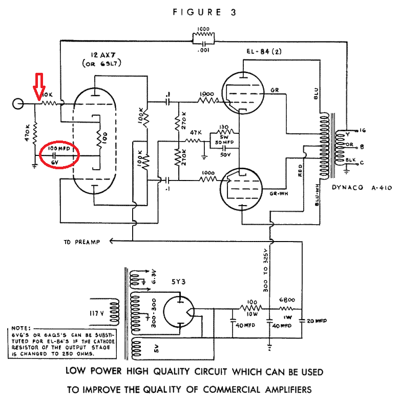

Lol, guys, if this is not such a great schematic, let me know now! I've only wired up the mains to the transformer and the heaters. I chose it for its relative simplicity and the fact that the power transformer in the unit provided more or less the correct specs. This is the mod I'm using, just with the 12ax7 instead of the 6sl7.

But you will get perhaps a loud plop at speaker output when switching on the power I think.
Look at the numbers, an 8 Ohm loudspeaker VC measures about 6.5 R, the OPT secondary is likely less than On Ohm & perhaps a lot less. Most of a couple of mA will go thru the OPT secondary, the small leftover thru the speaker VC.🙂

Haha, thanks! Just want to make sure I'm absorbing all I can. So add the volume pot at the arrow here, one side gets the input and the 470k ohm resistor to ground and the other the 10k ohm grid stopper.
Oh, and that circled cap, ok to run a 100v (or an old 50v) 100uf cap in that location?
