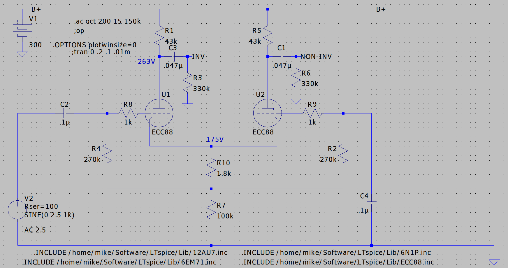

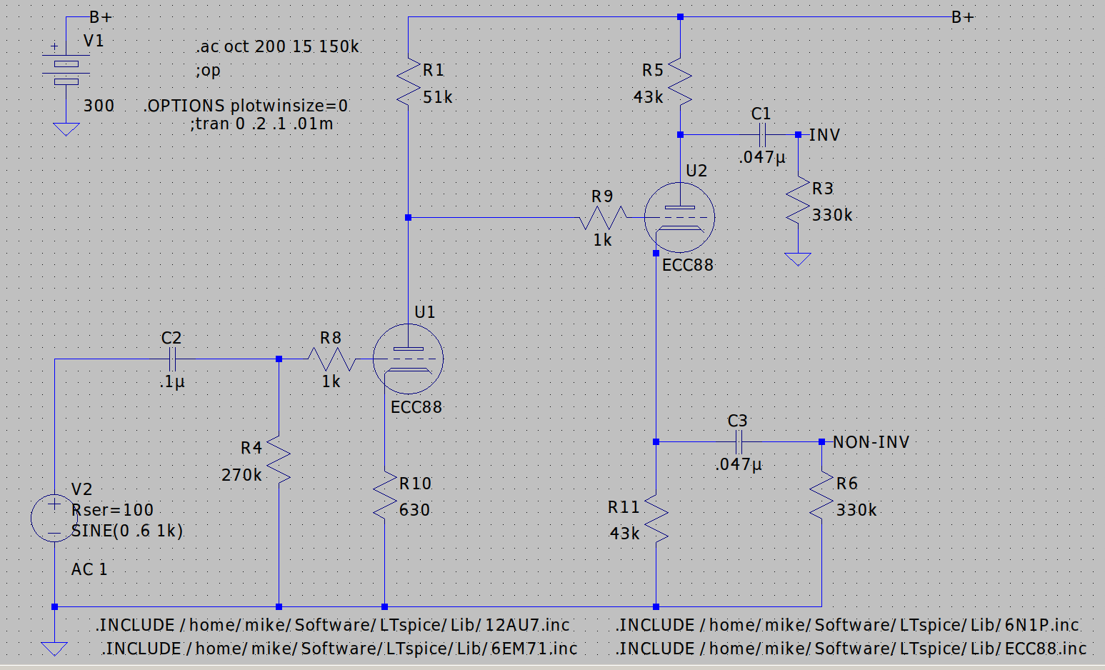

A constant current sink in the cathode circuit of the tube will provide and extremely high effective resistance in that setting. The sink needs to operate at low burden voltage, or else a negative supply would be needed anyway.Maybe the LTP solution is simpler than normally supposed. The classic solutions are
- Special power supply (e.g. negative leg)
- Unequal load resistors
- Active tail
- Inductive tail
However musing over data sheets the thought hit me. The 6922/6DJ8/ECC88 really likes low Vp-k so why not just use that tube with a really large tail. It has low rp so doesn't need huge plate load and it likes running with Vp-k under 100V leaving plenty of voltage for a goodly tail.
With or without current source, you can bias the grids well above ground so you don't need a negative supply.
Yes, a floating differential self biased above a CCS as a tail will work well. A decent CCS wont need more than a few volts.
