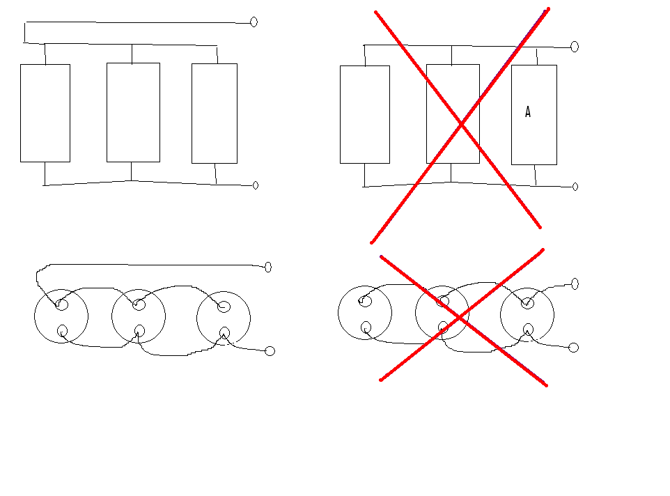

There is no harm in paralleling caps... it will often result in a lower ESR & ESL than would be achieved in an equivalent single cap... it's actually a good thing.
Are you laying these on a board or using point to point wiring?
I ask because there is an important detail often overlooked when big caps are wired in parallel.
I have attached a very poor drawing. This is how you wire the caps... PCB or P to P.
The drawings on the right are the WRONG, but typical, way to do it. The problem is the cap marked "A" will see more of the ripple current and do more than its share of the work.
The idea behind the methods on the left is that each cap sees the same length of connecting wire. There is inductance and resistance in the wiring which is on a par with the ESL & ESR of the caps.
Does this makes sense? Explained well enough?

Hey Andrew,
It is a fine point at 120 Hz, but it is good practice. Just sketch out the current waveform in a PSU cap... there are lots of higher harmonics present. The current is what causes all the heating and wear, so it makes sense to spread it out evenly.
I build high power inverters (100 kW) with huge banks of caps, at these levels, "zee wiring" is simply a must. I have to use laminated copper sheet for low L busbars... they are a real hassle, but they look cool!
You do this with batteries as well. the small voltage differences have a huge impact on charging efficiency and quality.

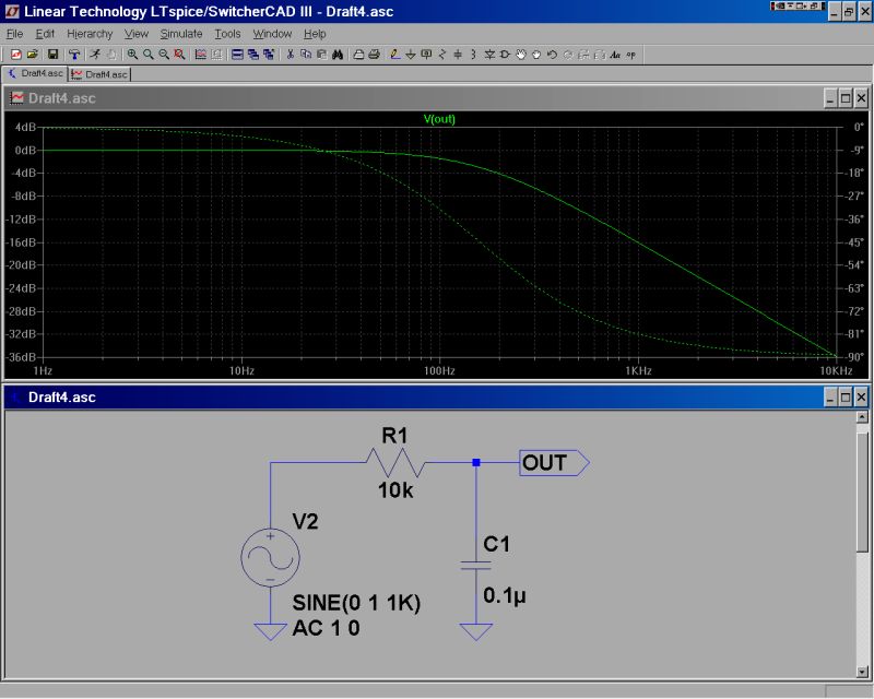

Simple RC networks like this a extremely easy to simulate using spice. You might consider downloading SwitcherCAD from Linear Technology (FREE!) and learn how to use it. You will be able to answer all your own questions in a matter of seconds, in far greater detail than you can imagine.
Example:
Explained well, but incorrectly drawn. If lead length is critical, then both top and bottom leads should be equal length before terminating at the "first" cap. As drawn, the leads are equal between caps, and it's good that two caps share being "first" in line, but the upper lead is drawn much longer than the bottom lead.
Or am I not seeing this correctly?
