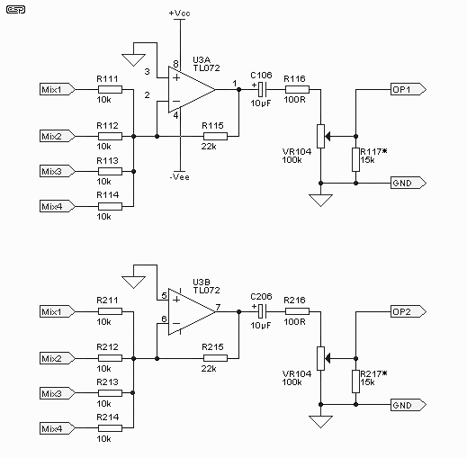

ESP project 94 - mixer
Here is Elliots mixer
Mixer - ESP project 94 Mixer
If you have 2 signals, use only 2 resistors at input.
you need only first part of the circuit -
only including output Cap - C106 (not the volume control at the out put)
You can use any OPamp - NE5532 OPA2134 or TL071 or UA741
(should be stable at gain=1)
But TL071 or TL072 is a good choice.
And they cost not much.
You can even supply with two 9V batteries - giving plus/minus 9 volt supply

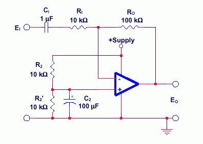

Single supply Op amp
Here is single supply.
What you add to the mixer from Elliot
is the R2 and R2' and C2 to the +input of the OP.
And an input Cap C1 to each of the 2 input resistors.
And you keep the output Cap from Elliots mixer.
/halo
(this picture is taken from the PDF, on page 76
in this 2MB, 94 pages PDF, I mentioned in previous post)

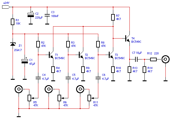

If you want just two signals to be mixed two simple resistors are simply the best. But you end up with an overall gain of 1/2
Long time ago I build a mixer according to the attached circuit. The collector currents of the inverters add the signals. Despite its simplicity it sounded remarkable good. Note that the signals are inverted. For sufficient headroom you need a relative high supply voltage because the DC currents at the collectors are also added. The circuit could easily handle 1V rms with low distortion.
A discrete mixer. Good, Pjotr! 😉
I have seen same thing in a book I have.
The sum of the current from the input transistors,
are put over a resistor.
This gives an output voltage.
Nice to see these old transistor circuits used.
Like in them days before OP-amplifiers. 🙂
Thanks. I have saved it into my circuits folder.
