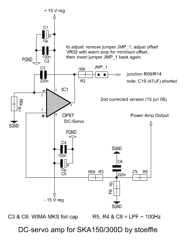

Re: Re: NFB network & DC servo
Hi KLe,
in the annex you find the schematic of my DC-servo which works just fine. It was mounted on a small lab-type PCB together with the +/- 15 VDC regulators. If you have a SKA stereo version, one +/- 15 VDC regulator is enough for both DC-servos. Power consumption is in the mW region.
I noticed that the output of my OP97 lingers around 0.4 to 0.6 VDC.
The SKA DC output offset stays below 500 uV, regardless of the temp of the heatsinks.
ciao.

Hi KLe,
ciao.
DC servo and sonic implications
Hi Dr. H,
yes, definitely, thermally coupling the two LTP input pairs is of great benefit to DC performance. I mounted my Q1/Q2 & Q3/Q4 on longer leads and placed them with the flat sides face-to-face, even with a small amount of heat spreading paste in between, then strapped a tye-wrap around them tight. To avoid shorts between the rather twisted leads, I used a short piece of thin silicone isolating hose on the middle leg.
To the DC-servo influencing the sound spectrum:
if the time constant of the integrator is made too small, we for sure will have the servo trying to partially counter-act against very low-frequency signals. We also would notice group-delay changes at the lower end of the audio spectrum.
At the upper end, the servo has no influence whatsoever, as it is a dead DC voltage through a high ohmic resistor (in my case 180k), which acts as a DC current source into the inverting input node of the SKA, correcting for the DC offset at the amp's output. In case you sensed changes in the higher end of the spectrum, I suppose that the reason must be sought somewhere else. My SKA300D delivers a full & solid bass and very high defined highs. 🙂
But as the romans already stated: degustibus non est disputandum. (for non-romans: taste is not a discussable matter).
ciao.
