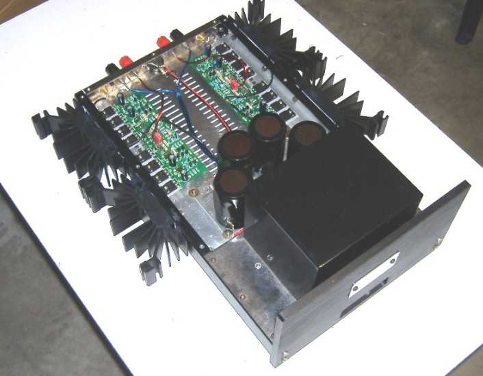

KLe said:This amp was a Metaxas Solitare
You should be hanged for that, but it looks smashing.
The constructional layout of the Solitaire is still unbeaten imo.
Mr Ball will be pleased that you "simple killered" the 4 big Golden Roederstein caps, not sure what he'll think about the 1,6 KVA transformer

Actually, I think Greg would like see 30KuF/rail (minimum). This one has 20KuF/rail, but, it is still sounds excellent
Unfortunately the Metaxas self-destructed, so now, it has been re-born into a stable and highly tunefull musical instrument
jacco vermeulen said:You should be hanged for that, but it looks smashing.
Hi jacco vermeulen
Worry not, the re-birth has been well worth the effort
Sorry, the Roederstein caps self-destructed and leaked all over the boards, which likewise self-destructed, so, the PS caps are now BHC aero's

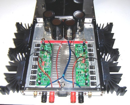

Kle,
looks like the chassis was made for the 300GB boards.
What a pity the fantastic NEC devices of the Solitaire got wasted.
What is the 300GB Costas like compared to the Solitaire ?
Hi jacco vermeulen
Yes absolutely, the 300GB boards fit the chassis perfectly. Very nice, indeed.

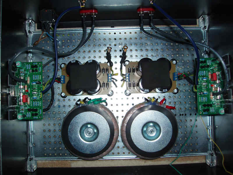

Thanks KLe, maybe ShinObiwan and Macka could help me if they were able to send me their Grounding schema. I'm in constant contact with Greg and he's making any effort to help me out with this. Here is a picture of my Amp's inside...

Hi Msamkl,
just a thought when looking at your pic of the perforated baseplate.
When wiring up mains supply from a metal distribution board enclosure, it is absolutely imperative that all the cables (L+N+E) coming from the mains incomer pass through the same hole and similarly all the cables feeding out pass through the same hole.
You have effectively put flow and return through different holes for every supply coming into and out of the transformers.
Has this anything to do with the hum?
Have you double insulated each cable (cord) as it passes through the perforations or at least put grommets around them? Particularly the mains input which should be double insulated and grommetted.
