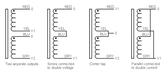

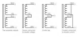

secondaries schematics
I would appreciate hearing from someone experienced regarding which of the wiring schemes would be used for wiring one transformer to 2 PSU's (GB150ABS) according to what Greg is recommending.

Hi Chad, looks fine now, and you have made something that looks like "star-ground" too

Tinitus, I guess that answers my question regarding wiring the secondaries as well... it would be the third example from the left in the image I posted above?
