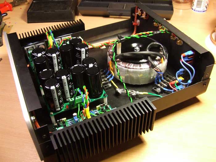

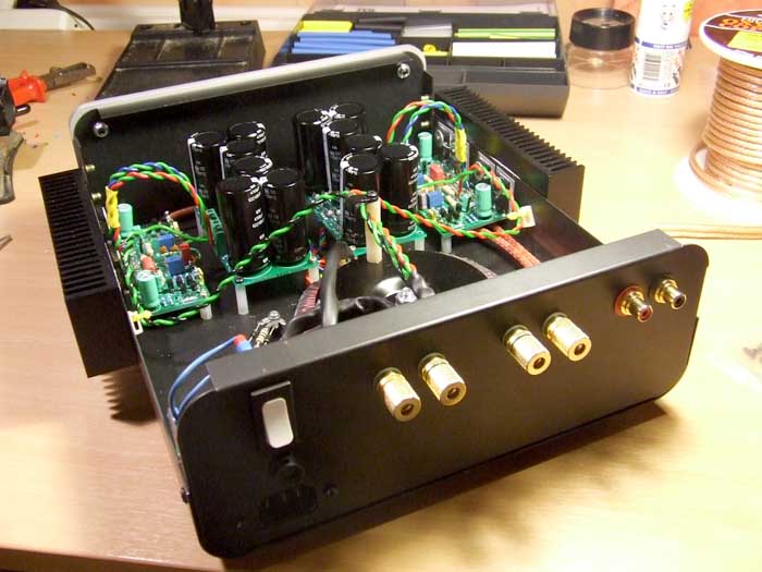

My case is really small i think 🙁 hope this dont give me noise problems, here is an pic of how i think that will put it in the case.

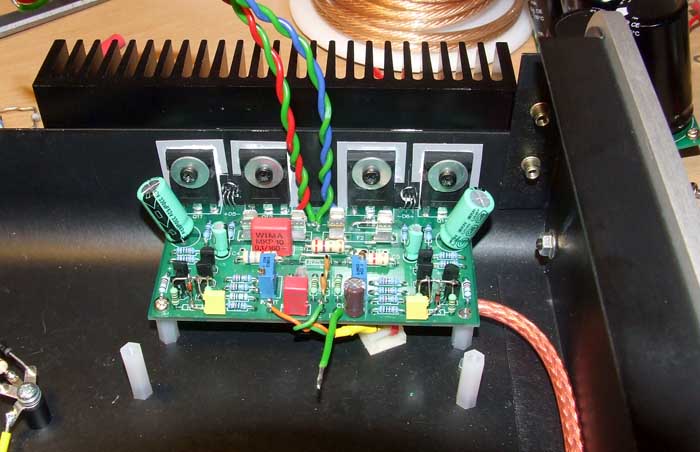

The 2nd Kit dont work :S show me 0V in the resitors 🙁
and if i measure the PSU with the kit connected show me in V+ like 80v and v- show me 4v.

Hi Cliff,
I just realised you are using an ATI case.
I tried to fit the sink internally and gave up the idea of stereo in that size of case.
Again, well done.
I notice ONE disconnecting network from safety to audio ground.
Will that work with a two channel amp?
How do you avoid a hum loop?

The sinks (Fischer) will work OK like that. I tried a mockup, case closed, with 25W per side on power resistors. No problem at all.
I guess the whole case is a heatsink, as well!
Since I mostly listen to very dynamic (chamber) music I don't expect to run them at anywhere near their max power.
Only one ground lift is needed, I assure you. I'll post the 'scope traces . 🙂 [Edited] If only one Xfo is used there can only be one network, otherwise they will both just be in parallel

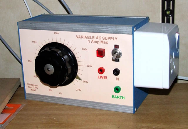

I prefer to use a Variac which I made many years ago. Check everything sequencially and wind it up very slowly. I also use a good old fashioned AVO in current mode in series.
On the 1 amp AC range its ballistic trip makes a very good cut-out.
