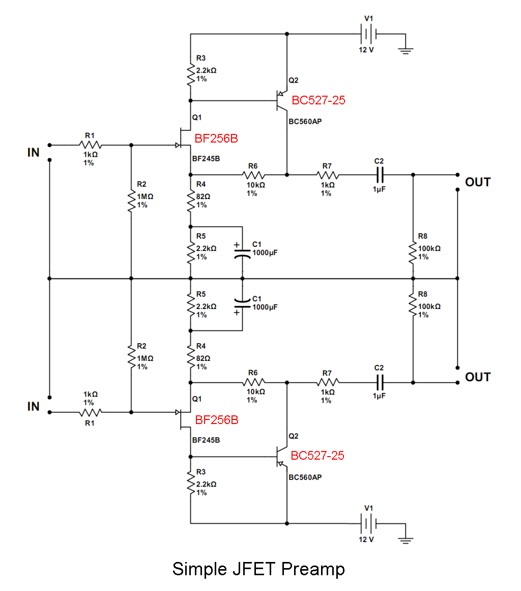

Hi folks
I've just built this circuit on veroboard but using BF256B and BC527-25 as substitutes. This is for a headphone amplifier, and I haven't fired it up to test yet.
Do I need to change any resistor values to account for the different transistors?
I have a pair of 15v linear regulated supplies I have built going spare, can I run this circuit at 15v instead of 12?

Thanks for the advice guys, much appreciated.
Why won't it drive headphones? Not enough gain or not putting out enough current? Sorry for the newbie questions, but this is my first diy amp attempt.

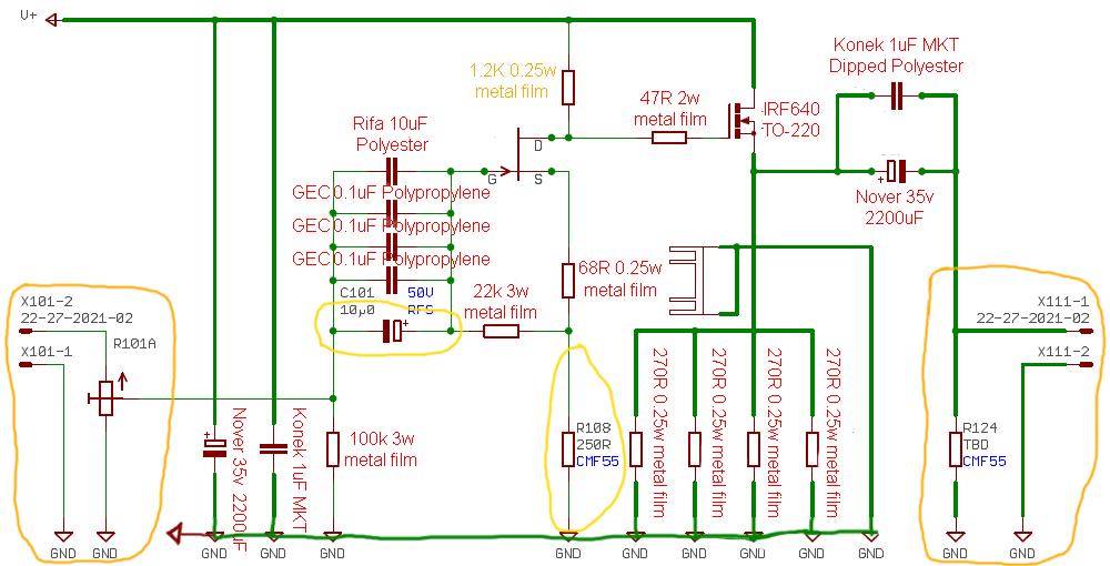

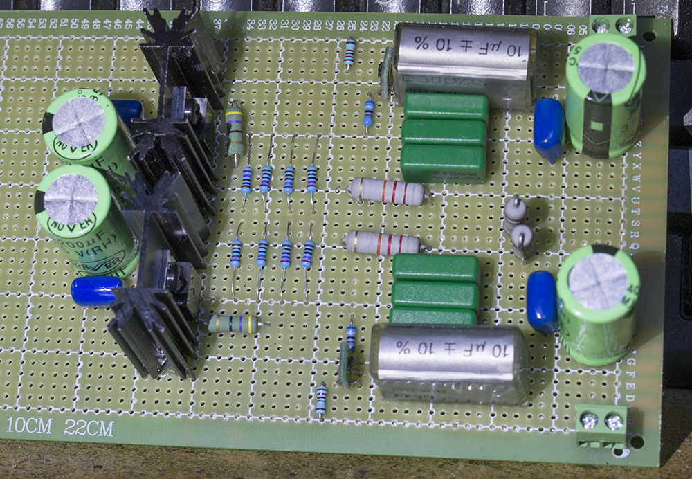

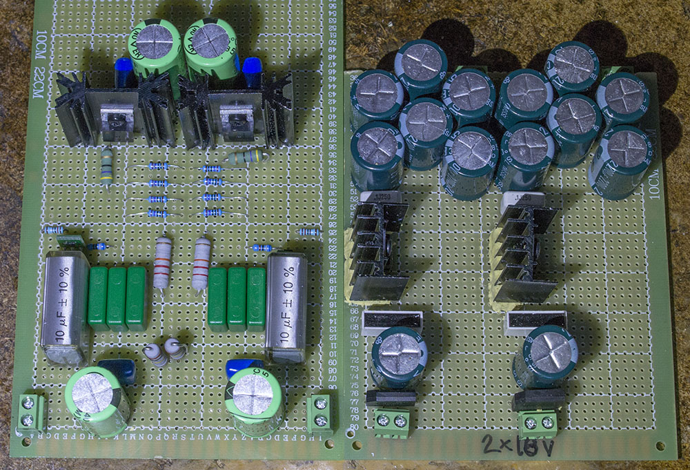

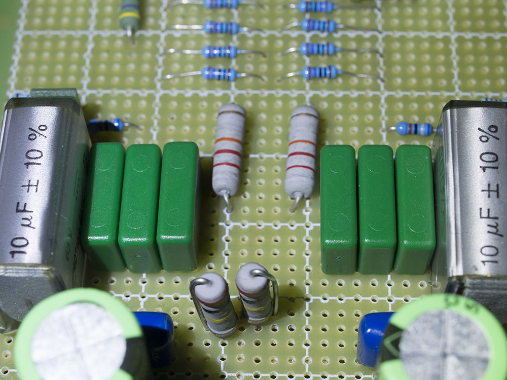

Here's how I built it, I have written in red the components I used, with the one out of spec part - the 1.2k resistor, in gold. I have outlined the missing two components in yellow and the input-output sections that I have thus far omitted in gold. I'll probably built the input & output parts on small boards and connect them to the amp board by wires.
attachment.php

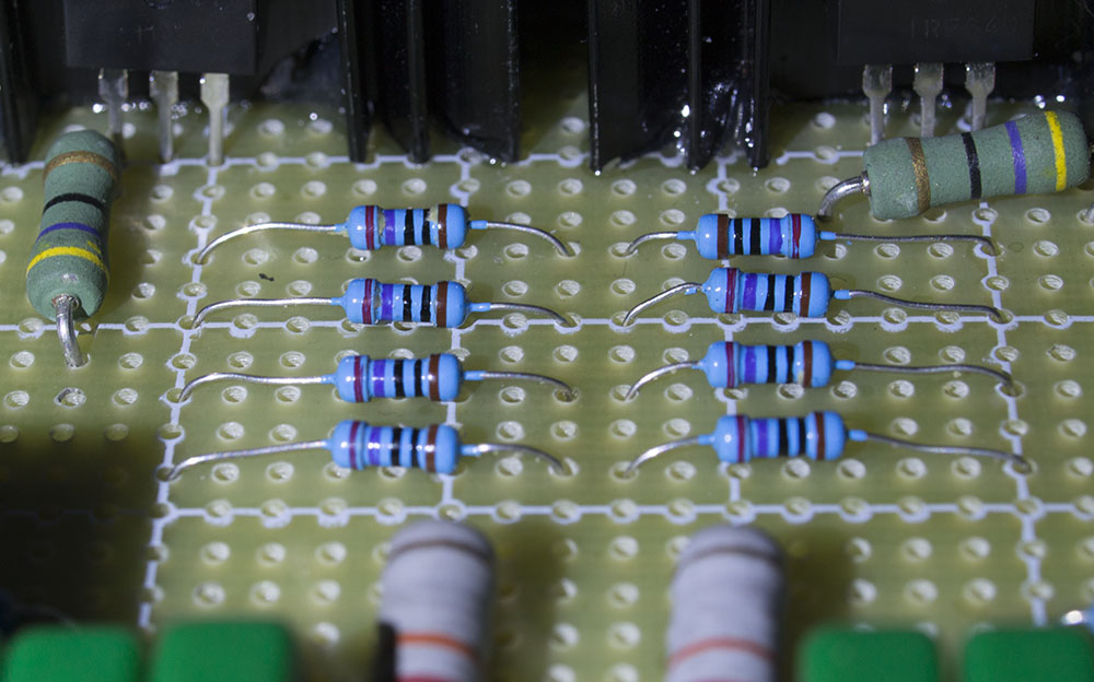

You can use 1/4w even 1/8w resistors everywhere except the four 270R loads in parallel below the MOSFET. Those should be 1W each minimum or a single 68ohm at 5W They are dissipating 1.25watts. So there are many places where you have oversized resistors except where it counts. Otherwise looks good.
Just use two of your 1uF dipped polyesters in place of the missing 10uF cap. And use one of your 270Ohm resistors in place of the 250Ohm resistor below the JFET - close enough and add maybe 4k7 in parallel to 270Ohm to get closer to 250ohms.
Also, if you are now going with the DCA, maybe post questions in that thread as more people may be able to help you and your questions will be helpful to others as well. Your call though as this is your thread.

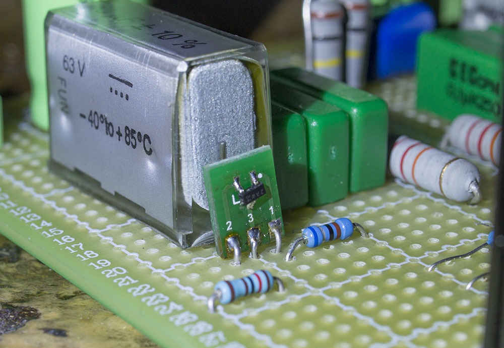

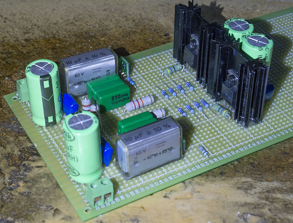

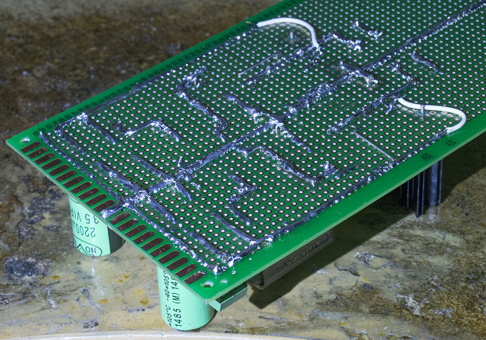

Thanks for the tips. Here are pics of what I've built.
The oversized resistors were because I just happened to only have those values in larger sizes.
Sadly, the four 270R resistors are either 0.25W Vishay or 0.6W Neohm, I forget, so I'll have to replace those with 1W types.
I shall indeed post in the DCA thread,, good tip, cheers.

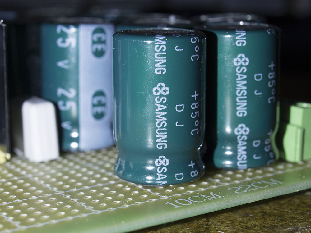

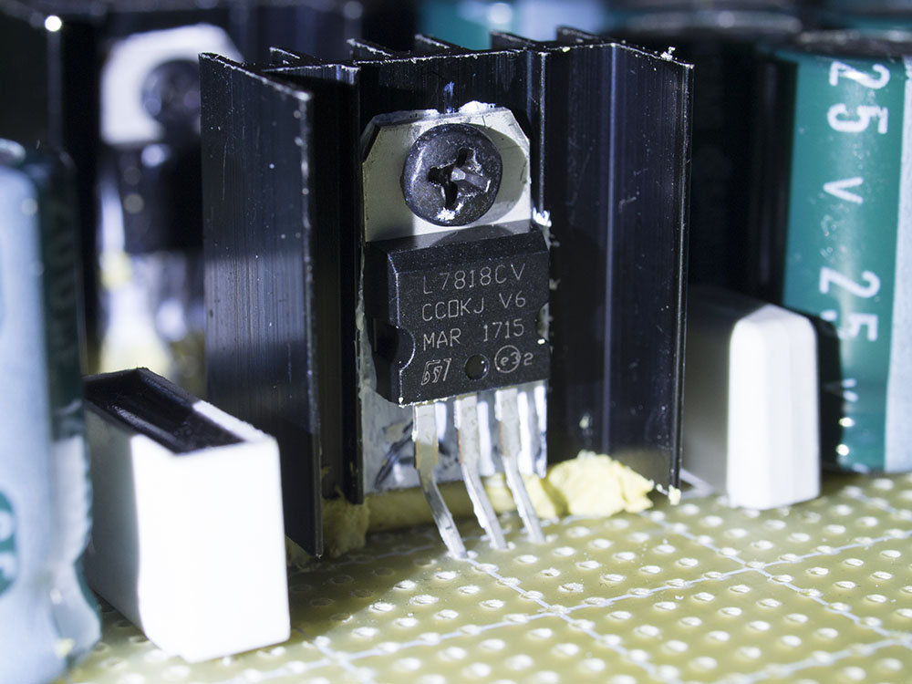

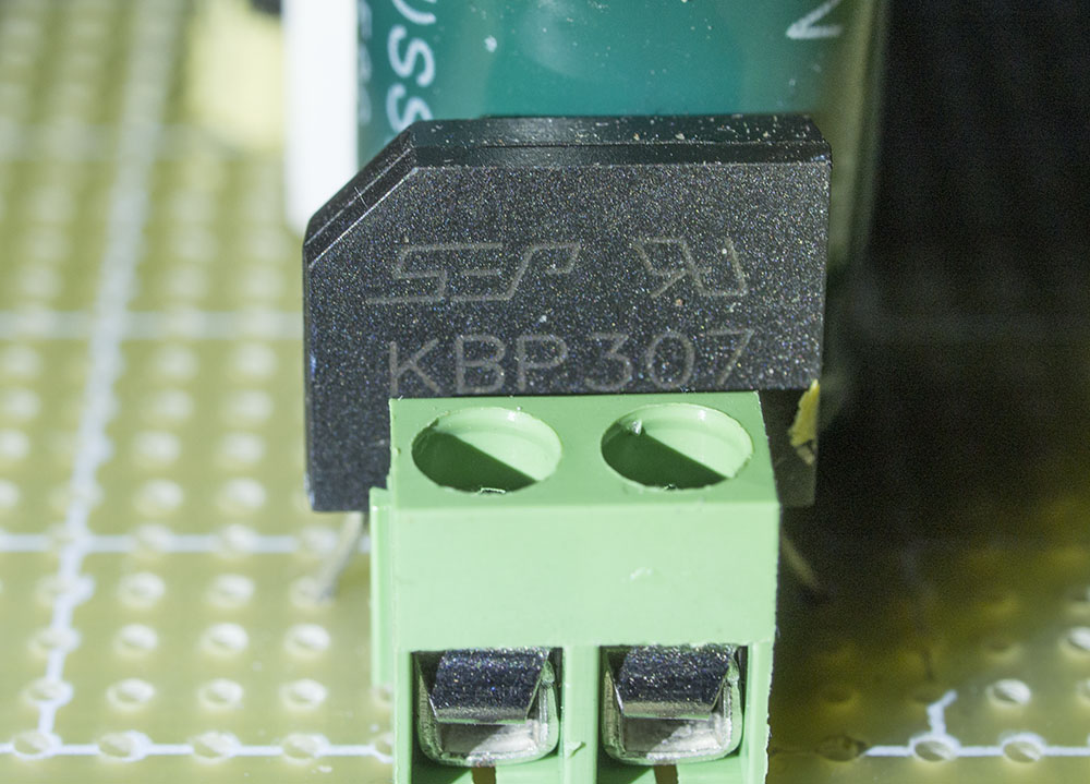

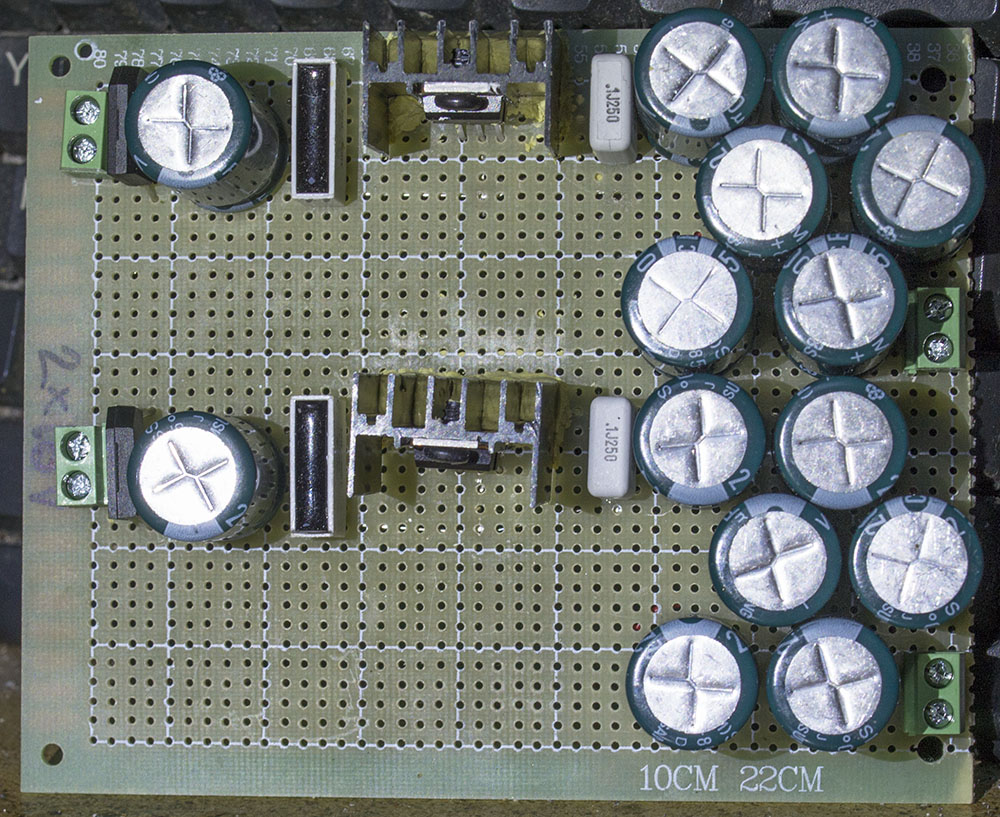

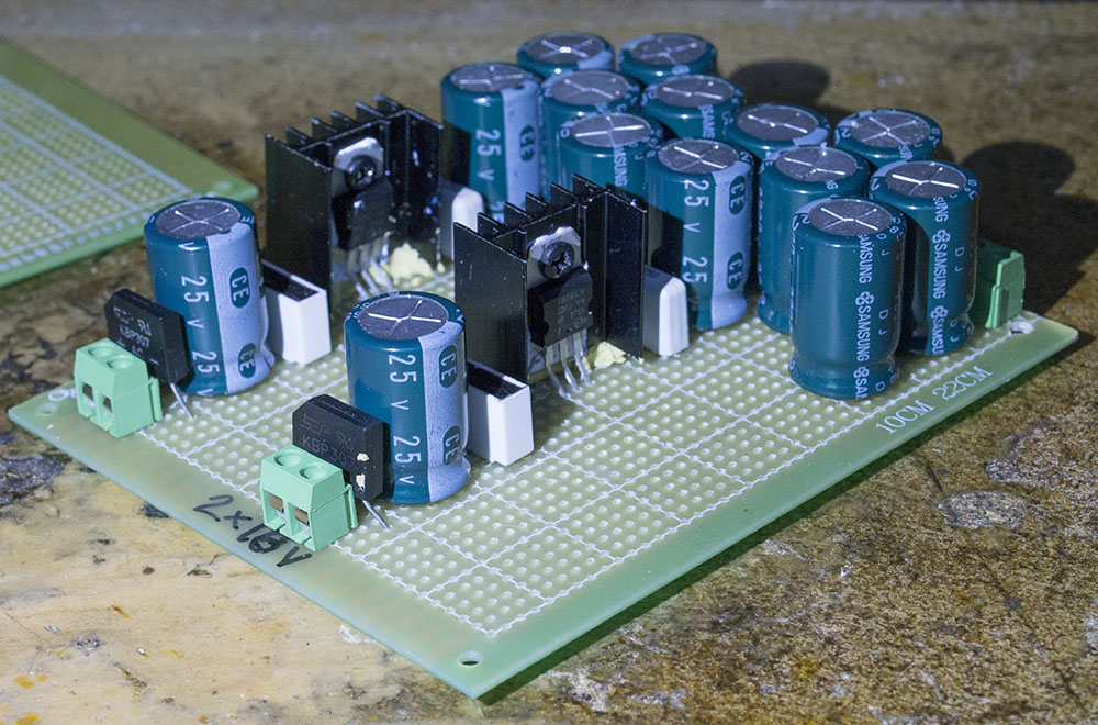

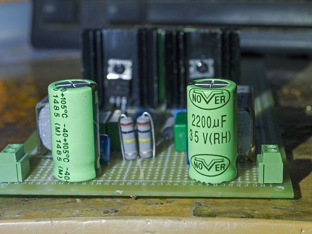

Here's some pics of the dual 18v supplies to power it.
Nothing fancy, just 7818 regulators using the circuit in the datasheet with a pair of polyproylene caps either side of the reg, I added the 2200uF Samsung caps for smoothing.

Very nice neat work, Ian Greenhalgh! If you ever decide to want a compact version, I have PCBs available that has the PSU on board (it is a cap multiplier) so a 24v wall war or SMPS is dropped to 20v - no voltage regulators (voltage stability not critical, but low ripple is).

It will work temporarily. The bias current will be higher and midpoint voltage above resistor may be a bit off. But it will sound fine as long as you don’t drive to clip as it is asymmetric now. You want DC voltage after MOSFET and above resistor to be 1/2 Vcc. Adj 1k1 resistor to rebalance to 1/2Vcc.
