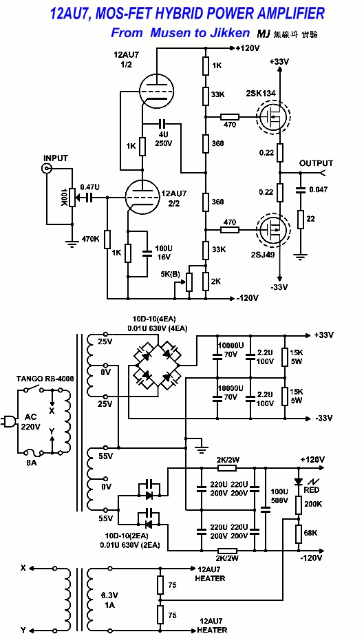

Simple hybrid amplifier
Showing the chassis doesn't help much. The simplest one I've seen, don't know if it's good or bad.
Good request foxye, i'm also interested in hybrids especially now that i have plenty of bjt's from ON Semi to use as well as power Mosfets to use as output buffer and looking for stable one.
also, maybe someone kind enough to share some schematics with Triode-Pentode tube as inputs. Like 6f5p or 6bm8, triode section as voltage amplifier and the pentode section as cathode follower...any schematics please?
