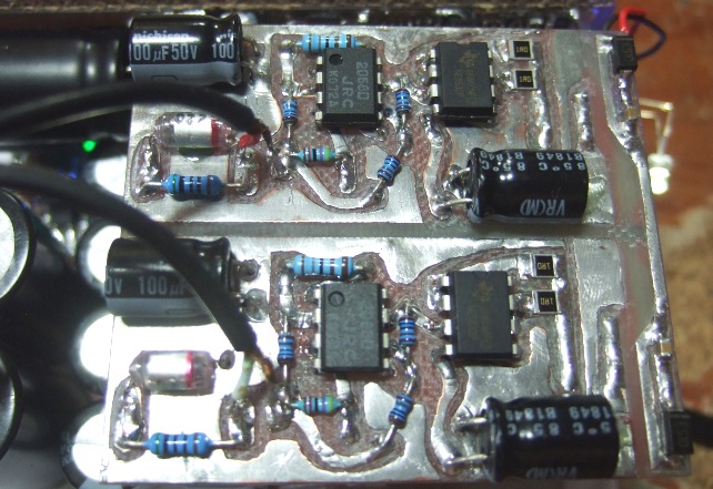

Simple HP test amp questions
Because of the corona mess (I can't go home) and high import costs for "exotic"
components ordered from out of the country , I made a small and simple test
HPamp with the easy to get and very cheap NJM2068 and NE5532.
I had to test the power supply (Elvee's DeNoiser), and protection circuits I had
build with something other than LED's.
Last interesting HPamp design I saw , was with the now discontinued (boo T.I)
LM49600 like in its application information . It's a simplified version of tomchr
(neurochrome)'s HP1 which he isn't sharing . Another is an HPamp with
OPA1622, but this is ridiculously small ( double boo for T.I).
My objective is to have an HP amp that can take my 300 ohm HP's with the tiny
signal from my computer and Mp3 player. They can't handle 300 ohms.
So I made a simpel (boring) one :

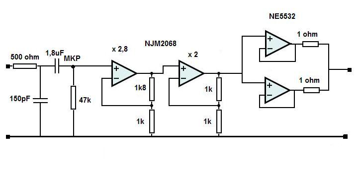

After the 1,8uF I measured 7mVdc offset ! (with or without input signal . After the
cap I expected 0mV) . I guess this is the 2068's 150nA input bias current going into
the 47k ? It gets amplified 5,6 times and combined with the 2068 and 5532's offset
to show 37mV at the output. Now I know why nwavguy's O2 has the cap behind the 2068.
Makes a case to lower the 47k to 10k or less , but then the input cap should be
bigger.
Here are my questions:
Am I right that this is the 150nA bias current that creates this 7mV DC offset?
Is there an other easy solution to get that offset down? (no servo).
I'm now using it with an 32 ohm HP :
Is 37mV dc on output dangerous for a small on the ear HP ?
Can I use the NE5532 like used here ( on 2 x 14.6V) with a 32 ohm HP without
damaging it?
Both 2068 and 5532 get hand warm .
The 5532 comsumes about 8mA x 29 V= around 232mW , the LM317/337 deliver 18mA with 7V over them = 126 mW , yet the LM's feel warmer . Weird.
The amp sounds good , like a fuller sound compared to the computer output. But that could be subjectieve.
47k x 150nA = 7mV, so absolutely it does.
Balancing the DC impedances seen by both inputs - however this would increase the Johnson noise significantly from the feedback network. A large capacitor and small resistor would do the job between two of the stages, say 47uF and 1k, which reduces the offset to 1k x 150nA = 0.15mV
Changing to a JFET or MOSFET input opamp would finesse the problem of course as the bias currents are orders of magnitude smaller.
power = 43µW, so not at all. However it might increase distortion by biasing the diaphragm off-centre in the transducer.
damaging it?
Opamps are universally short-circuit protected, I can't think on one that isn't.
However the 5532 will have increased distortion as the load falls below 500 ohms with large signals. For small signals its probably doing just fine.
Heat dissipation is mainly through the legs of the chip to the groundplane of the PCB, so can vary depending on leadframe geometry in the chip and pcb layout.
All listening tests are subjective unless double blind or ABX with many many repetitions to pull out the statistical pattern.
Why do you need the input coupling capacitor?
Without it, the 47k could instead be much smaller, as long as the source could drive it.
If you still want a high pass, the series cap can go before the 5532.
Thanks Mark Tillotson for confiming that it is the 150nA input bias current.
Of course a jfet or mosfet opamp would solve it.
Putting a smaller cap between 2068 and 5532 is the O2 solution and beter than a electrolytic cap on the output. 5532's offset is not a big problem. A 2,2uF MKT is not that big to fit between the 2 on the PCB.

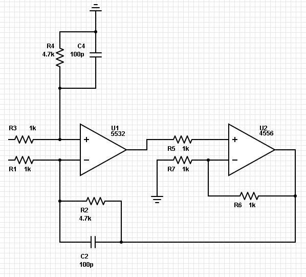

I'm actually doing this currently. 2 op amp and less than 20 resistors for a stereo.

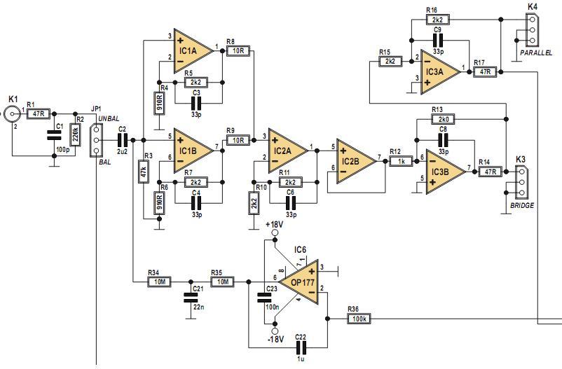

I had a look at the 5532 Opamplifier of Douglas Self (Elektor 10-2010) . There the 5532 are also (at the beginstage ) non-inverting amps . No mention that the 200nA over 47k will cause > -9mV ... Amplified by 12-13 (22,7dB) , that's -100mV after the amplification stage before going to the paralelled 5532 output stage. No caps after the input stage. So the servo (OP177) , has to compensate for this ? Nothing in the text says something about this.
I based my simpel test HP amp a bit on this and the O2 .

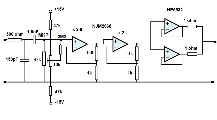

A quick and easy way to lower the output offset because of "input bias current challenged opamps" ( AD797 , NE5532, NJM2068.....) , is the poor man's servo method.
What does an opamp servo do ? It injects a dc voltage to compensate for the dc in the output whether that is because of dc coupling , high input bias current over a resistor , or the input offset of the opamp itself.
Do the same but not with an opamp but with a trimpot. It works , I can get the output to less than 100uV.
Of course adjust when opamp is at its working temperature to compensate for temp drift.
And it doesn't work for dc coupled inputs where the dc is not as constant as the input bias current.
With so low voltages and current through 1 to 10 Mohm from the trimpot to the input , I doubt it will make noise worse. Servo opamps do it this way , so why not a trimpot .
Even low bias current bipo opamps like LM4562 have 10nA : 10nA over 47k input R = 470uV x amplification , here 5,6 = 2,63mV on its output + or - their voltage input voltage offset.
Also it is a method of injecting DC in the ouput for testing DC detectors & protectors.
Not sure why no one has suggested this , this is nothing new .
