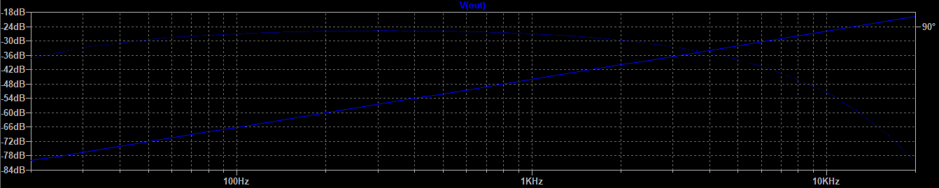

Make a current source loading the output, say 50mA rms, and do a .ac with it from 20Hz to 20kHz, and look at the signal that this produces at the output.
For instance, if you see 10mV signal at the output when loaded by 50mA rms, that is an output impedance of 10mV/50mA = 0.2ohms.
Thank you Jan, this is is what I've got from the simulation of the circuit on the first post:
