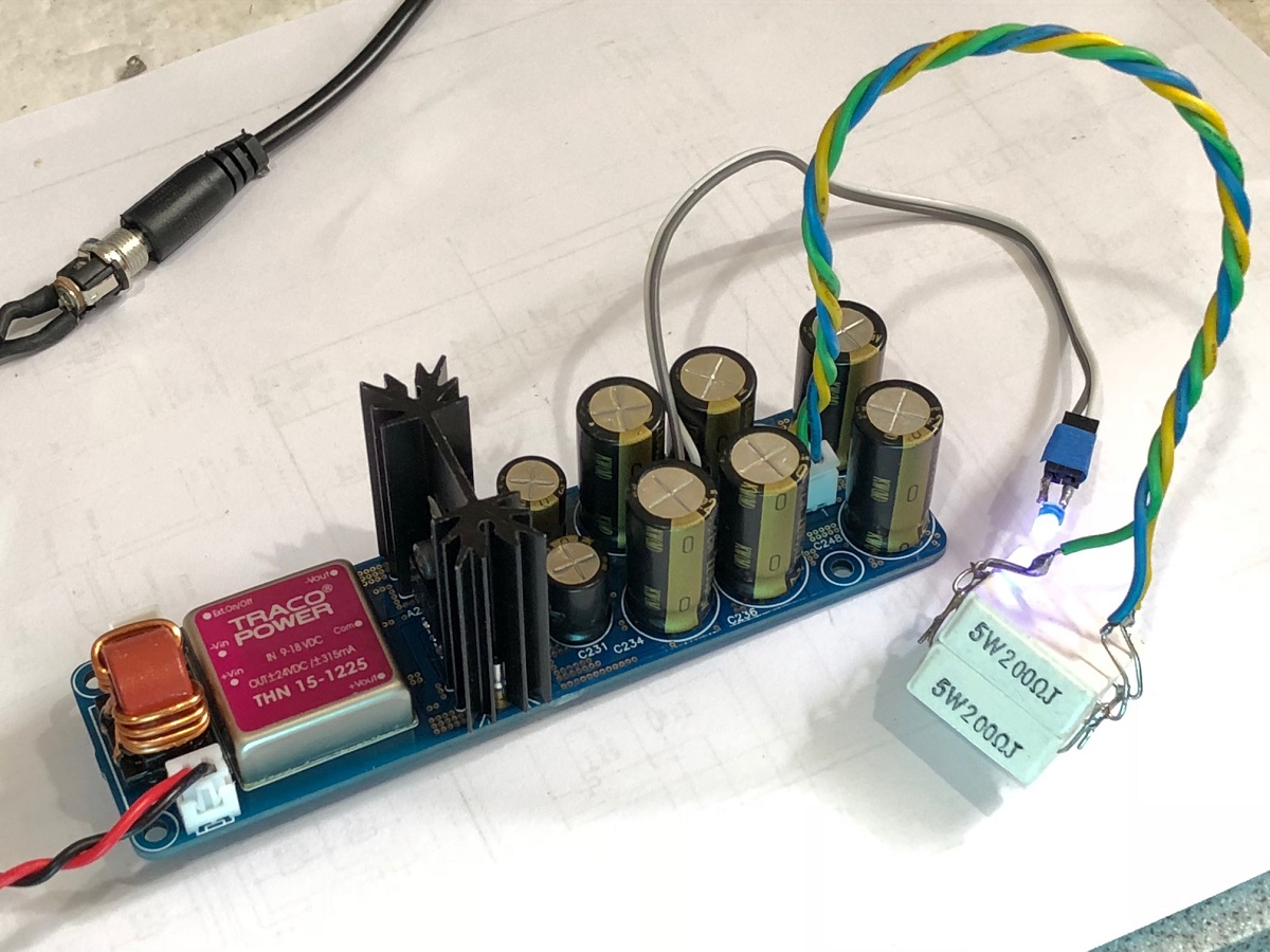

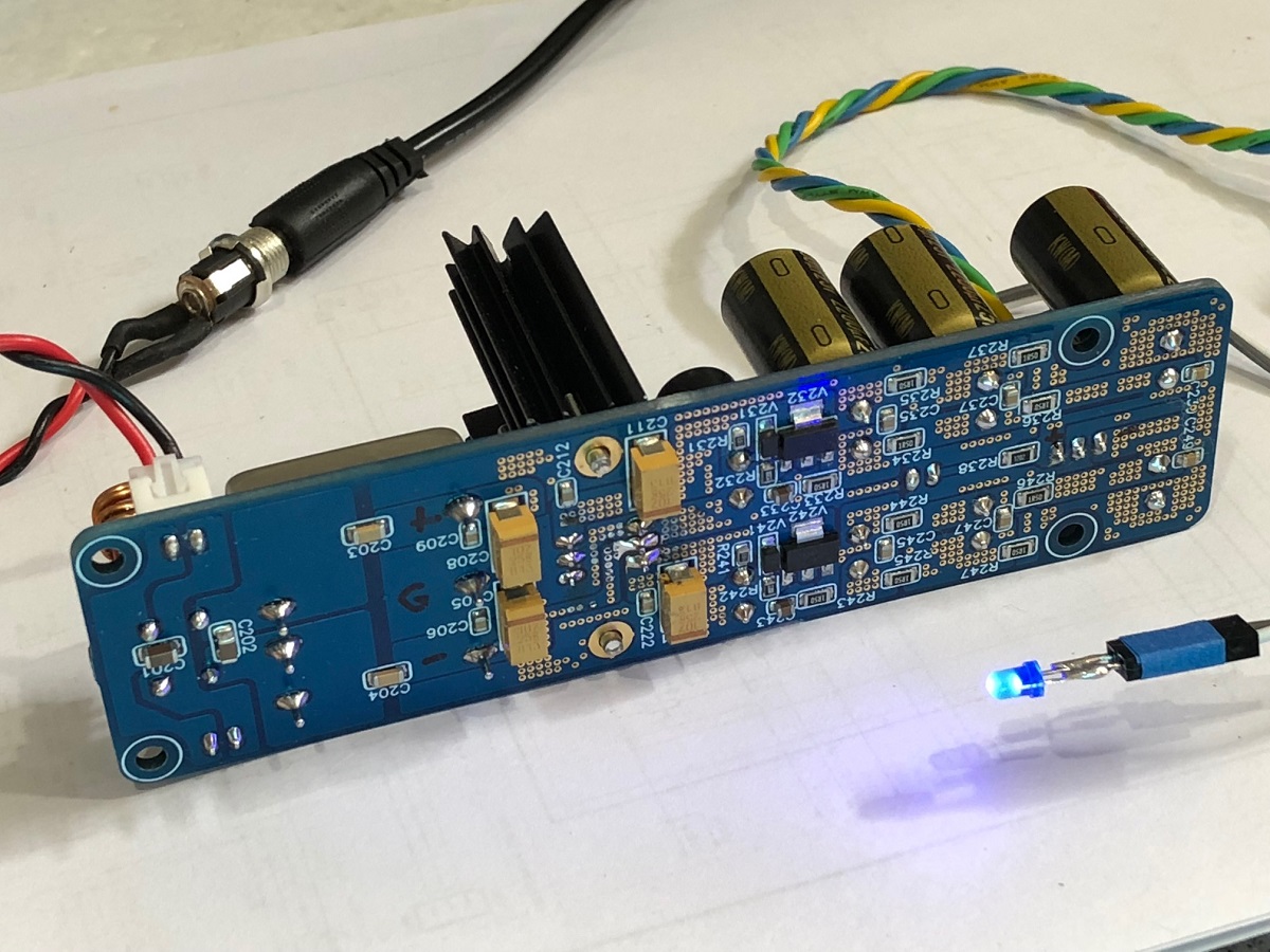

Verification build for PSU

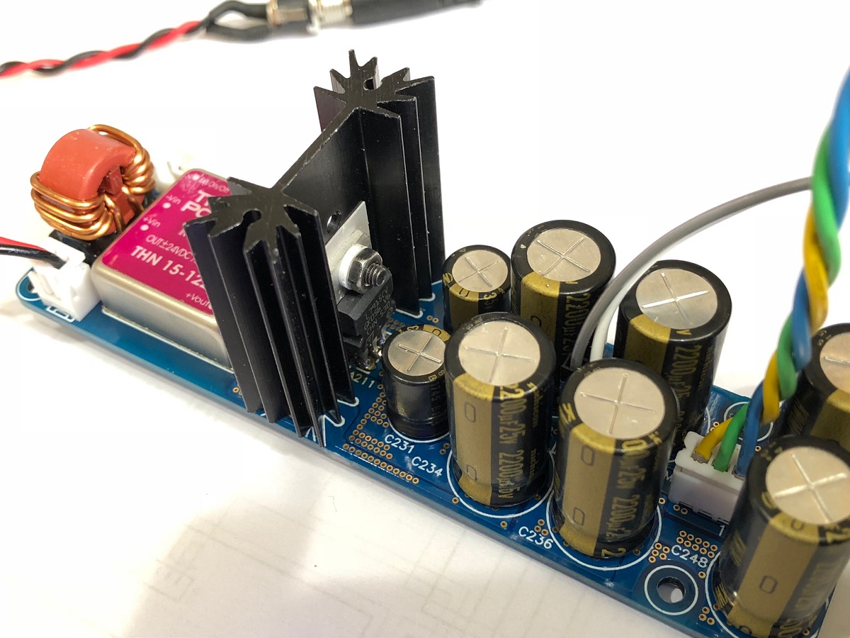

I assembled the PSU and found a few typos in the schematic. The regulators are labeled A211 and A221, The positive rail regulator should be mounted in the position closest to the DC-DC converter (A221) and the negative rail regulator should be mounted at A211. The resistors on the cap Mx R231/R241 should be 10k and not 220R.
I had some trouble because of a bad batch of 7918 regulators. After trying 3 with no luck I installed a 7915 that I knew was good and it worked. So its is surprising at it is an ON Semi MC7918CTG from Mouser.
Anyhow, the circuit works but it looks like ideally we want to use the the nice LDOVR.com regulators with adjustment so that we can dial in the appropriate upstream voltage as there is about a 2.4v drop through the cap Mx.
I have it hooked up to a 10w 100ohm load (circa 150mA on each rail) at present and doing burn in.

So the PSU works if f you follow this revised schematic below.

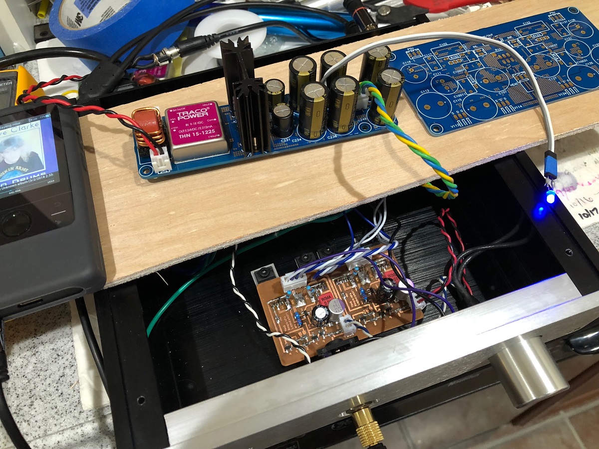

The PSU has now been tested with the amplifier (hand etched proto). Running at about 95mA bias current. The common heatsink for the 7818 and 7918 is at 60C. With adjustable LDOVR.com regs we can adjust voltage to about 3v higher to compensate for the dropout in the cap Mx, so overall dissipation on heatsink for the regulators will be about 50% less. Right now it is dropping 6v from 24v to 18v. Listening to it sounds great. Measured noise at headphone outputs with no signal input is 0.0mV to 0.1mV rms.
attachment.php
Ready to move onto building and verifying the main amp board now.
