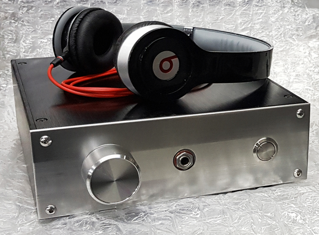

In the meantime, I'm pretty happy with the finish on this build.

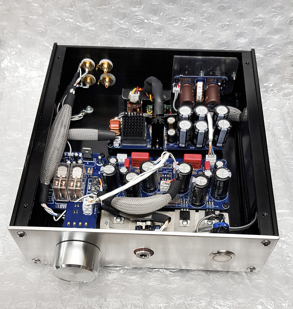

Avtech, I really like what you did with the wiring in your amp! I have been experimenting with mumetal shielding and ferrite beads lately, so definitely interested in preventing stray EMF pickup.
Let me see if I have your process figured out...So you twist up the wire pairs, then slip on that braided shielding sleeve along with two bits of heat shrink OVER the sleeve (that looks like it was hard). Solder wires. Then finish by slipping the heat shrink down to the ends, to cover the joints and secure the ends of the shielding sleeve in place. Man, that is cool.
Did I get it right? Where do you get that shielding material?

I think that’s just silver colored decorative nylon braid to tidy things up. To make shielding you would tie just one end to GND. Twisting pairs of wires does help reduce stray noise pickup.

For this particular build I just used the nylon braid, as X correctly identified, to tidy up the cables and make it a bit neater. The cables themselves were multicore sheilded already so I didn't need the extra shielding.
I've used similar products to this a fair bit at work and it seems to do the job: 30508 | Wurth Elektronik Expandable Fibreglass, Nickel Plated Copper Grey Cable Sleeve, 8mm Diameter, 1m Length | RS Components
For this build, I attached the JST connectors to the wires at both ends. Then using a plastic tube, compressed the sleeve to open it up, slip onto the tube then feed the wire through the tube. Heatshrink (unshrunk) on one end, withdraw the tube most of the way, laying the sleeve on the wire, then pop the second heatshrink on the sleeve. Hit it with a hot air gun and ready to go!

That woven fiberglass/copper braid looks like great stuff but pricey at $32/meter. I guess you don't need much of it for a small preamp or HPA box. Thanks for the link.
I wonder if solder wick braid could be used for smaller cables. Sometimes, stripping off braid from used RG58 coax or household cable coax leftover bits can work too.

this looks great, the sleeves are a nice touch - looks like you took a page out of the PC building book 😛
Thanks buzz.
True, it does look like the PSU leads inside my PC! Must've been where the inspiration came from 😉
