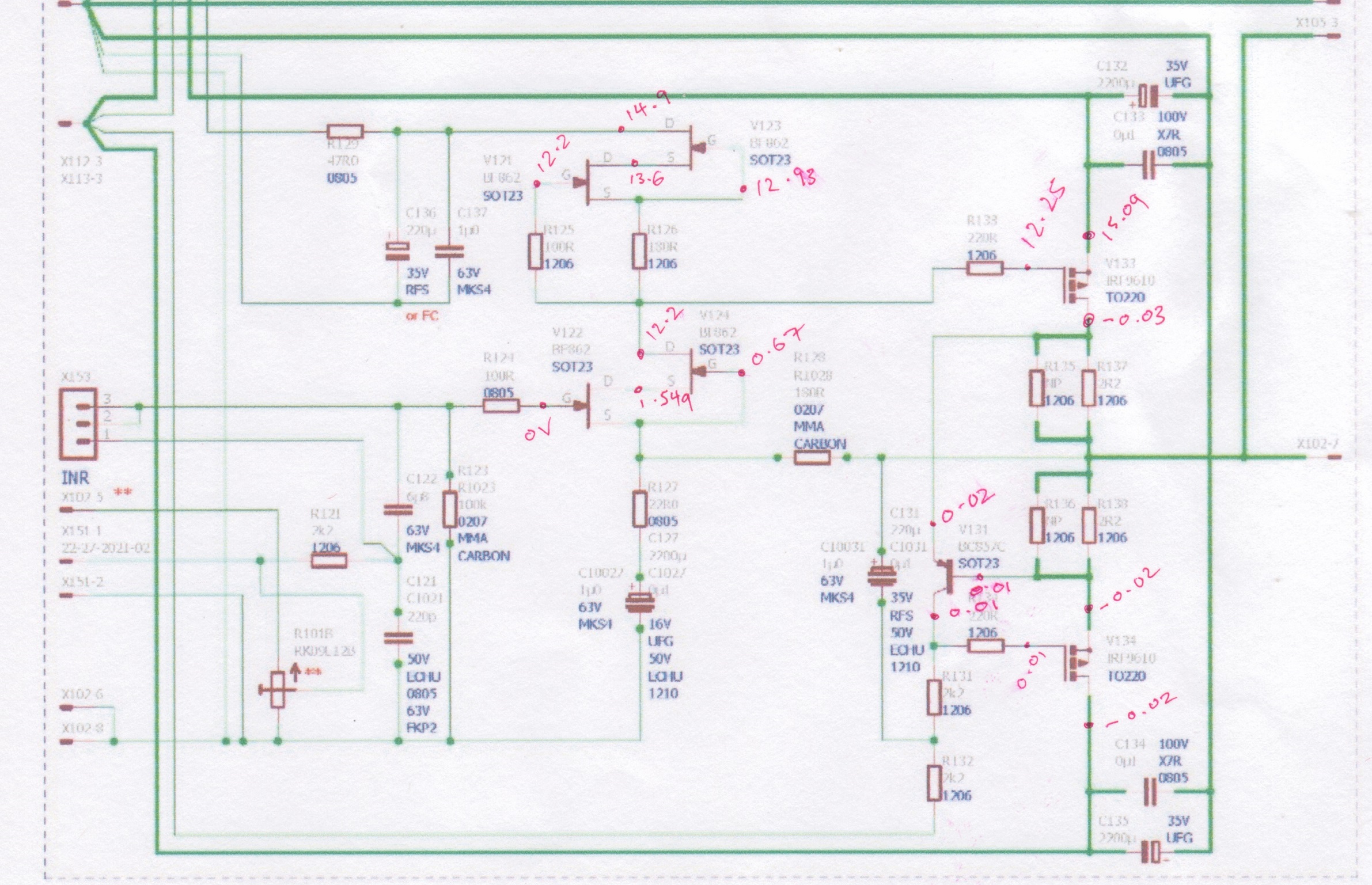

You still haven’t shown us the schematic with voltage written in for each leg of each transistor (not delta V across the resistors). All voltages relative to 0v. Especially the V131 BJT that drives the quiescent bias current setpoint. Have you checked to make sure it is correct and functioning as a PNP? Remove the V131 and check to make sure it’s not dead or swap with V111. In my experience the BF862’s hardly ever are bad - and the voltages you show seem to indicate they are operating balanced like the upper circuit. It doesn’t look like the MOSFETs are the problem since you checked and swapped. I would focus on V131 and resistors around it.
ahh my mistake! I was measuring similar points to what was shown on the LTSpice screengrab - which seemed to be across resistors. Will probe around tomorrow!
continuity measured on +/- rails to mosfets & R132 - all good there.
Resistance across R131 & R132 give 1.x Kohm though and it slowly increases as I keep the probes across each resistor. Compared to R111 & 112 which give 2.2k almost straightaway from applying probes.. Not sure what that means though
You don't have your negative rail voltage on the Drain of V134.

V+ V- and GND are all coming through correctly - PSU outputs are normal, and JST connector to board is fine too (measured voltages at those pins)
except....traces have continuity with the leg of the mosfet...You don't have your negative rail voltage on the Drain of V134.

Your upper amp has -16v on the negative rail as shown by drain pin of MOSFET on left diagram. The amp that is not working (right diagram) shows 0v at the drain of the bottom MOSFET. You may have just not pushed the probe hard enough to get a proper voltage since the top amp and bottom amp share the same rails. But it must show -15 or -16v. See marjed up diagram.
X - quite correct. Took the measurement off the leg this time and -16V . Probably didn't contact the pad earlier.
I was puzzling over that earlier - how there could be -16 on one channel but not the other with traces intact. At least that mystery is solved!
What voltage is at R132 both sides wrt ground?

Ok - rather inexplicably it works now. after checking for -16V I decided to swap out the BC857 as X suggested earlier. Put it on the transistor tester - it checked out. New one from the pack, also tested fine. Put in the new one and now voltages seem to be similar to the L channel (no sound test yet).
No idea why that did the trick - I did check the BJT for shorts before pulling it and it didn't seem like there were any.
I bet it was a cold solder joint on the BC857. Let us know what you think of the sound. For me, it’s one of the best headphone amps I have heard. Being DC coupled really gives it some amazing transparency and the depth of bass is very good.
