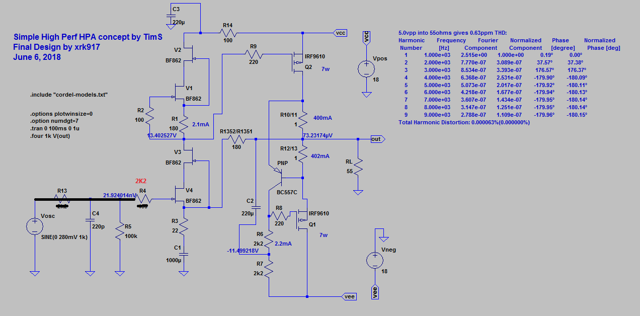

RFI filtering and protection of the input FETs, as well as bandwidth limiting so that it does not oscillate. You can short out the 100R and it may work fine, but you may have RFI problems and it may oscillate...
I understand the filtering part.
I am thinking that a 2K2 resistor at the gate would be enough or perhaps I’m missing something.....
Perhaps I didn't explain it clearly in my previous post.
I am proposing to move the 2K2 resistor to the gate, as a gate stopper. In front of it, the two capacitors will act as high pass and low pass filters.
Is there an issue doing this with a FET input?
Harry3,
Can you mark up the schematic with what you are proposing?
Do you mean make R13 2k2 and get rid of the 100R? The 2k2 acts with C4 as a filter, whereas the 100R is a gate stopper, which probably isn't needed as the 2k2 is already there. However, it matters where the node to the filter cap is located. I think you can leave R13 where it is but ok to get rid of the 100R at R4.
OK. I now see what you are saying about where the node should be.
I will leave the 2K2 resistor in it's original position.
