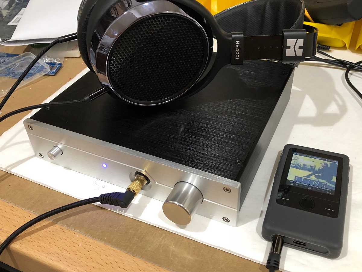

Great build and results X, everything fits in the case just right.

Here is the case I am using in case anyone wants to use same one. Great case and excellent value.
PH I Headphone Amplifier All aluminum Chassis Preamplifier Enclosure Mini Case DIY Box-in Speaker Accessories from Consumer Electronics on Aliexpress.com | Alibaba Group

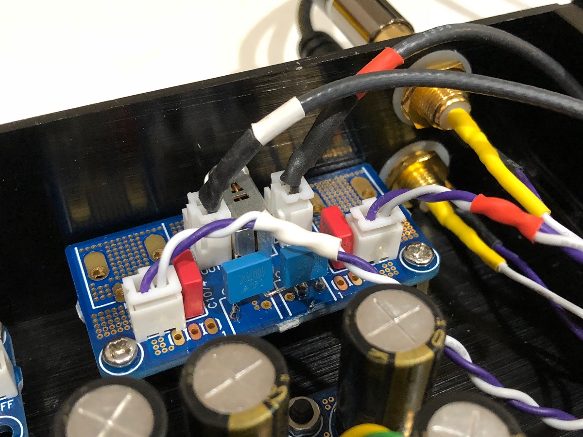

It’s hard to see but there is a DPST push button switch in the middle of the PCB. It goes through a hole drilled in the back panel. The filter is based on the Danyuk crossfeed with -4dB attenuation. So it sounds noticeably softer when crossfeed is activated. The problem is that in order to have a fully defeatable switch, another set of wires needs to be switched as well. So in defeat mode, the volume is not attenuated and there is a small amount of crosstalk. I think two small DPST relays can be used effect the defeat effect. I may try that.

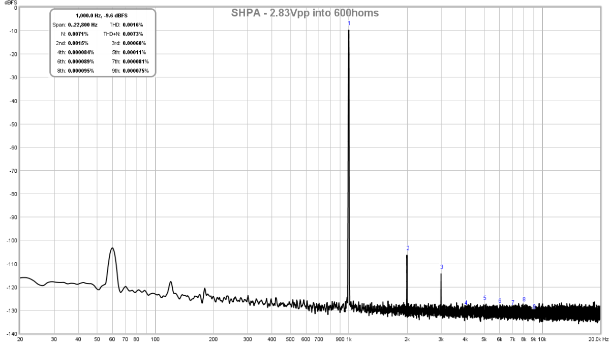

Yes, Beyerdynanic DT880 chromes. 250ohms is highest. It works fine and able to get loud volumes without distorting. I don’t have 600 ohm cans.

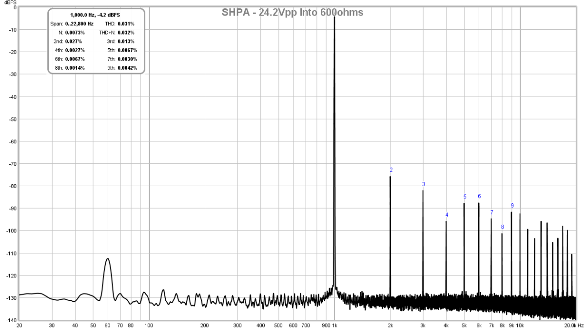

Here is a measurement of 2.83Vpp into 600ohms metal thin film 1W resistor dummy load. My cabling from the 600ohm resistor to the ADC is unshielded so picking up a little ambient mains EMI. The harmonic profile and THD remain good at 0.0016%:

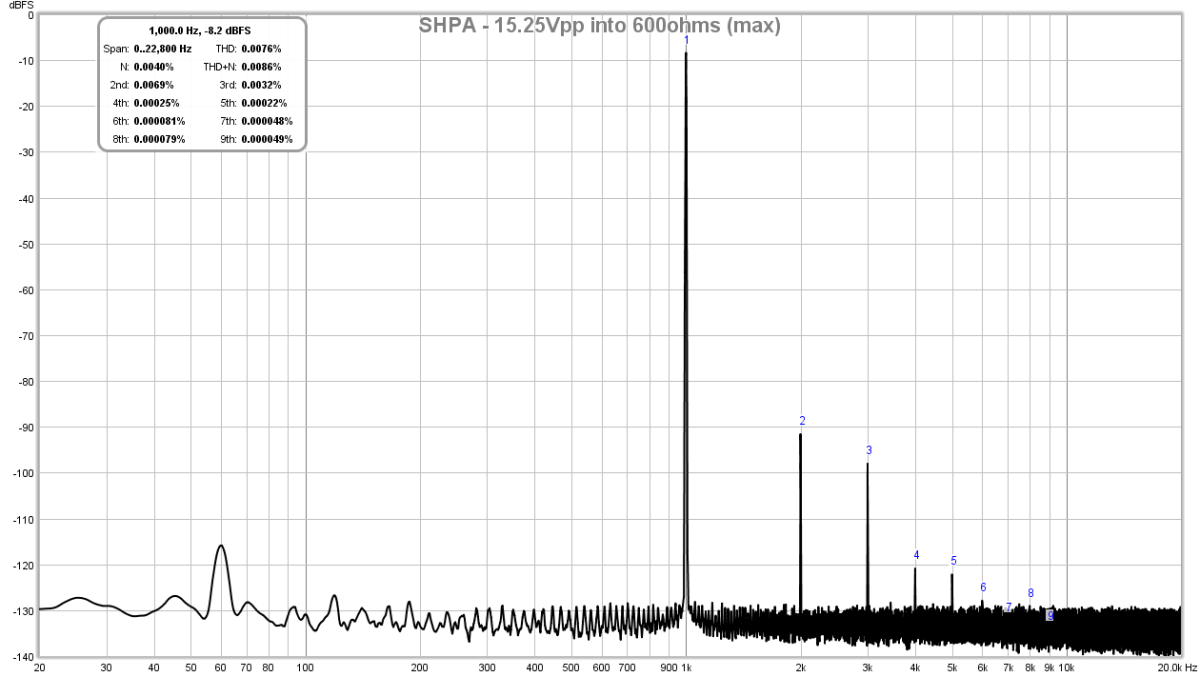

Here is the stress test for maximum voltage swing before onset of clipping to achieve 15.25Vpp into 600ohms, Harmonic profile and THD still look excellent with monotonically fallin higher orders and dominant 2nd and less 3rd harmonic. Overall THD is still only 0.0076%:
If I max out the DAC output, I can squeeze 24.22Vpp into 600ohms and higher orders appear but it is still only 0.03%THD (quite listenable probably but perhaps higher orders would sound fatiguing?):
So now everyone can see what the limits are of this amp - no cherry picking the data here. Running a higher bias current would improve performance at these extreme drive loads of course. These are all for 115mA (selected using 2.7ohm Drain resistors on the MOSFETs). Also, increasing PSU rails to higher value would help as well - this is for +/-18v rails. There is the 145mA option and one can go as high as +/-20v I think.

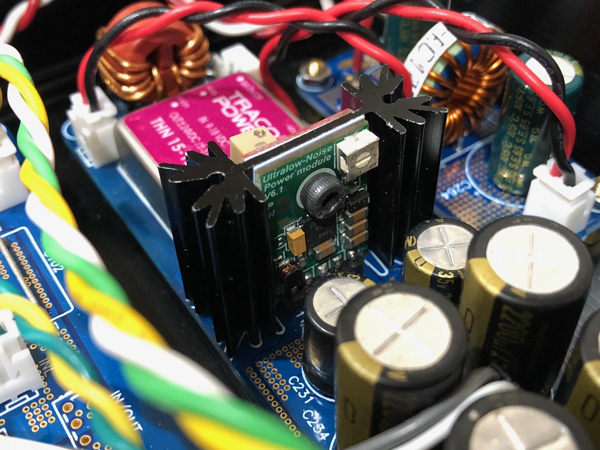

3. Don't use LM7818 and LM7918 voltage regulators as they have no ability to adjust the final voltage after the cap multiplier. Due to the different Vgs across the Pch and Nch MOSFETs for the cap Mx's, you will have different rail values. To get started, it's ok to use, but I recommend the eBay LDO TP7A regulators which have a pot. The pot is very sensitive so it will take some fine fine nudges to get the circa 18v to 19v rails.
4. The Xfeed has an error in the wiring - it was my fault as I thought all we needed was a DPDT switch to implement a cross-bar - I forgot it takes two DPDTs. As it is, the Xfeed can never be completely turned off as there is a small residual crossfeed even in "defeat mode". There is also an error on the C162 and C172, they should be tied to the voltage divider middle point and the other end to GND (not the end of the divider). My recommendation would be to skip the Xfeed unless you feel like debugging it. I can post detailed schematics notes and photos on how to fix if you really want the Xfeed. There is also a silkscreen error, R171 and R172 need to be swapped. As you can see, the one part where I put the least effort into double checking has the most errors. Also, I would recommend using the optional film caps vs Np0 ceramics as it sounds better.
5. The Volume pot board for the HP option has an error. One pad for the smaller RK09 pot (right channel input) is not connected to anything. It needs a small wire jumper to the input trace 5 mm away.
6. There are a lot of on board PCB JST connectors. You are welcome to hardwire it with flying leads. Or use a connector only on one side to allow disconnections yet reduce number of connector crimp wire leads that need to be made.

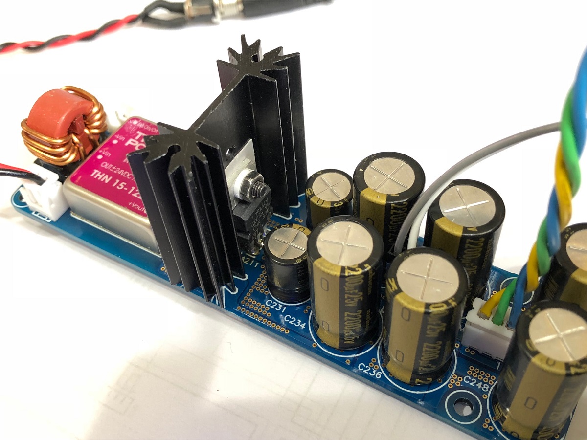

The PSU is where the building should begin. Note that the positive voltage regulator board should be facing the Traco DC-DC converter. I had to swap that out after a mistake. The boards I received were color coded red for +ve and green for -ve.:
Note that I ended up using the shortest heatsink available in order to fit inside the case. The original one fitted below was too tall. With smaller ones the temperature was about 60C on the heatsink. This design could use a different layout with regulators hanging to the sides and underhung on board to allow external heatsinking to main bottom plate.
Revised PSU schematic here:
http://www.diyaudio.com/forums/atta...s-hpa-sub-ppm-thd-hpa-complete_001a_page2-pdf
