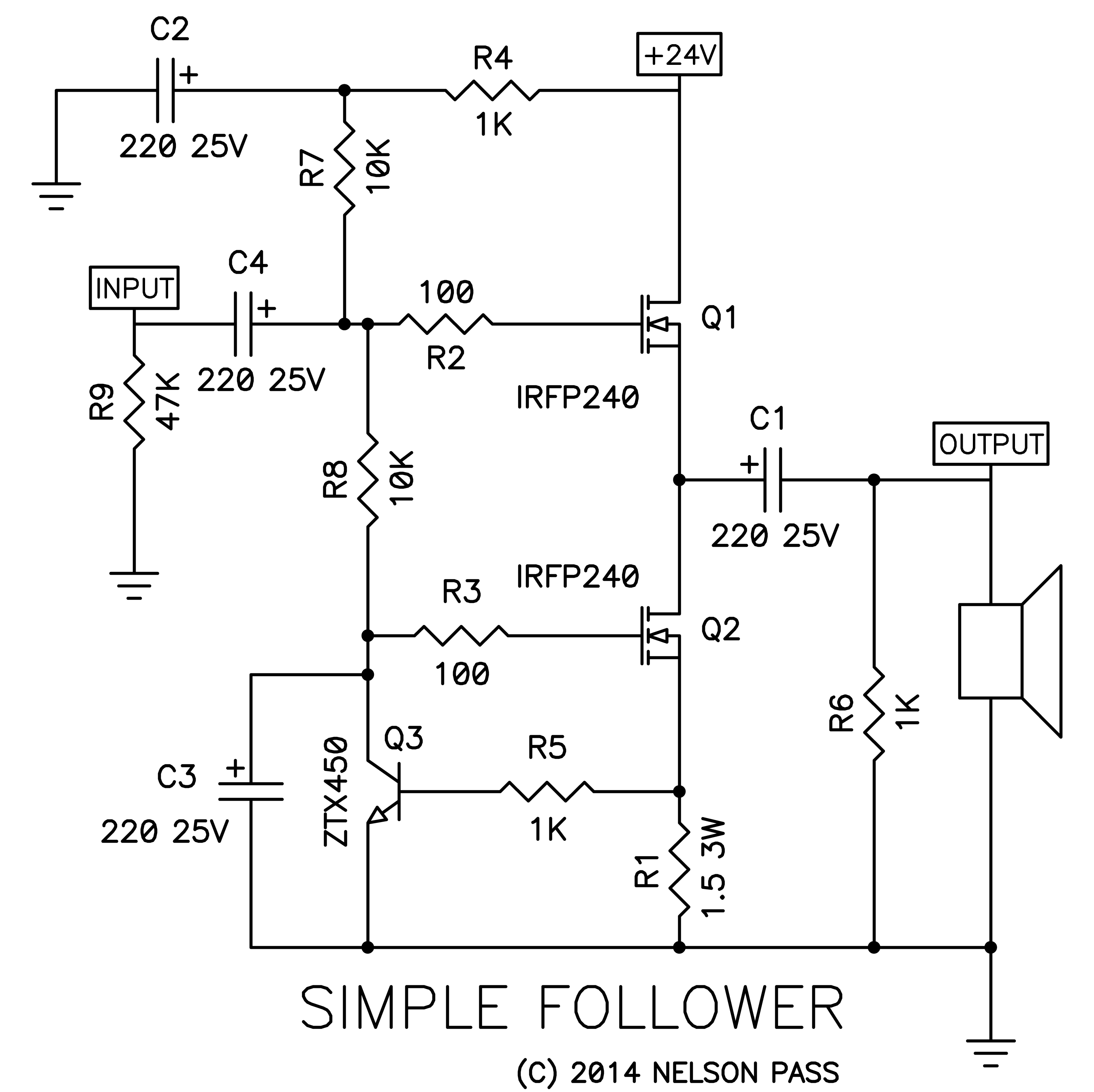

Most of the time the output of a CD will
be a couple of volts. But it's made to supply
this voltage a load that is in the 100's of ohms
or higher and only provide a few ma of current.
So typically we hook it to a power amp that provides
both voltage and current gain. But what we were
talking about here is a situation that we don't need
any voltage gain but do need current gain and that
is what this circuit does give us a lot of current gain.

this amp amplifys the current not the voltage , my load ( measured impedance ) is 10 ohms , so if my voltage is let say 2 v the current will be 200 ma and so my power 400 mw , if i want more wattage i have to increase my voltage , i that case i do need a preamp .

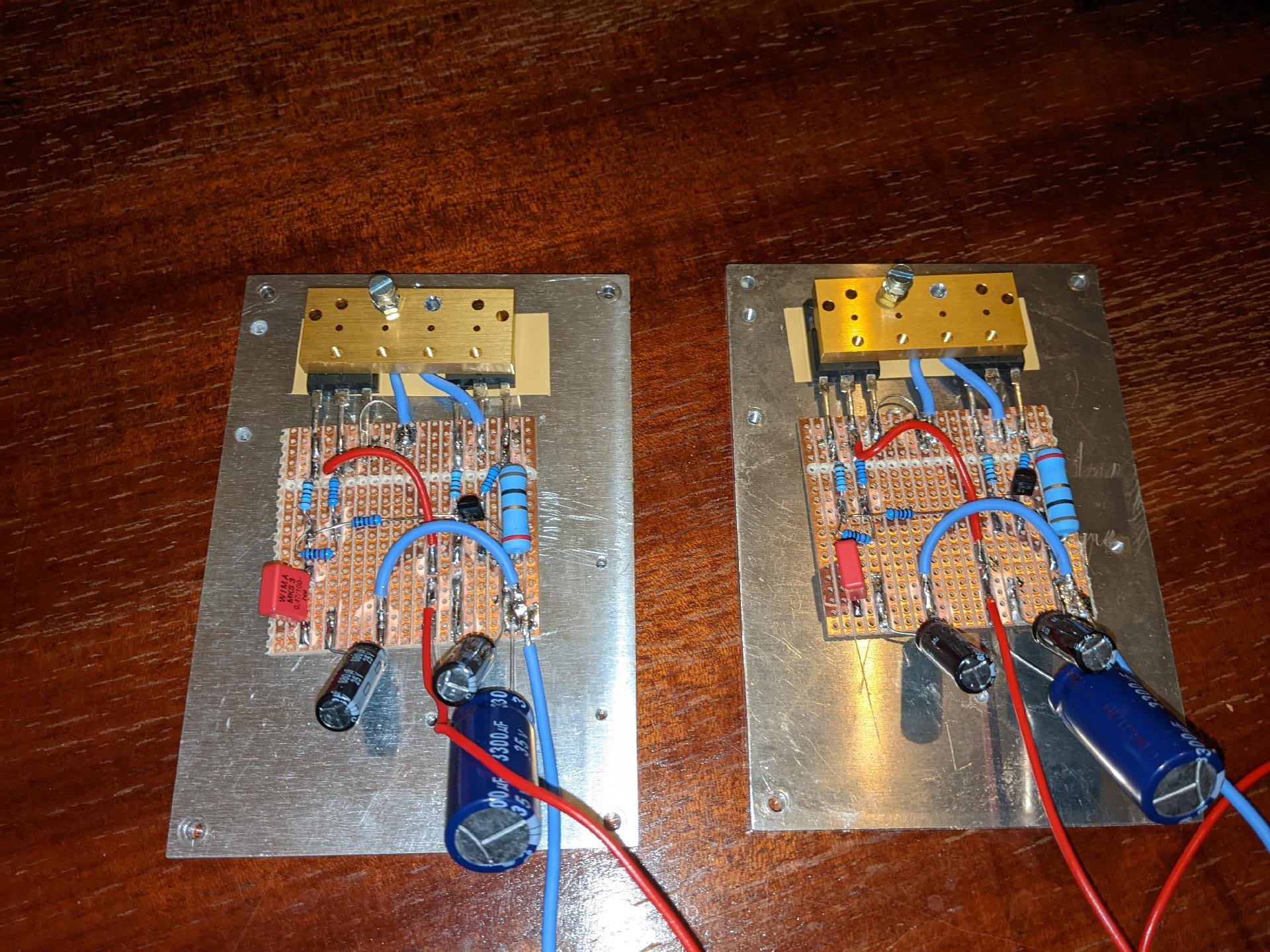

Cobbled this up on perfboard and it works just fine.

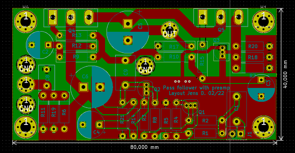

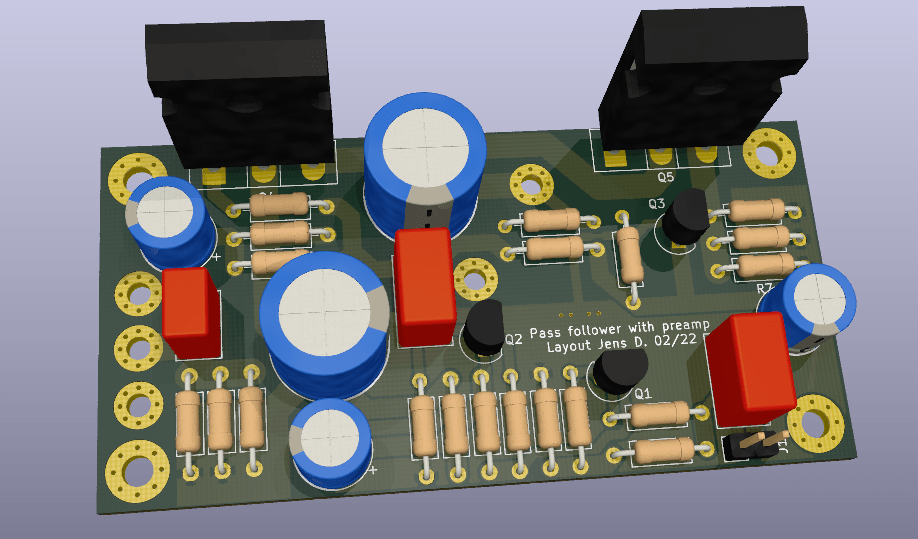

Made a little layout for it with an optional little preamp and thought some might be interested.

Cool looking project! Thanks for sharing. I see you split the plane on the back to separate the pre from the power section. May I ask what the second ground pad is for (on the edge of the board)? What input jfets are you using? Are you paralleling the resistors just so you can use smaller ones to get a higher power rating?
Not picking on things, just want to point out there is no thermal relief on R6 if that was intentional or not. (Is it intentional?)
Not a PCB expert but I always try to direct dirty and clean grounds separately.
Those two polygons on the top are just little cooling planes for the paralleled 0.6W resistors.
(they don´t get particularly hot though anyway)
I would use 2SK117GR as I have some.
Yes, see above, I parallel smaller resistors instead of one power resistor.
Saw the thermal relief and other little things that I cleaned up already, thank you!
