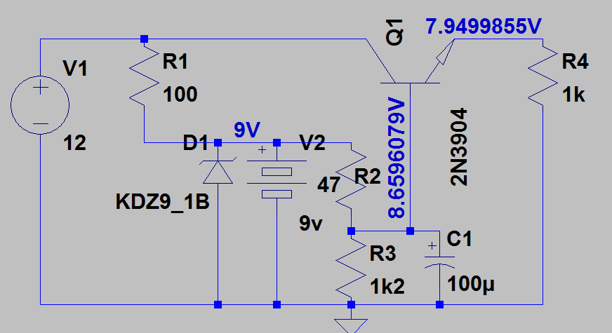

Perhaps something like this would work...but 100nf capacitor paralleled to a zenner will kill most of the noise which makes this circuit silly. You only need to use a discharged battery at first so that you won't kill a lower power zenner diode .
8v2 zenner wouldn't be good to use with a 9v battery because the battery will steal all the current from the transistor base trying to charge . The resistor value need to be adjusted with the real battery , just made a quick drawing...
Whats the purpose of the Zener? Wouldn't the battery set the voltage on it's own? The voltage will of course depend on the battery type.Perhaps something like this would work...but 100nf capacitor paralleled to a zenner will kill most of the noise which makes this circuit silly. You only need to use a discharged battery at first so that you won't kill a lower power zenner diode .8v2 zenner wouldn't be good to use with a 9v battery because the battery will steal all the current from the transistor base trying to charge . The resistor value need to be adjusted with the real battery , just made a quick drawing...

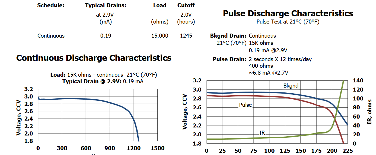

I would have thought a CR2032 lithium button cell would be quite a good reference, shelf life is 10 years, and you can readily get pcb mounting and panel mounting holders for them.
Note that the internal impedance is quite large for small cells, so don't draw much current.

The requirment was for an 8v regulated source. The battery is rechargeable...and the 9v1 zenner doesn't allow it to fully charge so the battery's lifespan will be protected...of course a 10v precision reference is welcome...Whats the purpose of the Zener? Wouldn't the battery set the voltage on it's own? The voltage will of course depend on the battery type.

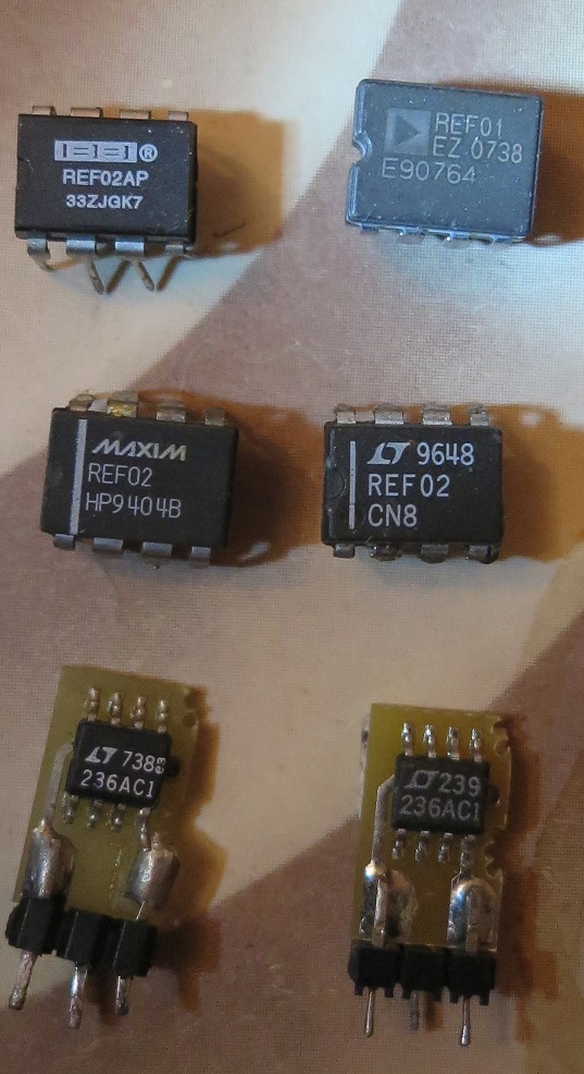

https://datasheets.maximintegrated.com/en/ds/REF01-REF02.pdf
http://www.ti.com/lit/ds/symlink/ref102.pdf
https://www.analog.com/media/en/technical-documentation/data-sheets/lt1236.pdf
https://www.analog.com/media/en/technical-documentation/data-sheets/1021fc.pdf

But basically what you have is an emitter follower, 'following' the zener voltage. Emitter follower have lowish output impedance, but not very low. So the varying load current that the DAC draws will cause ripple at the emitter output, and thus on the supply rail.
From a well regulated power supply point of view, it is not very good. Replacing the zener with a battery does not negate the weak point of the emitter follower. Any improvement has to come from a regulation loop.

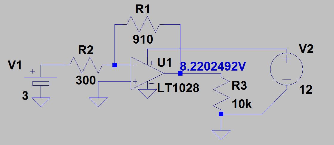

add an op-amp with a gain of 3x to a 3v battery...R2 can be part of the equation if added to the internal resistance of the cell and readjusted R1.The internal impedance looks like in between 110ohms and 50 ohms...and that can be substracted from the input resistor R2 .Usually you have a precision voltage referencing a high impedance input unity buffer cause you don't want that battery to last 1 hourI would have thought a CR2032 lithium button cell would be quite a good reference, shelf life is 10 years, and you can readily get pcb mounting and panel mounting holders for them.

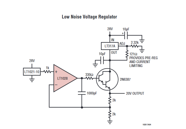

https://www.analog.com/media/en/technical-documentation/data-sheets/1028fd.pdf
