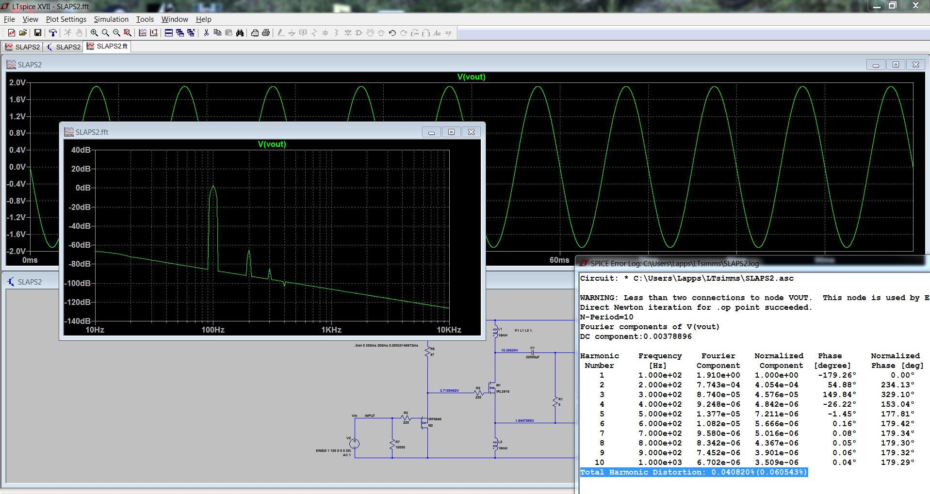

How does the feedforward errorcorrection come in to play? T.
Through the bifilar coil. It will mirror whatever happens on one side of the Mosfet and phase-invert it to the other side of the Mosfet, effectively canceling lots of distortion. This is the simplest way of building a Feed Forward Error Correction amp I can think of. And it works wonders for the sound quality. A rare combination of a high level of objective measured performance and perceived subjective sound quality due to low amounts of NFB and a simple design with few parts.
Each winding has 1,4 ohm DCR and I am running 1,9 ampere through them in my new build.

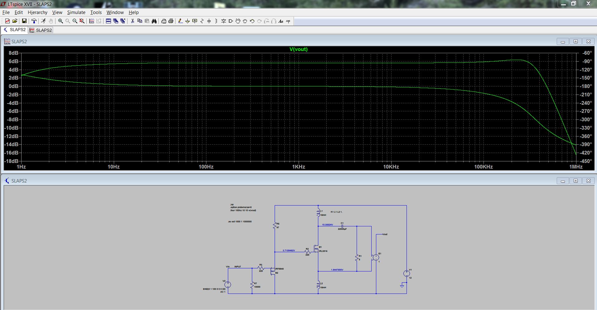

The output impedance is low and seems consistent through a wide bandwidth.
The Feed Forward Error Correction/Nelson Pass SUSY-ish function is quite powerful and lowers distortion and output impedance substantially.
